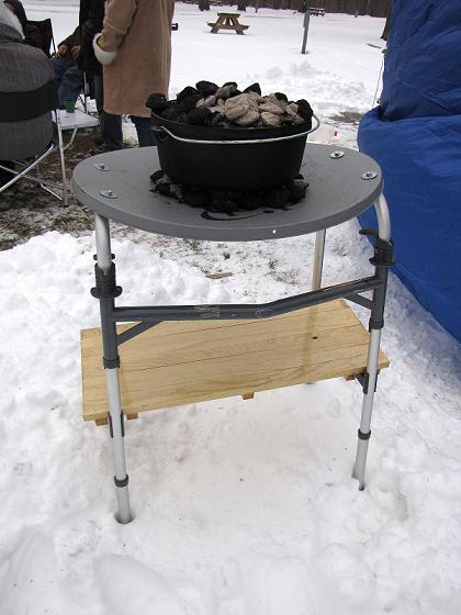

Being too old and too fat to spend the day squatting over a dutch oven I still like my satellite table. Knocks down in 30 seconds and takes up very little room.
Here is the thread link...
http://www.tnttt.com/viewtopic.php?f=2&t=40883&hilit=WALKER&start=15
P.S. there is also a table top version in this thread somewhere !

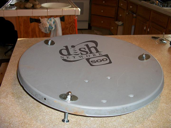

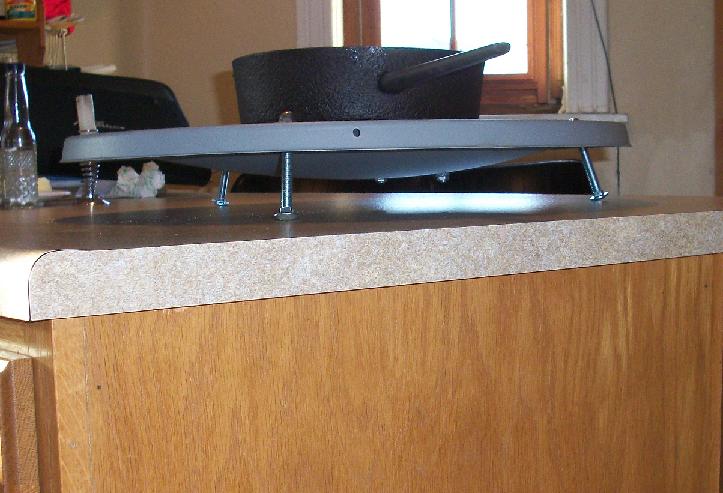

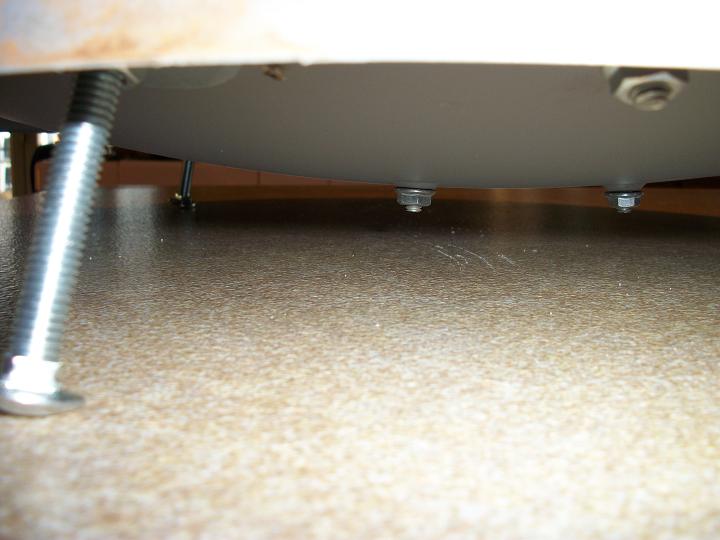

Here it is !
The round 500 series satellite dishs would not fit the walkers I had purchased so I decided to try another avenue with them.
installed 3 legs 120 degrees apart using $2.79 worth of carriage bolts nuts and 2" fender washers.
Table is very stout and stable ( I was a bit surprised by the strength)
The carriage bolts were 3/8 diameter by 3 1/2" long
There is about an 1 1/2" clearance under the dish which should prevent any damage to a site picnic table.
