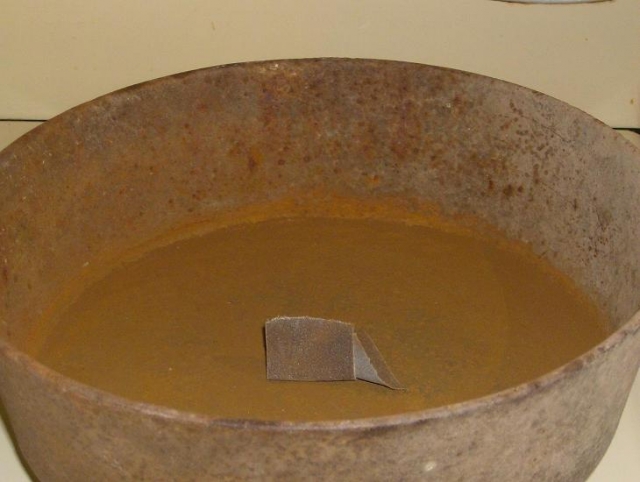

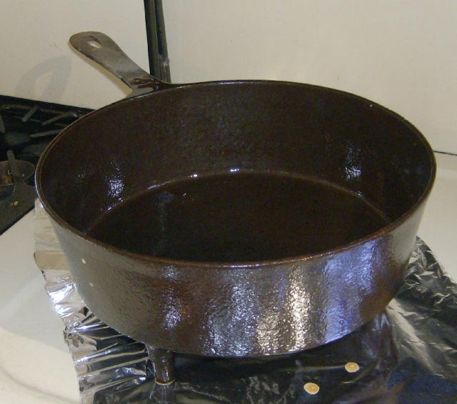

I have a good friend who works for Nucor steel. He has proclamed many times they just can't keep the contaminates out of the scrap that is coming down stream in the reclaimed scrap steel and iron. It requires multiple firings to float off the undesirable materials. I would imagine the other foundrys are having similar problems.
I would suggest you try and season the piece with 100% bees wax. I have had excellent results with this method. All that is needed is to heat the piece very hot on the home stove and melt enough wax to coat it. I simply use a large wad of paper towel and coat inside and out.
I took this
To this
in 2 coats
the second time I used it ,I fried 2 eggs in it just to see if I could. They skated around the pan without a care.
