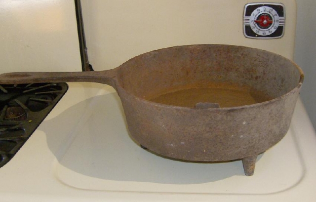

I decided to try it and am just as pleased as could be. I have reclaimed 5 or 6 rather badly treated piece of cast iron in the last couple of months and have become a convert also. When Gerry first mentioned it at a gathering I thought it just a bit strange, but decided to gave it a try. It is 10 times easier than multiple coatings and smoking up the kitchen to reclaim old iron. I especially like watching my fried eggs skating around in my new/old skillets.
Thanks again Gerry :thumbsup:
About 1/2 hour wet and dry sanding , a quick wash and burner dry, I let it get hot ,hot ,hot ,and applied 2 quick coats of wax taking about 8 minutes.
One note put down some foil or newspaper I dumped some of the liquid wax and had a hell of a time getting it off the floor and counter tile.
