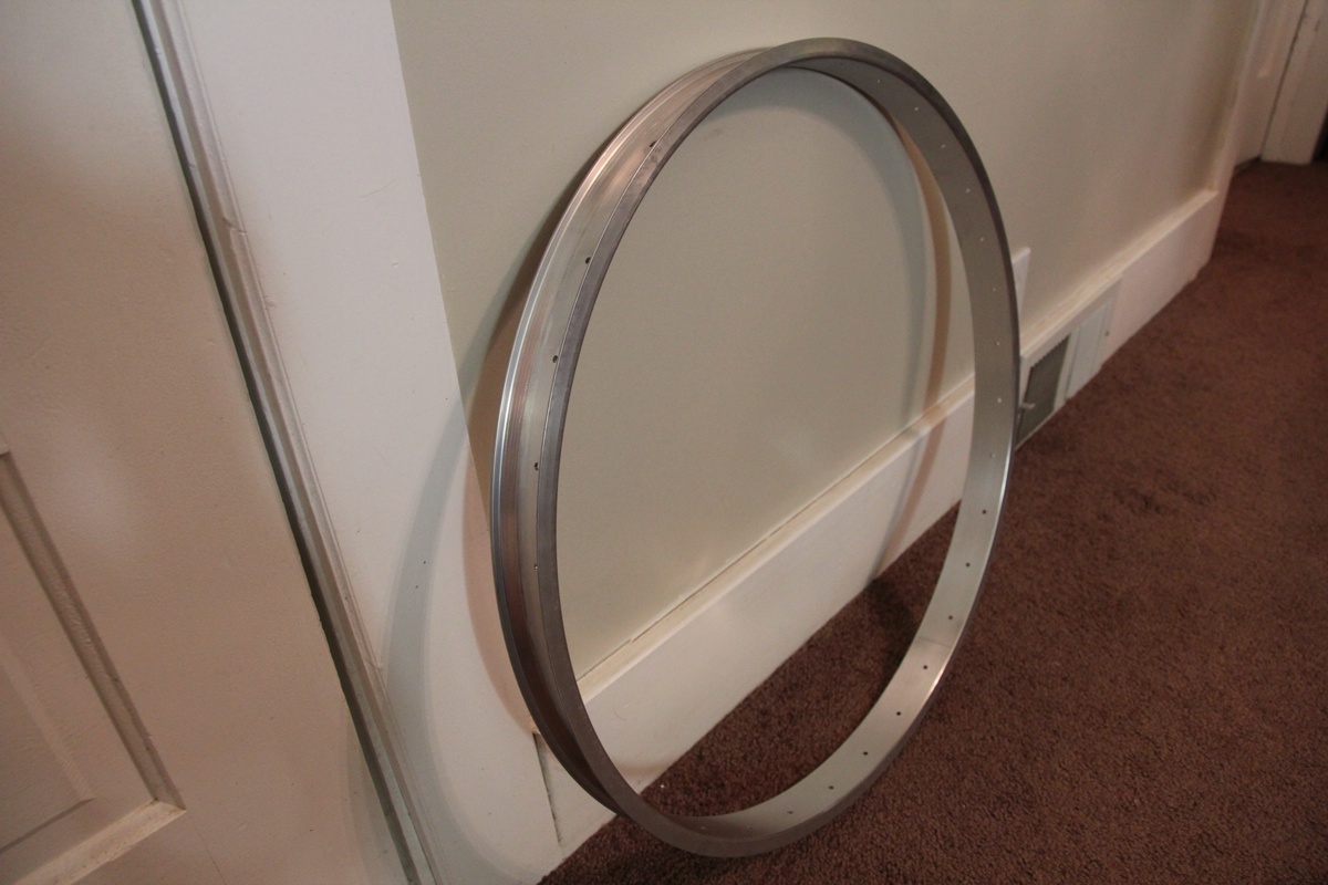

My snowcat rims came in today... They are really heavy. Exactly 2# each.
Glenn, how much do those wheels on the pugsley weigh?
Anyways, here's the pic.

Postby planovet » Tue Dec 13, 2011 6:58 pm
Nope, I don't see the advantage

Postby Fenlason » Tue Dec 13, 2011 7:56 pm
depending on which rim.. 690- 1220 grams

Postby mikeschn » Tue Dec 13, 2011 8:00 pm
Fenlason wrote:depending on which rim.. 690- 1220 grams
And that's for the complete wheel, right?
My rims alone are 900 grams.
But I'm not looking for a speed demon. I'm looking to play in the snow. So these should be fun!!!

Postby Fenlason » Tue Dec 13, 2011 8:05 pm
I've got some polypro on the Christmas list, so hopefully that keeps the humidity down.
Next project is the outer shell.
oops sorry no that is the bare rim weight.. I don't have the wheel weights.. there are a lot of variables there.
Surly has many rims available now also.. hmm 3 versions of the large marge.. different versions of the rolling Daryl as well as the clown shoe.

Postby Fenlason » Tue Dec 13, 2011 8:08 pm
the snowcat rims used to be considerably lighter than fat bike rims... but they have made lighter fat bike rims in the last couple of years.. but you are talking about rim widths of 65mm up through to 100... vs your at 44.
