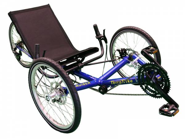

Very Nice! I like it. With it being tall like that you don't have to worry about the people in cars seeing you when they drive up next to you like I do on this. I am well below there door handles .
