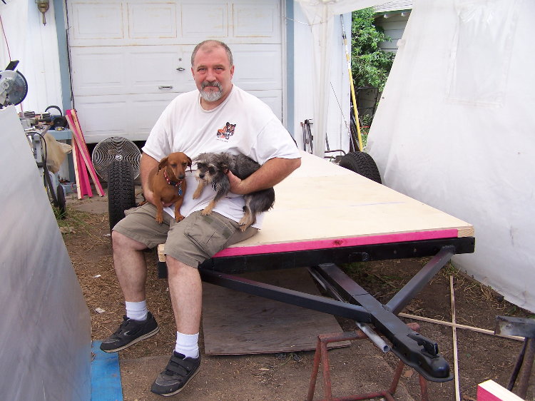

Image ok I hope I did it this time. Peg :applause: :applause: :applause: Yes Yes I did it. Great. I'm happy. Thanks guys and girls. :thumbsup: :thumbsup: These are my dogs and husband.

Postby Miriam C. » Sat Mar 31, 2007 8:13 pm
You go girl. It is amazing how much non building learning that goes on here. 8) ;)
Beautiful puppies. :thumbsup:

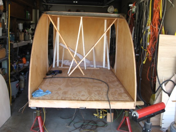

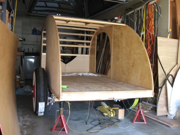

Here's a couple of pics hot off the press. Plan to post in a regular thread on the build in near future, but you ladies get the first preview. :lol:
In the phyical parts of the build I play helper to my husband.
Actually starting to look like something. I prefinished the walls and ceiling before we put them up, much easier that way. Stained the birch with Golden Pecan and finished with Minwax Polycrylic as didn't want stain any darker.
Martha :)

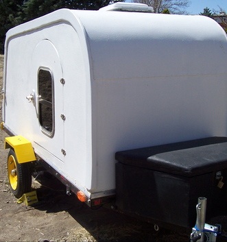

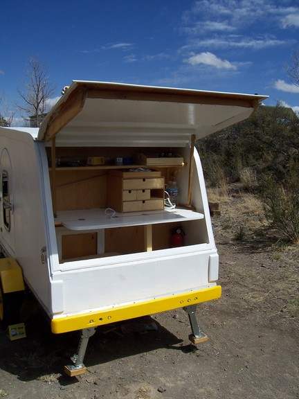

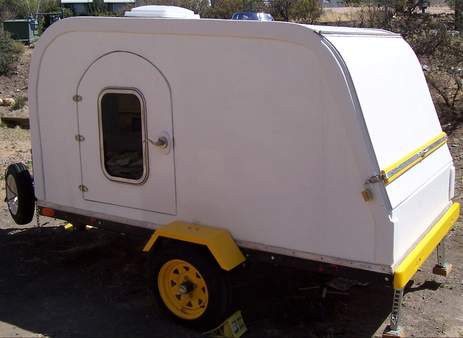

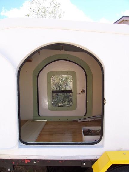

Here are the pics of the Daisy I promised:
This shows the inside door seal and trim. I painted the walls and trim. The floor and shelves I kept the wood showing:
This is my galley with the Ikea drawers and fold down counter. The height of the counter and the open hatch were measured for my height 5'6". I still need to work on the fenders and back bumper and are not attached, they are just sitting there for the pic. I am going to put some black rubber corner molding on the lower edge bumpers. I figure I need all the protection I can get because I will be manuevering the Daisy by myself in the campgrounds(':o') You can also see the doggy door framed by a picture frame in the lower left galley. This is a pass thru between cabin and galley.:
This is the Daisy's profile and shows how I latch the hatch with pull latches on each side. I used RotDoc's Uniflex 255 on top of CPES. This leaves a tough exterior shell on the ply, however it is very difficult to apply. The finish is very rough and uneven. I am disappointed with the result. I will just tell everyone that I wanted it look this way(':)'):
I bought my huge tongue box online. Only weighs 12lb+. I bought it before MaryK built hers. My next tongue box will be similar to hers:

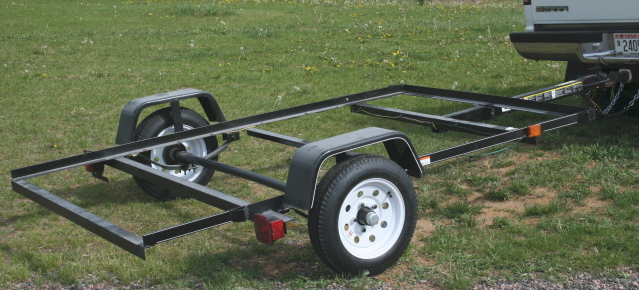

I'm a lady teardropper doing my first build. My husband just shuttered when I made the statement that I was going to build a TD. Our son who is a freshman in high school took a welding class and has been welding up a storm since. He is in the process of building a Mini-chopper. Our daughter who is 10 is interested in the TD process. I cut out a 1/2th size cardstock profile of the TD in my head so everyone in the family knows generally what it's going to look like.
I'm building a 5 x 10 on a 5 x 8 trailer. The floor space is 5 x 9. Got the trailer and the wood. But from the many suggestions from my father, friends, and father-in-law, they think I should be building the floor with treated lumber. I'm not sure what to do to. I think I will go with that suggestion and go to town tomorrow morning and purchase the treated and take back the regular.
