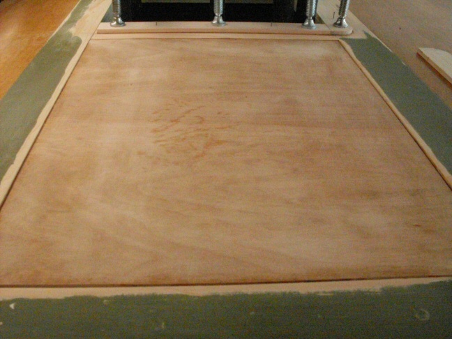

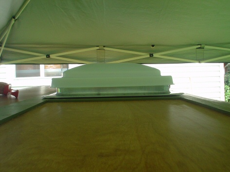

I used trim to hide all joints and created a design flaw around the roof vent on my original build. My roof never leaked but it bothered me that I could be sitting somewhere in the pouring rain and that the areas on both sides of the vent would form pools of water.

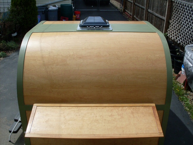

I waited until it warmed up here enough in Cleveland to start a roof fix it. I cut out two pieces of scrap birch from the original build and glued them in place on both sides of the vent. I cut out the shape of the vent and raised that area 1/4". I then used epxoy with filler for the gaps. Put on 3 coats of epoxy. then primed and finally painted that area.
Just have to install the vent and seal. Switched from a white vent to a smoked. Looks cool.
Before while building:
The fix:
It was an easy fix............

However is it possible for future builders to add another panel across the top as you did but not patch it. Highest point would be higher but with one piece instead of piecing it as you had to. That is what I am considering now that I see your problem resolved.
Thanks for your idea and fix so when I ever decide to do one I will avoid this by your idea.

Postby b.bodemer » Sun Jun 14, 2009 9:01 am
Russ,
Yes.... there are a lot of ways to finish off roofs, especially around the vent area.
I can't tell you how many ideas I got from this forum before, during and after my td build.
Barb
