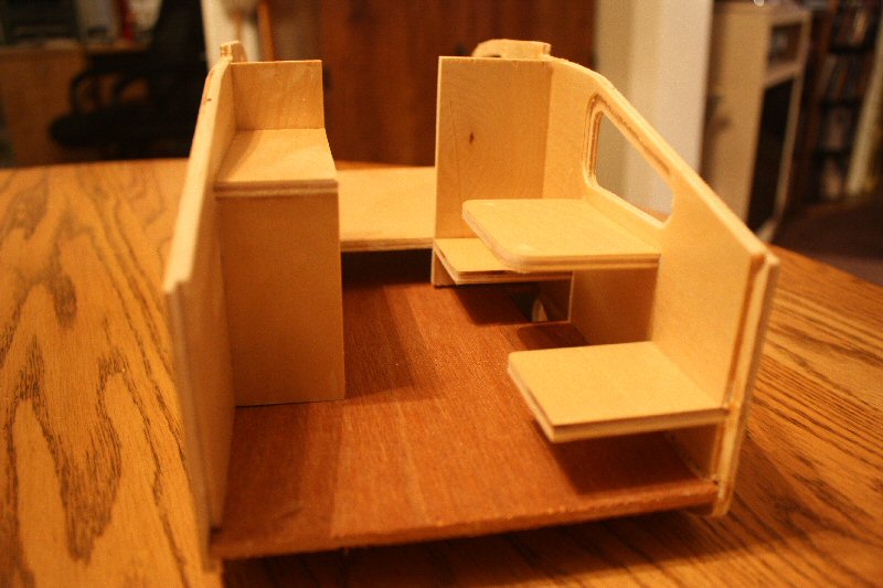

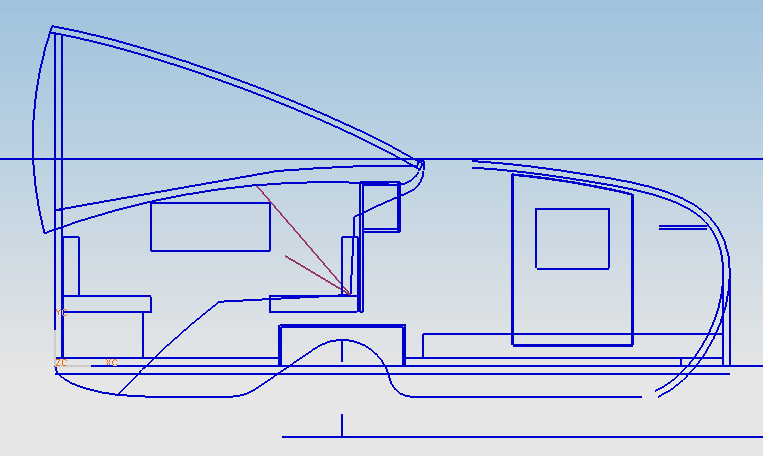

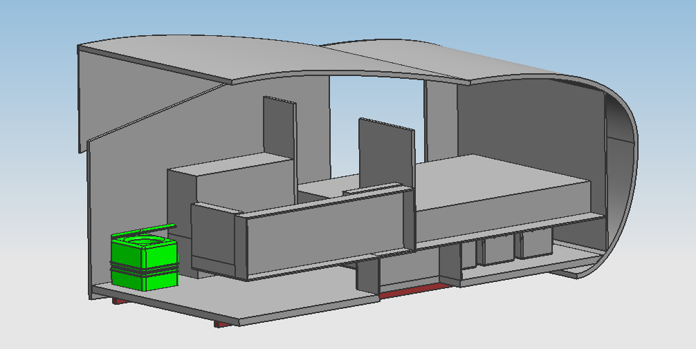

Postby mikeschn » Sun Apr 17, 2016 6:35 pm
Yea, I gave it some more thought...
A tiny house requires a kitchen, a bathroom and a bed, and a dining room table...
Since building up on such a narrow trailer is not safe, the only option is to build lengthwise.
And the best I could do is this design...
And yes, I know, it doesn't look anything like a small house...
Now I just have to figure out if modifying this into a small house adds any benefit...
P.S. And if I want to add a shower, all bets are off. Back to the drawing board...!
P.P.s. This is the smallest one I could find...

Postby Socal Tom » Sun Apr 17, 2016 7:21 pm
I think anything "house-like" would end up in the 1000's of pounds. The "tiny houses" on wheels are travel trailers with heavier stuff in them, like porcelain toilets, and tile floors. I think a light one would be 10K lbs.

Postby Ned B » Thu May 12, 2016 2:55 pm
mikeschn wrote:Yea, I gave it some more thought...
MIke,
in and of themselves TIny Houses are a good thing, but as Bob has shared with us, most communities are not willing to embrace the 'less is more' concept. I think what you shared here is about the 'smallest' you can put on a HF trailer, true, it has 'the basics' including a porta pottie. Once you build one, you still have to have a spot to Use it. Solve That problem and design then becomes the easy part.

Postby Mark959 » Mon Jul 04, 2016 7:18 pm
porta toilet could be sitting inside a shower pan, less stink in the house if its vented too. Then you get the shower and the toilet in the same location, and only need gray water tank.

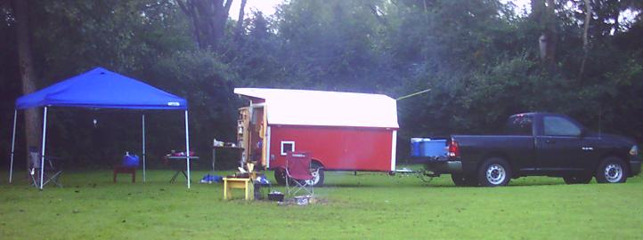

A few of my builds:
SEE MORE AT: boondockcampers.com
