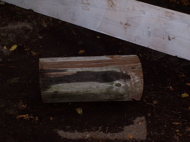

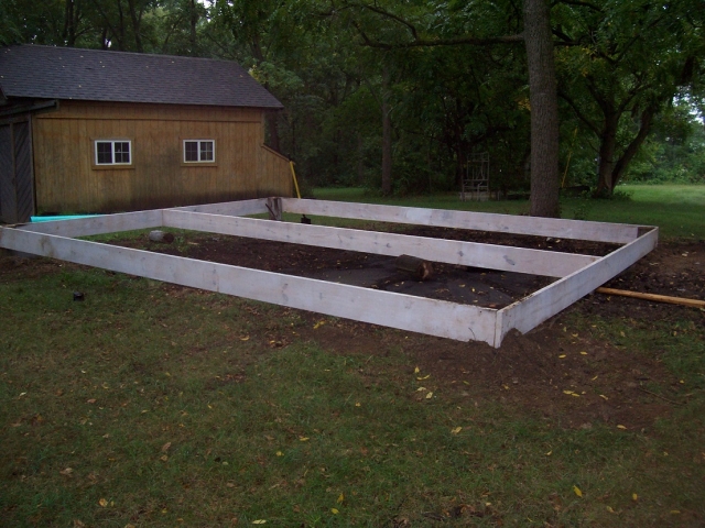

The neighbors had an old electric pole replaced and I asked if I could salvage it ?
We cut it into six 5 foot pieces. Here is a small chunk left over....Image

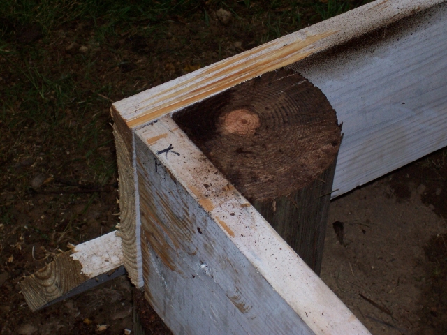

The 5 foot chunks were sunk 3+ feet and cemented in with 2 bags of concrete and aggregate and then notched and trimmed. The notches left a shoulder for the 2x10 ribbon boards....Image

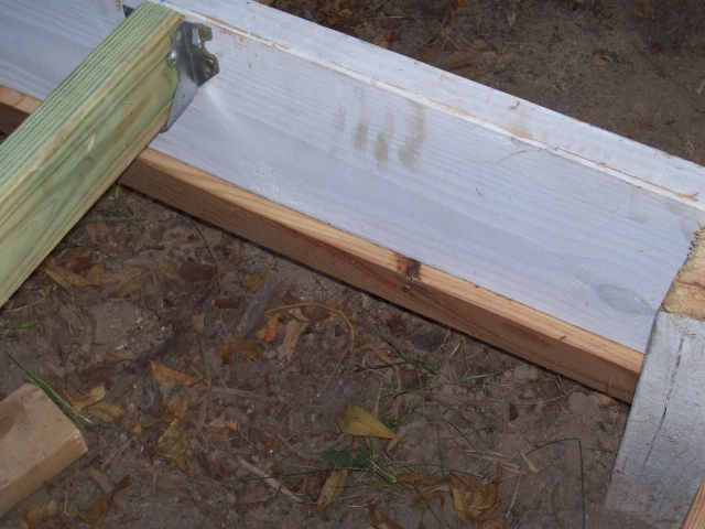

After 5 hours of moving holes and measuring and re-measuring here is the end results. In this picture it is hard to tell but there is about 25 feet between the tractor barn and the new shed.... Image
We are 3/8 th of an inch off of square on the new 16 x 20 building. I called it a small miracle.
There are intermediate legs still to be added and I need to trench in a power line from the tractor barn but for 5 hours of work I am more than happy with the results.

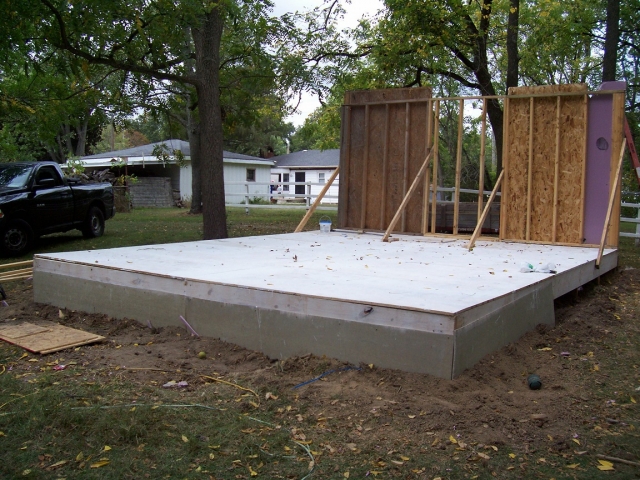

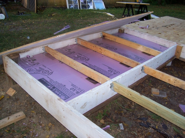

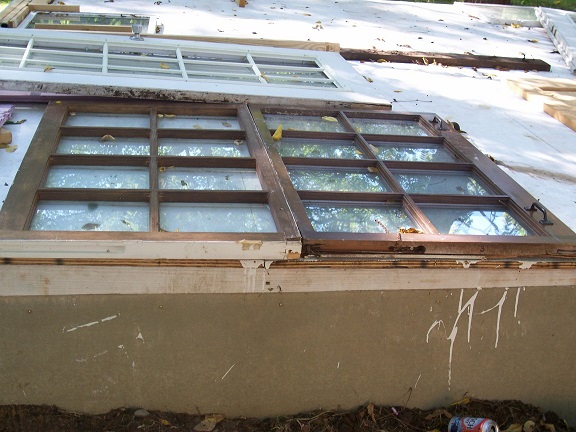

Postby bobhenry » Tue Sep 24, 2019 5:49 am
Well finally got some pics......
Image ~~~ The empth grid
Image~~~ The 1x2 rim board to support the zip panel critter barrier

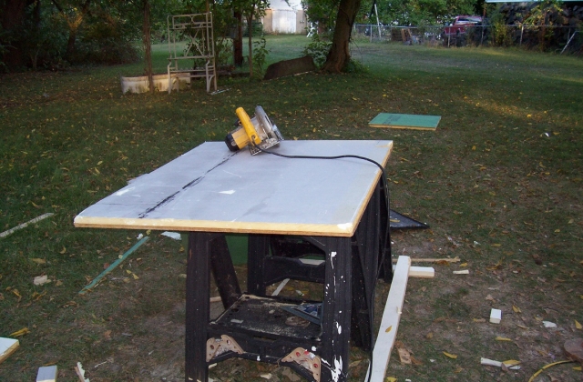

Image ~~~ zip panel being cut to place fiberglass face down as a critter barrier
Image ~~~ The first layer of foam ( filled it full )
Image ~~~ The floor finished and protected with polar seal and rimmed with cement board
Image My free windows being converted to hinged swing out cottage style windows. Oh the door behind is one of two double swing French doors (also free)

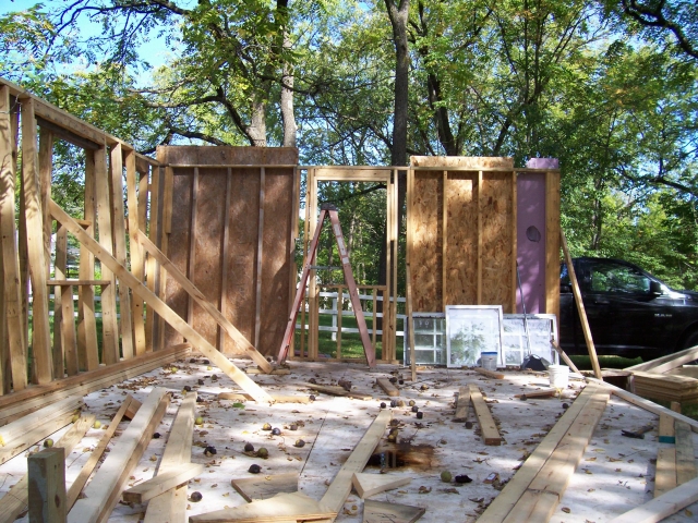

Postby bobhenry » Tue Sep 24, 2019 6:27 am
The walls were a miss-build at work and were a small part of a 3 truck load of free lumber. The cement board was given to me by a co worker to save him from hauling it all to the dump. The windows were out of a dumpster that we emptied twice and sold over $400.00 worth of them, saving a few for my project. The French doors were in the background of a craigslist post. I simply asked about them and was actually asked to PLEASE come get them. The foam was once again diverted to me instead of being tossed in the dumpster at work. So far the landlady has spent less than $500.00 on material mostly the 2x10's and the 3/4 plywood for the deck. The wall material is all on site as a large part of the miss build material. God I love free !!!!!

Postby bobhenry » Mon Sep 30, 2019 3:56 am
Well another successful weekend ! Two more walls are completed and stood, only one to go. Will spend my first week of full retirement building the 11 trusses using the 16 x 20 floor deck to jig up for their construction. Hope to have them completed and stockpiled and the final wall laid out with the parts all cut and ready for the crew next weekend.

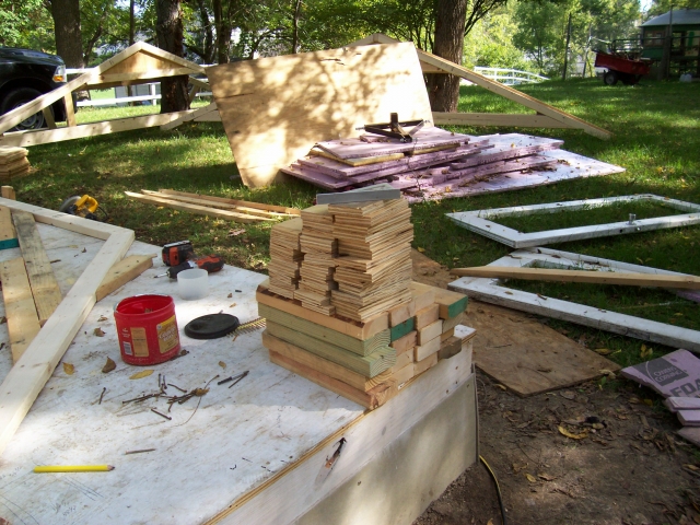

added..... here is a truss on the floor jig being finished up.... Image
And a stack of gusset parts waiting for the next victim .....Image
You can see portions of a few finished trusses in the background :D

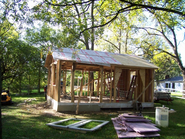

Postby bobhenry » Sat Oct 12, 2019 5:53 pm

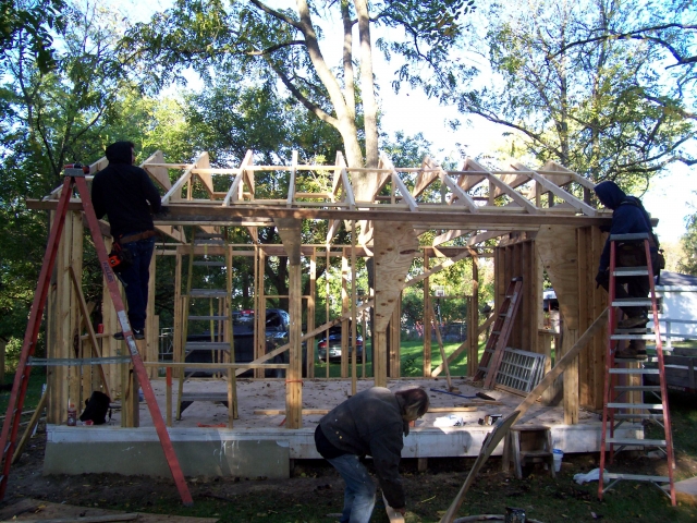

We had a crew today ! Us ol farts (above) and a couple of 20 something young guys. With this combo we set all 11 of the home built trusses in about 3 hours. After we called the build for the day I went shopping and purchased 13 sheets of roof decking to be installed Sunday. Frank and I are taking turns with the icy hot as we both hurt. My knees and his hip. Smells like a nursing home around here tonight but we will be up and swinging again in the morning. It is looking more and more like a shop every day.

Postby bobhenry » Sun Oct 13, 2019 10:08 pm
Trusses on Sat as reported and the roof deck is on and under paper ready for shingles by Sunday night !
:P
It's so nice to set under roof and listen to the sounds of fall.... This walnut fell THUD ! .... and that walnut fell THUMP! Yep defiantly fall here in Indiana. I was the only one that was actually hit by a falling nut but a bunch of close calls while working as the winds helped the walnut tree to shed their huge walnuts.

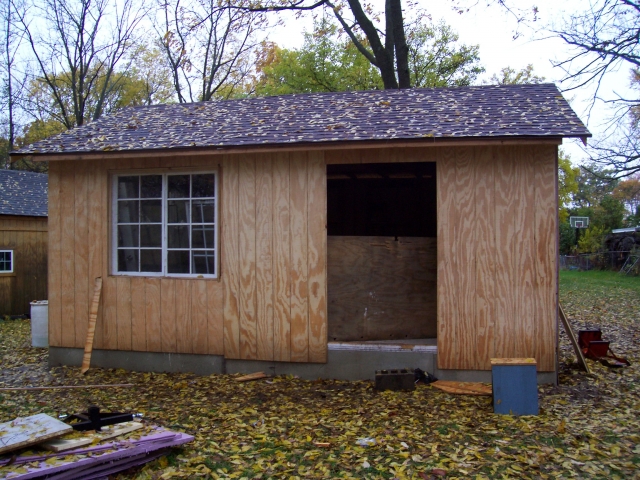

Postby bobhenry » Fri Oct 18, 2019 6:14 am
Have electric trenched in , fed from the 100 amp service in the tractor barn. Have installed 4 quad boxes so far with more wiring to come. I wanted some juice with out the extension cord hassle. My almost 70 year old body did not particularly like trenching 18" deep for 25+ feet to bury the underground rated cables. I ran a heavy 10 - 3 and a somewhat lighter 12 - 3 for the lighting, The feed is temporary and is essentially just an extension cord at this time. ( But at least it is one that doesn't require being rolled up at night ) :thumbsup:
Saturday - Sunday will be a big jump if all hands show up. The pups will install about 6 square of roofing while us ol' farts install the 18 plus sheets of T1-11 siding . This will get us weathered in :P
UPDATE: ( Sat night 10/19 ) As planned the roof is complete and all but 4 sheets of T1-11 have been installed. It is looking sweet !Image
