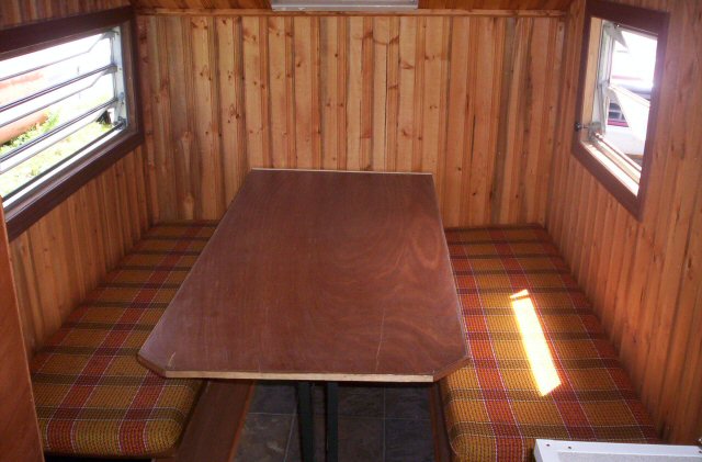

You might be after a wider version of john sheppard's winter warrior
dinette can stay up full time
beds on each side of the dinette
two bunk beds in the front, like the raindrop
http://cdn.blog.rvshare.com/wp-content/ ... jpg?de6dcd
and of course, built in foam
In the back, on one side can be the porta potty, and on the other side the galley, as in this design...

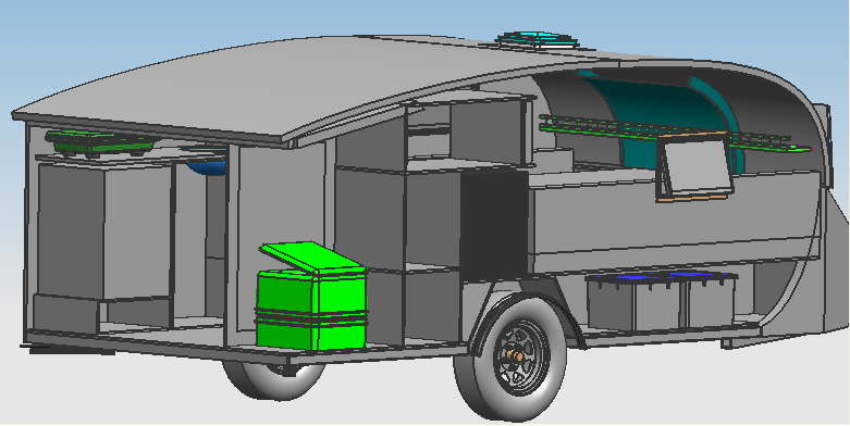

Postby OP827 » Mon Sep 05, 2016 10:46 am
As you are looking for permanent bed and dinnete/bunks, bathroom area, then the dimensions of the trailer footprint has to be wide and long enough to accomodate that. Let's do an estimation of such foam structure shell, it would be roughly 80" wide, 14'-6" long, 6'-6" high. I will use example of a FG sandwich panel weight (6ozFG+1.5"XPS+6ozFG) with several minimalistic stiffeners across would be roughly 60-70lbs. That comes to 0.62-0.72lbs of weight per sq.ft sandwich panel. Total weight of such sandwich panel box measured as 6.7'W x 14.5'L x 6.5'H comes to roughly 500lbs. Rest of windows, floor, furniture, trailer frame etc. would have to be remaining 500-700lbs. 10' long trailer frame with small 10" wheels is about 360lbs, IIRC. Can 1000-1200lbs of such size trailer be done, I think yes, but only if a different approach is taken to the build; like in airspace, no extra needed weight, anywhere. Typical trailers (at least in North America) are not built like that. If you search the web, you'll see what I mean. Some new big size camping trailers from Europe and Australia have only a lighter steel web longitudional members attached to a load bearing floor sandwich panel and jack stands are afixed directly to that floor panel, not the steel "frame". If trailer is made as an integral structure where all elements are included in structural work, the light weight gains can be made. Additional weight savings are from optimizing the form, like sloping the roof in areas where high walls are not required, building furniture from very light weight material, carry water in TV or not carry it at all, make lifting roof part smaller to only where standing space is needed, etc.
It is a challenging design to achieve 1200lbs to your above listed requirements, but I think it should be possible.
Is the below floorplan (from google search) somewhat close to your requirements?

Re: Help me design "The Impossible" LOL
Postby OP827 » Mon Sep 05, 2016 8:08 pm
This is the type of lighter frame I mentioned above. You can see that jacks would be fixed to the floor, not frame. This frame is more "evenly stressed" in every point along its length as they say in stress analysis.
BTW, the "Ultralight A-frame" in design library of this forum when combined with properly build structural floor makes sense too for such a lighter build. Sections of angles or C-section of course will have to be upsized properly to carry the trailer 1200lbs load.

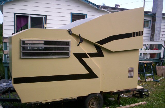

Postby BigGoofyGuy » Sun Sep 18, 2016 7:11 pm
Tomterrific wrote:How about a long A-frame with folding dormers on each end?
Perhaps something like this?
BigGoofyGuy
Posts: 464
Joined: Sat Sep 05, 2015 5:37 pm
Location: Newburyport Massachusetts United States of America
Postby bsekisser » Tue Oct 18, 2016 3:20 pm
Jealous! Now that's cool! Interior pics & details?
