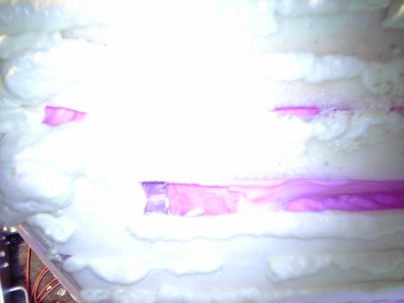

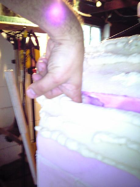

Well, i got a bit more building done this weekend.

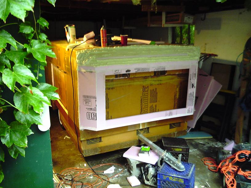

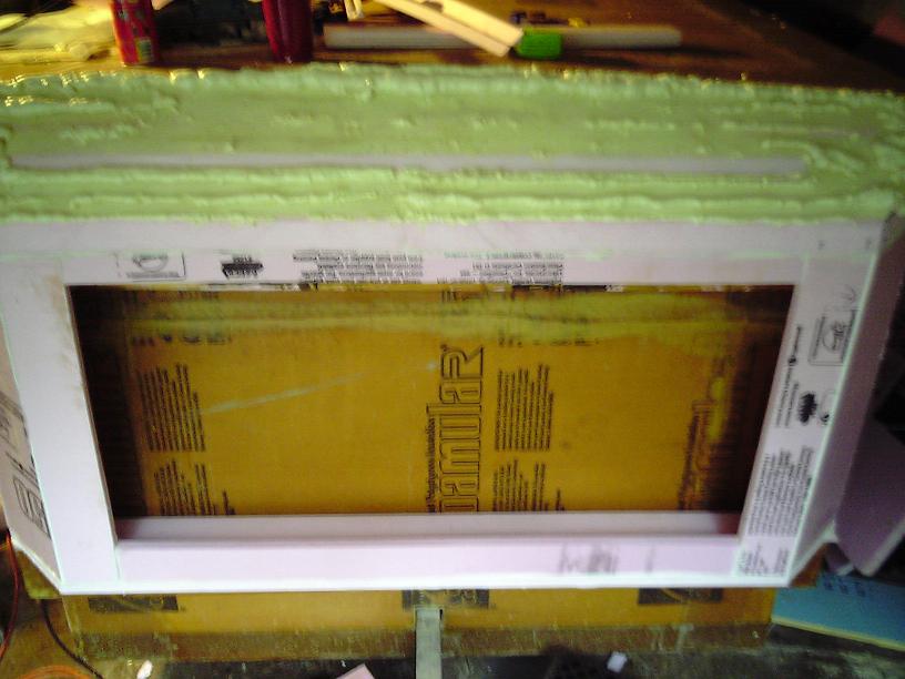

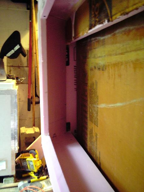

I shaved down and sanded the spray in foam that i put in place the other day. I noticed that some of the foam had collapsed slightly where i had cut and sanded it the day after spraying. I guess you have to wait a few days for the spray in stuff to cure really hard before it can handle the vibration that a belt sander throws off.

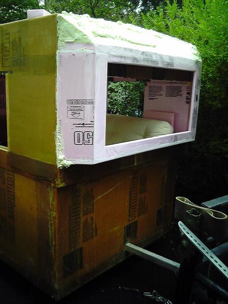

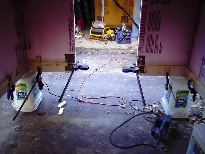

I cut more foam board and microed it in place. The foam portion of my front fairing is almost complete. It's just about time to fiberglass it.
That last pic shows how big the ledge at the head of the bed is going to be.
I sprayed a little more foam into the various gaps and cracks and put things away for the night.

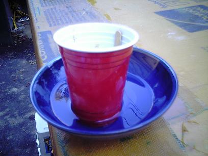

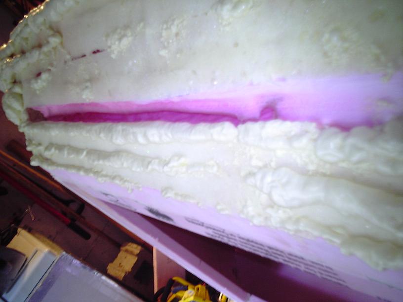

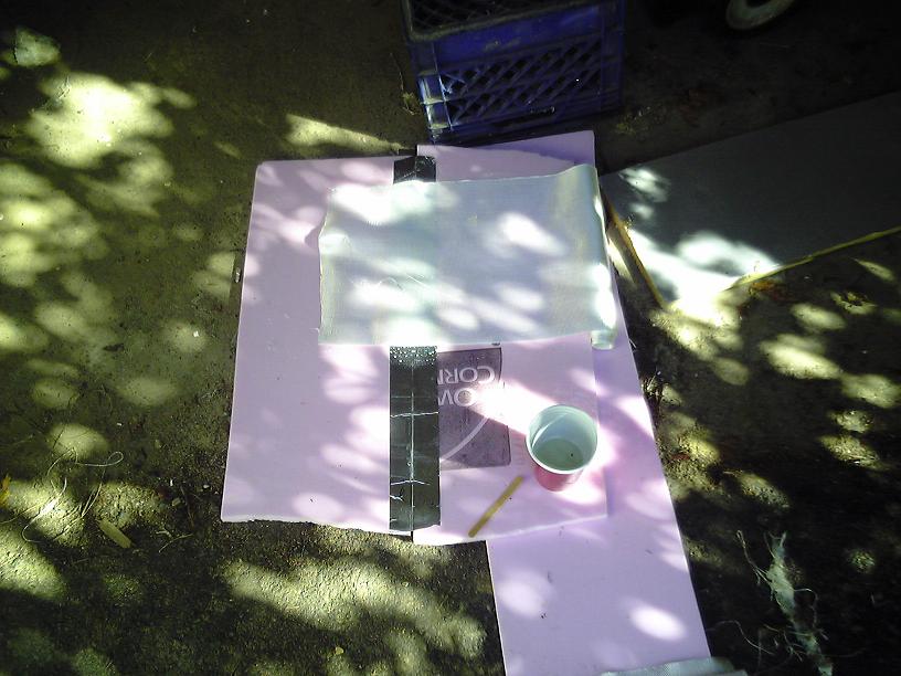

When i began work on sunday morning, I noticed cavities eaten into the pink foam.
I couldn't figure out why my foam board was dissolving. Did i get a can of defective spray foam? Did the fact that i was spraying the foam in the rain cause it to set too exothermally and melt things?
You may notice that there is a red plastic cup sitting on the roof of the camper in one of the pics. That cup contained about an inch of kerosene that i was soaking the used spray foam nozzle in. Usually you can only use a can of foam one time, and if you have any left, you end up just throwing it away because the foam hardens inside the nozzle and the neck of the can. The kerosene kept things from hardening and the next day I was able to use the rest of the foam in the can.
Red plastic cups are not kerosene proof. The kero ate through the cup in the middle of the night and poured out onto the camper. Pink foam is also not kerosene proof. It melts into a thick pink sludge when kerosene is dribbled onto it. The spray foam was kerosene proof so it kept the kero puddled on the fairing until it was able to eat it's way to the ground.
I cut and scooped all of the pink sludge out of the way, packed the largest holes with pink foam, and used the rest of the spray foam to glue it all together. tuesday, the foam should be hardened enough to cut, sand, and fill any small gaps with wood putty.
Hopefully the next day, the fiberglass goes on.

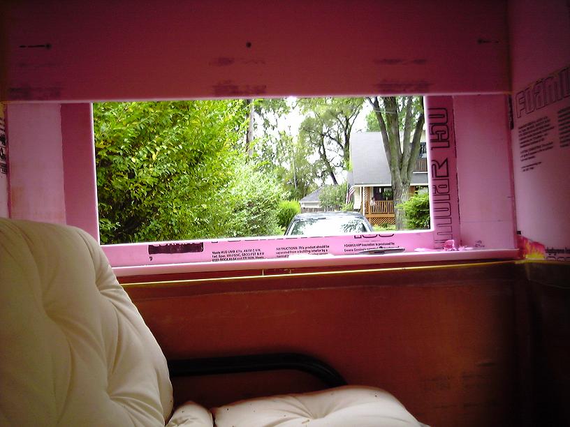

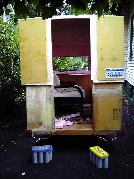

before starting work, i took a couple of pics of BUB in its "ready to camp" position.
the 2 batteries in the last pic are the group 31 Optimas i'm going to use to run the refrigerator and microwave. I have to toss them in the back every time i move BUB to get the tongue weight down to something that my back doesn't complain about.
This is what the view is like sitting on the futon and looking out what will be the front window.
After 2 beers worth of laying on the futon dreaming about BUB's first camp out, i was ready to begin work. A passing neighbor helped me remove the cap and flip it upside down in my driveway. He looked at me, then at BUB, then at the mess in the garage, then silently shook his head. No one in my neighborhood can wrap their heads around the concept of a travel trailer that weighs less than 10,000 LBS.

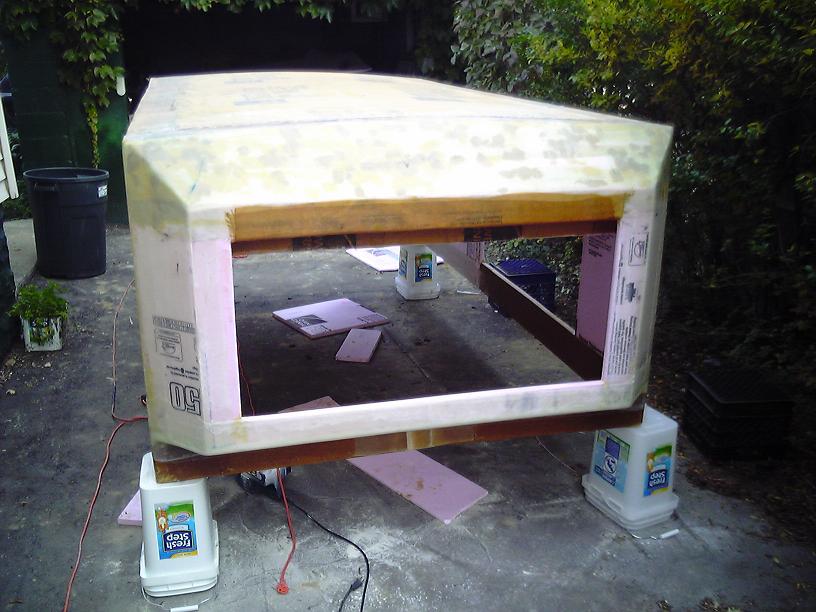

Without the base unit in the way, fiberglass application went pretty quick. Since there were no large expanses of foam to cover, i was able to use 12" wide fiberglass "tape" instead of cutting fiberglass off of the 5' wide roll. I was able to wet out the fiberglass on the ground before placing it on the camper and smoothing it out with a squeegee. This ends up being about 5 times as fast as trying to wet out fiberglass that is already in place on a vertical surface.
Here is one of the 12" wide 5' long rolls of tape about to be wet out.

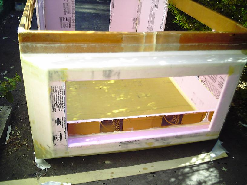

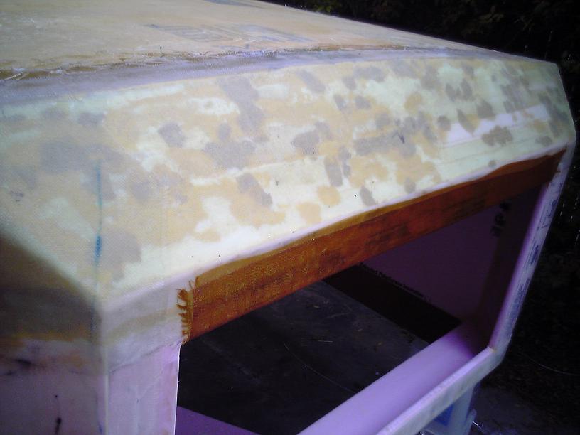

The front fairing is now completely covered in fiberglass and ready to handle freeway speeds.
The bottom edge of the cap has also been shortened, rounded, sanded, and covered with 2 layers of fiberglass tape.
The top edges of the side window frames, and the inside roof edges have also received 2 layers of fiberglass.

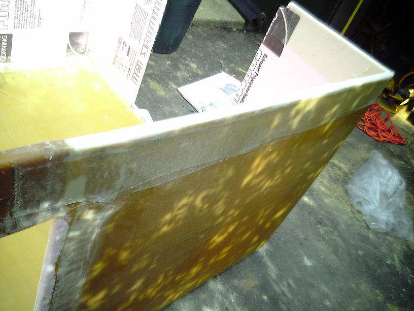

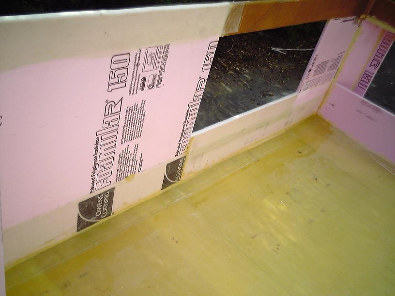

After work on monday, i had a mission; to put fiberglass on all of the foam that was needed for window mounting. The good news is: mission accomplished.
Here is the inside edge of the roof/wall junction. the fiberglass roof is now structurally connected to the top of the window frame.
Now that the top edge of the windows have been glassed, the cap gets flipped over and set on kitty litter buckets. You can now see my handiwork covering the top part of the fairing.
Here is a close up view of the fairing. You can see the distinct colors of the pink foam, spray in foam, and 2 different tubs of wood putty.
. Notice how smooth those corners are. If you are gentle and work slowly, the cloth can be stretched and curved around some pretty complex corners. I'm finally starting to really get the hang of this fiberglass stuff.
If you are paying close attention, you may notice that some of the fiberglass is clear/white, while other pieces are brown. This is just 2 different brands of epoxy (they were out of what i normally buy when i placed my epoxy order). I couldn't smell any fumes when i was applying the clear stuff. I figured that this must be a remnant of my recent head cold. When i started mixing the brown stuff up though, my head started to spin and solid objects began to wave at me. since they cost the same, in the future i'll be buying the stuff that doesn't get me instantly stoned.

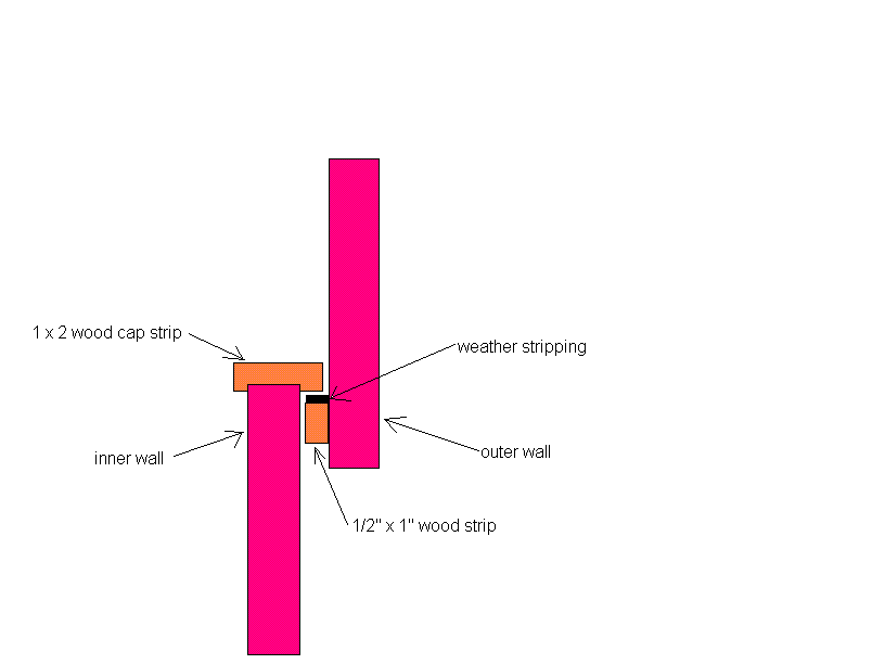

Very Cool!!!! How are you going to keep the hitch up in the water? One idea would be to make a removable pontoon that you could put on, would give you more support and stop it from waggling around.
Also, how are you going to seal the edge of the pop top when up? You probably don't have to worry about rain getting in, but those little buggies can find the smallest cracks.....
I'm going to fiberglass up a removable V shaped pontoon that should also make a more hydrodynamic bow.
My thoughts on that are:
The 1 x 2 wood cap strip is going to be held on with drywall screws, that way i can remove them and take the cap completely off for floating on the lake, down the river, whatever (convertible mode).

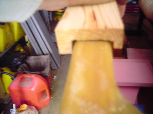

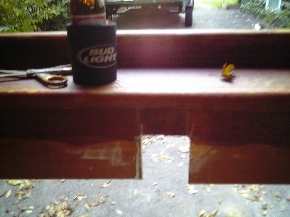

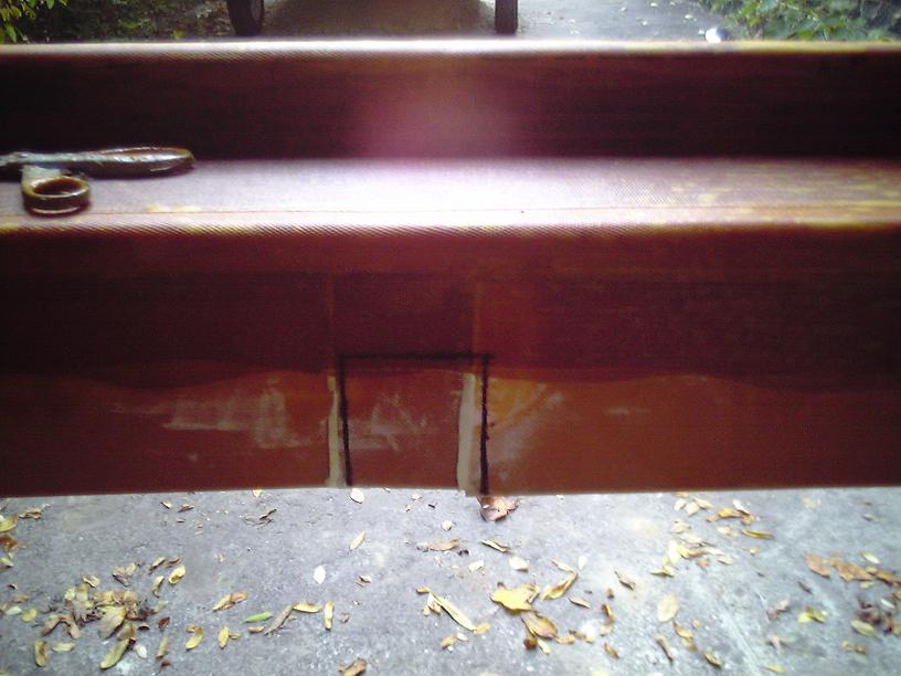

I rotozipped a notch in the cap to allow the tongue to pass through when the cap is down. (1 beer)
before
after
I also found most of a sheet of 1/16" clear polycarbonate in my garage and cut the 2 side windows out of it. (2 beers).

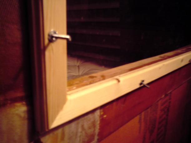

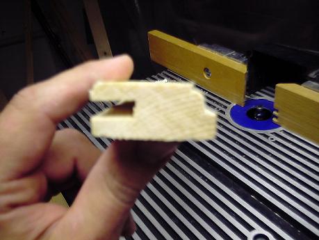

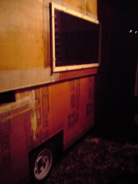

after three passes through the table saw and 2 passes through the router, a 1 by 4 gets turned into two 3/4" by 1 3/4" pieces of window frame.
I HAVE WINDOWS!!!!
The windows are held together by gorilla glue at the miter joints and a lake of silicone in the groove where the glazing slides in. The 1/16" polycarb side windows slide in about 5/8" all around, and the 1/8" plexiglass in the front window slides into the frame a full 3/4".
Each window is surface mounted to BUB with ten screws and a generous helping of silicone(next spring, they will be re-mounted with top hinges and powered actuators).

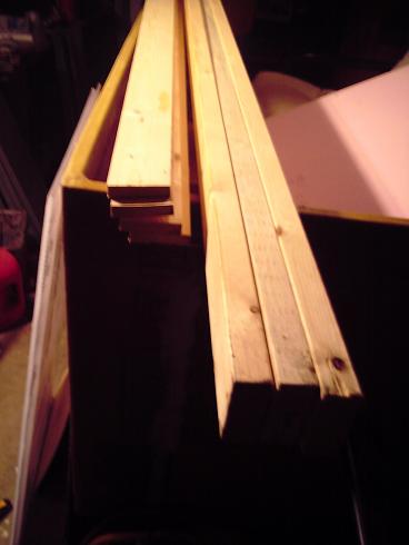

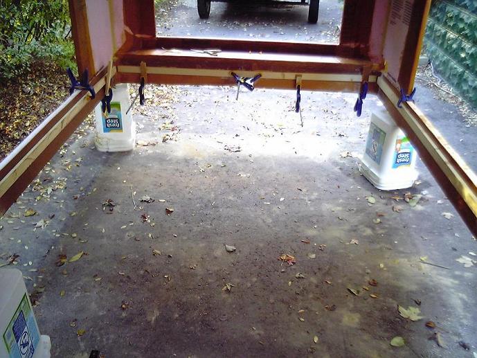

I cut and milled some 2 by 4s into cap strips to screw onto the bottom of bub.
I also ripped some 2 by 4s into 3/8" thick lath and epoxied that onto the inside of the cap. 1/2" weather stripping was then glued to the top of it.
how do you keep epoxy (wet micro) warm enough to apply when it is 45 degrees out?
you keep it in a bowl of warm water and run into the house to microwave it every 5 minutes.(the timing worked out OK, since every 2 trips i could grab another beer from the fridge)
