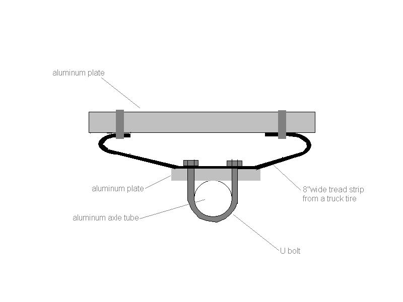

Here is a drawing of the suspension i would propose for a trailer this light.
