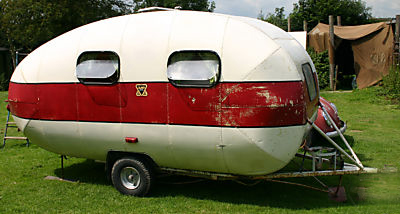

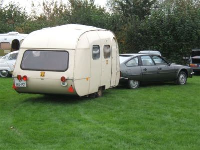

I think the early SMVs are made with all-metal skins, but I suspect the later ones have corner panels made from fiberglass, which is how those corners can be so smooth - fiberglass can be moulded with double-curvature (like a boat hull), whereas metal or ply just won't bend like that. For example, the Roswell is strictly single-curvature: spheres are double curvature and you can't make those from ply!
You can look at many more SMV photos on a SMV fan's site or on the DutchSMVfriends web site, both in their fotoalbum and in their restoration topics of their forum. Of course it's all in Dutch, but Babelfish will translate some of it.
I think you're right that the centre of the walls is flat and only the front/back/top/bottom are curved. All of that is quite easy - it's the four corners that are very hard - those early corners that you don't like are the ones that could be replicated in metal. They could be done in ply too, but getting the geometry right would take a lot of work.

I do like the earlier models, imperfections and all. I think the later ones would easier to build (and yet be different enough for me to build, why be normal?), and if some of the imperfections show up on with the newer design, so be it (if I build it, it will never be perfect. Strange and unique, yes) .
Andrew do you have any idea the bulge in the walls, am I even close?

My guess is that 6" of bulge is right for the early ones but not the later ones. If you look at some of the head-on photos of later ones, I'm not even sure it still has a bulge at the bottom - the door looks nearly flat down there. The tapering of the front panel suggests that only the top has the bulge on these models.

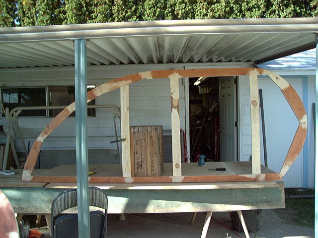

I see no bulge at the bottom too. I had figured out in my head how to build the frame work for the bulge all the way around (sorry I do not know how to put it down on paper, but I can build it), but just at the top and tapering off on the ends, I do not think I even want that. What I want is a hybrid of the two, more like the older style with less bulge.
My thoughts on wall frame work. Typing this out so I can read it later, it may read like incomprehensible babble (now you have been warned). The following is proof of why I am not an engineer.
First build a frame work of the side profile, like this (outside perimeter only), only in the profile Andrew gave earlier.
Then build a second frame work smaller than the first frame by twice the major axis of the eclipse used. Using eclipses made out of ply spacing the two frameworks apart. The ply eclipses spaced apart every (say 12"). The ends will require some pieces at a 45, placed where the seams are on the older SMV (see red and white SMV this post). My current thought on the eclipse is 4" minor, with a 15" major. Andrew if your still laughing (reading) this do not worry about drawing this, all I need to work out is spacing of the eclipse pieces and the eclipse itself. I know this goes against the engineering credo but I think I will frame this then figure out what to skin it in.
