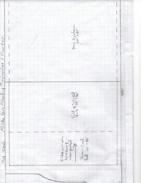

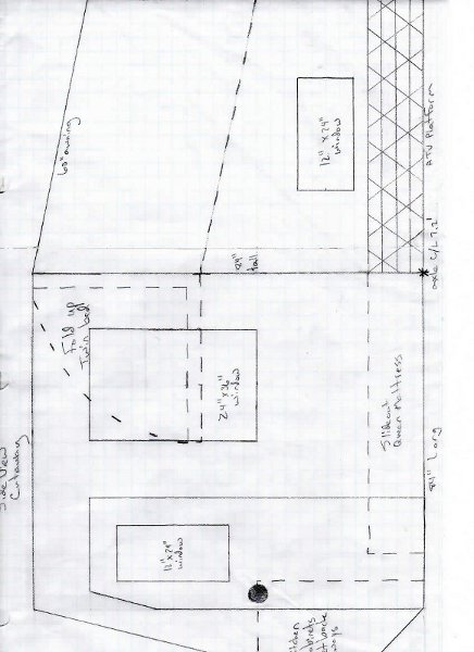

Postby Outdoorsman » Sun Jan 22, 2012 2:41 pm
My first rough concept of what I am thinking, suggestions and comments would be greatly appreciated. Basically a spin off of the Castaway build in reverse. Sorry that the pictures are not orientated correctly I had trouble trying to get them to do so.
Thanks,
Outdoorsman
