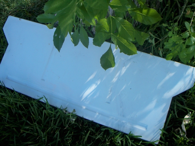

Postby 123jay » Sat Aug 16, 2014 1:57 am
After put all the pieces some what together I put the a Jeep tailgate to see what it look like I like the diamond plate for the tailgate and I can get fiberglass diamond plate to do the chuck wagon sides
[img]123297[/img]

Postby 123jay » Tue Aug 19, 2014 3:50 pm
I tried to do the Kerfing the fiberglass. It did not work out just crack .
But good news for me I did some posting about this build for fc04 and they sent me some fiberglass diamond plate .
So on the hard shell rooftop will have to try to follow jscherb when he do his.
If anyone knows of hard shell rooftop plans that are flat that be great

Postby jscherb » Tue Aug 19, 2014 4:13 pm
123jay wrote:I tried to do the Kerfing the fiberglass. It did not work out just crack .
If you tried to do the cutting with an ordinary saw, that's probably the problem - fiberglass is best cut with an abrasive tool, not a saw blade with teeth - the teeth impact the fiberglass and cause cracks.
For most of my fiberglass cutting, I use an abrasive cutoff disc in a 4 1/2" angle grinder. The disks are less than $2 each and are the type you might use to cut metal.

Postby 123jay » Tue Aug 19, 2014 5:05 pm
Thanks jscherb I cut it with a cut off wheel then sanded the top real thin .It would not bend strait then it would rip. When getting it to lay flat.So more than I want to deal With. I think it is the shape that make it week when cutting to much flat 4" per side and it's to be used in box shapes. I think your shape being rounded would have work better . I just wanted to mach the cover. I member you saying you where going to do a hard side clamshell some where. so will be keeping a eye out . Thank you for the help.
