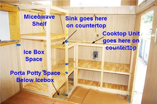

I’ve completed all of the basic cabinetry framing and have the finished (stain/varnish) face framing ready to install on the side and front cabinets. I’ll do that for the tall cabinet after I’ve received and dry fitted the icebox. Cabinet door for the front cabinet are framed and pieces cut out for the other two cabinets ready to assemble. I have yet do decide on what to use for the door panels or if I will have two drawers in the side cabinet below the sink.
I’m waiting on the icebox and haven’t yet ordered the sink (will do that today). Yesterday I ordered my shore cable, battery monitor and a single basic faucet for my sink. I plan on also installing a filter/drinking water faucet combination like I have on my sink at home. There will be no hot water connection or a water tank. Here is the galley cabinetry as it looks now. The tall cabinet won’t be attached to the floor and wall until the icebox and exterior paneling is installed.

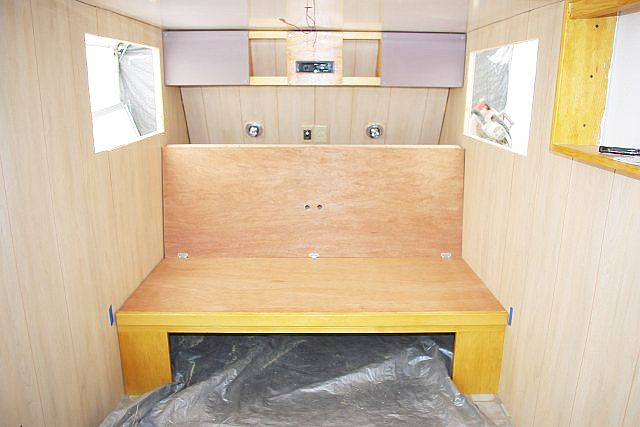

In the photo below, the bed platform has been extended for sleeping and you can see the end of the bed platform touching the tall cabinet and how much floor space remains when the bed platform has been extended.
