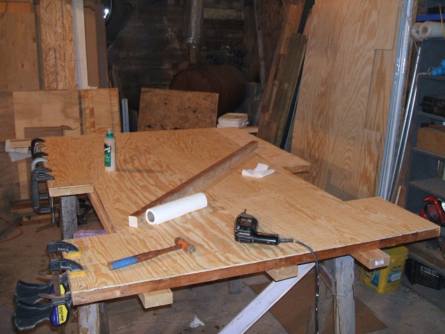

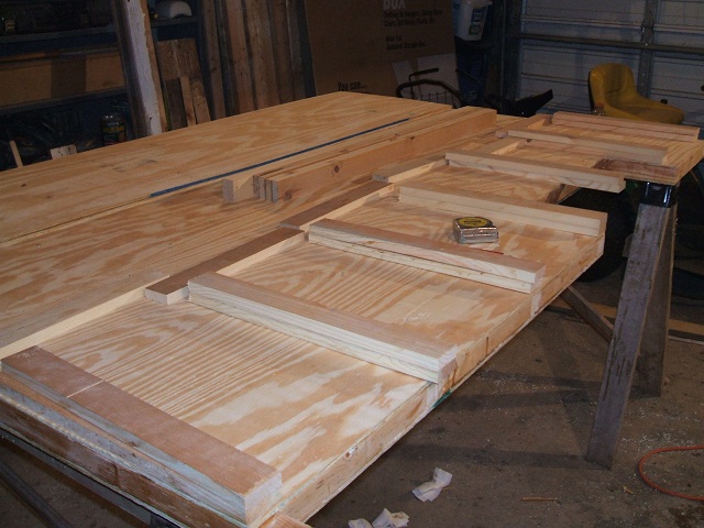

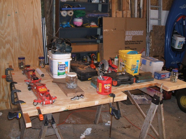

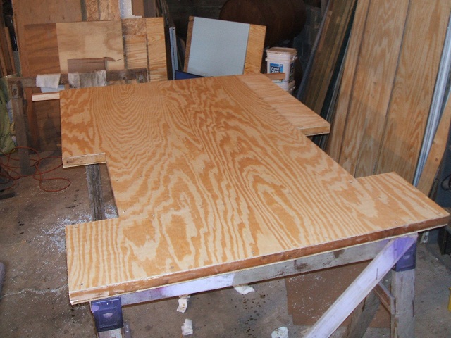

Had 2 nice days weather wise yesterday and today. I wish they would come on the weekend. Anyway, I made some saw dust and cut out the floor and sides from the plywood. Started assembly of the floor. Lots of glue, screws, and clamps. Pictures speak a thousand words.

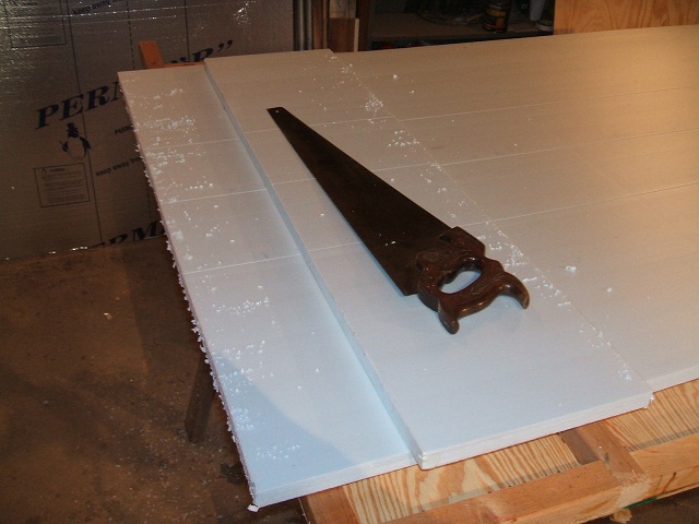

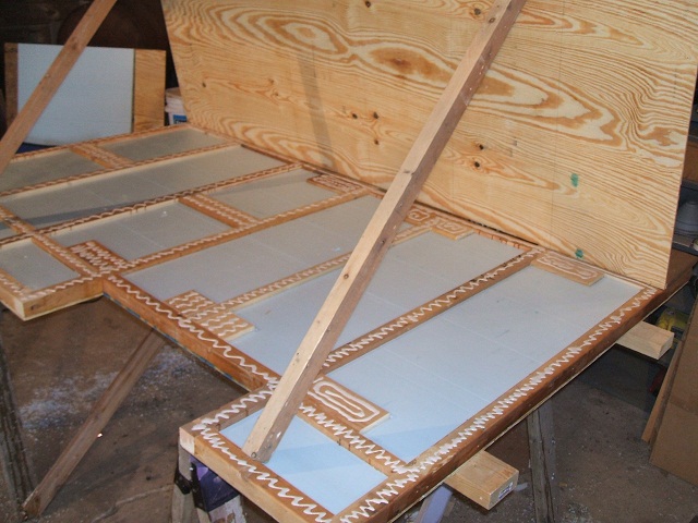

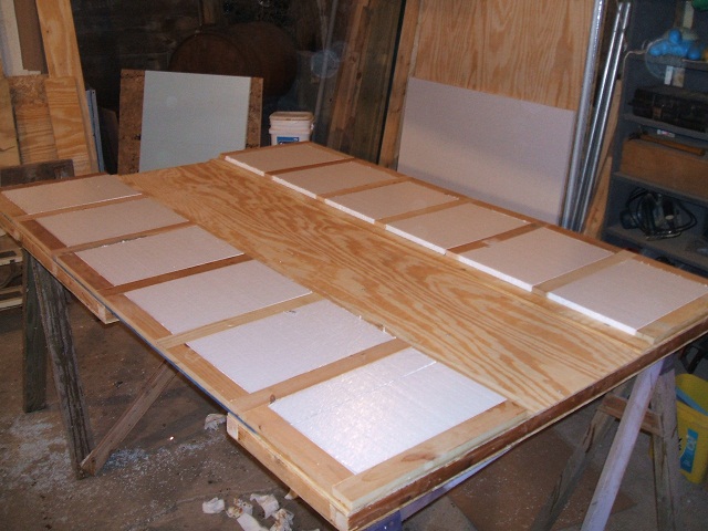

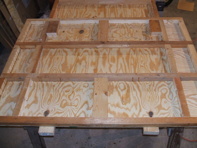

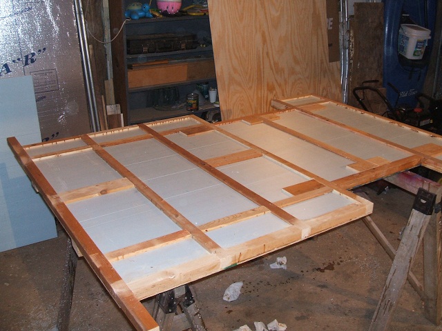

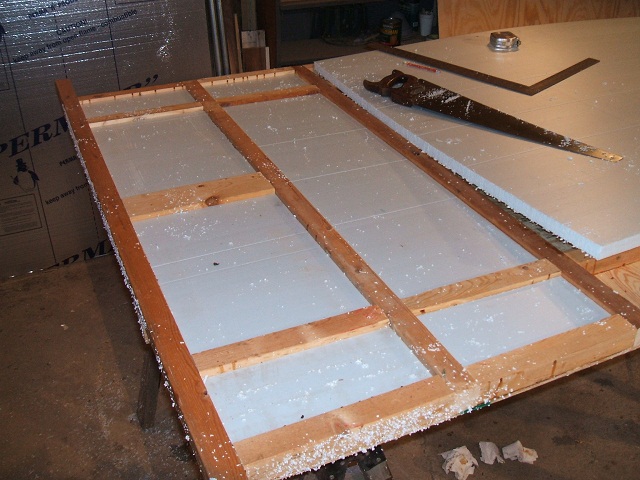

Got a little bit done today. I added the blocking in the floor where the bolts will be going through.
I used a hand saw to cut the insulation. It worked great.
But it creates quite a mess.
The floor insulation is finished.

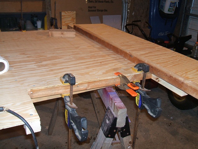

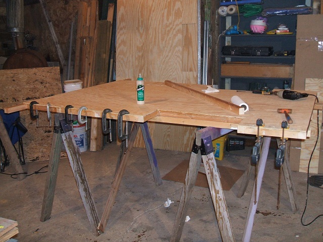

Postby mckenney56 » Sun Mar 11, 2012 4:45 pm

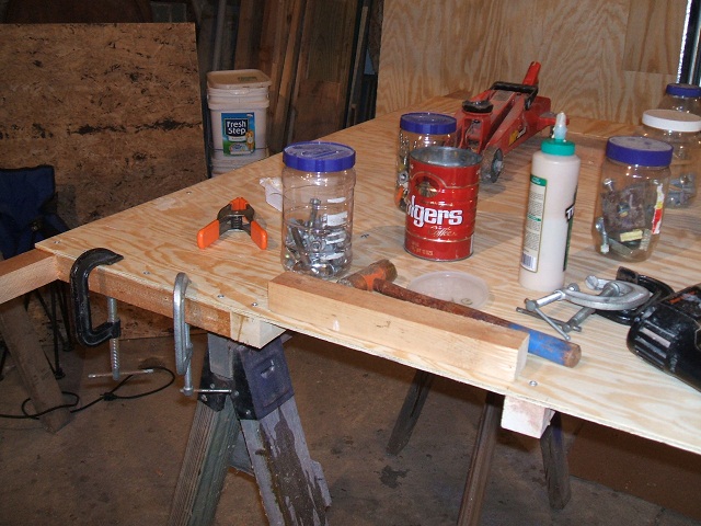

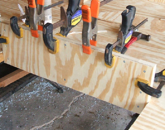

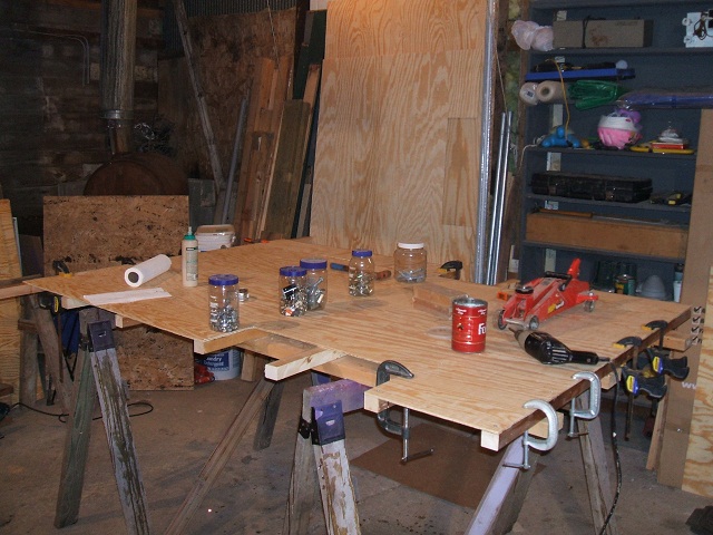

More progress. Lots of glue to close up the floor.
A whole lot of clamping going on. And lots of screws too.
Floor done.

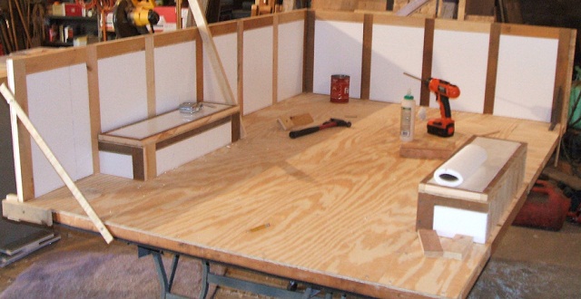

Postby mckenney56 » Wed Mar 14, 2012 10:31 pm

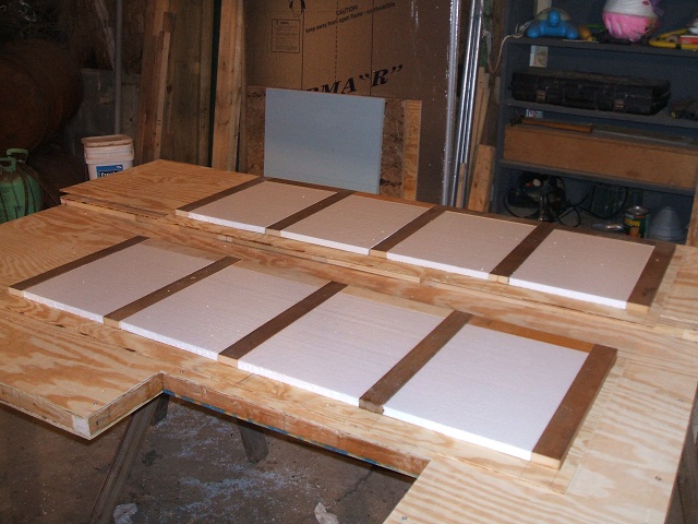

More progress. Side walls framed and insulation installed. I going to wait until I have the front wall and rear tail gate made before I install them.

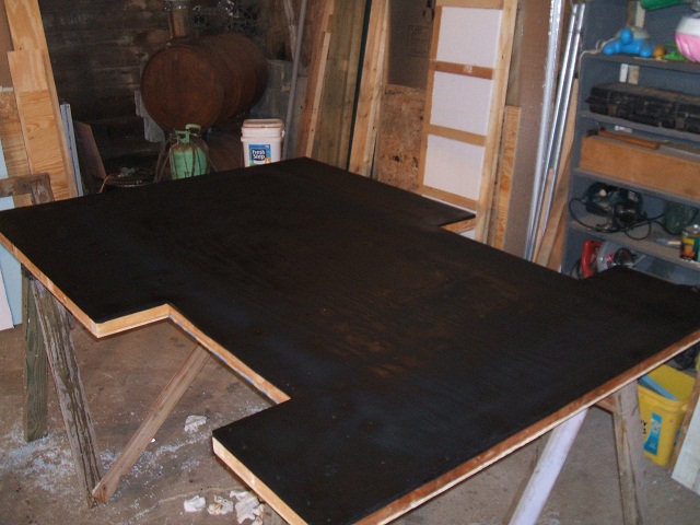

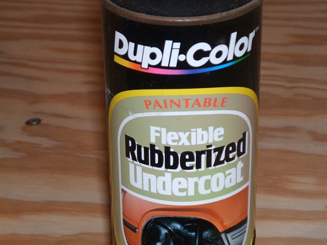

Time for undercoating. I found this on a shelf in my barn. Decided to give it a try.
Taped off all but the bottom layer.
Trouble was, one can wasn't quite enough.
The spots in the middle are where I started by covering the screws.
I guess I'll have to go the the store and find another can of this stuff.

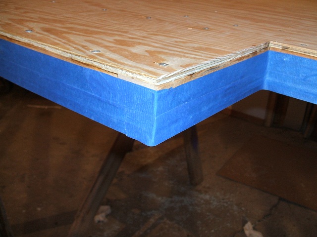

Postby mckenney56 » Mon Mar 19, 2012 12:51 pm

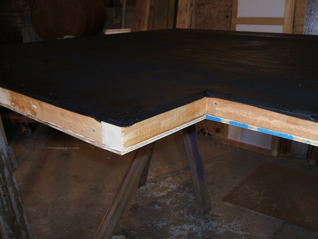

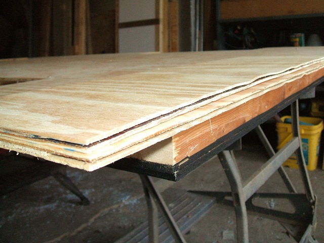

I aquired more black stuff and applied it to the bottom of the floor.
Here is a view of the edge with the masking tape removed. I was attempting to make sure that plywood edge was sealed up good.

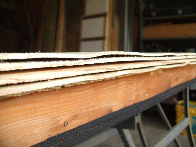

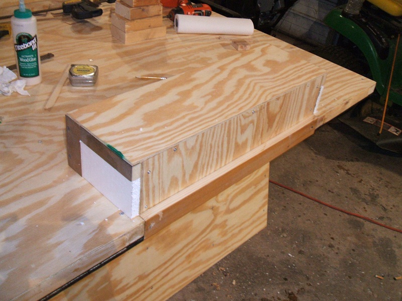

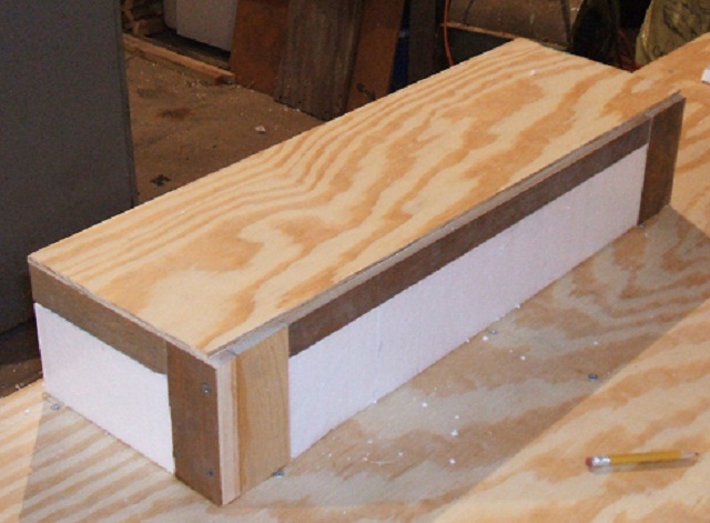

I got back into the shop today and started on the wheel wells. I encountered some bad places with large voids in my CDX quarter inch ply.
I decided to to build the wheel wells in place one piece at time. Seemed to take forever, but I got it done.
Maybe tomorrow I'll finally install the walls and front.

Finished the wheel wells.
And installed two of the walls.

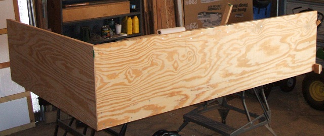

Postby mckenney56 » Sun Apr 01, 2012 9:18 pm

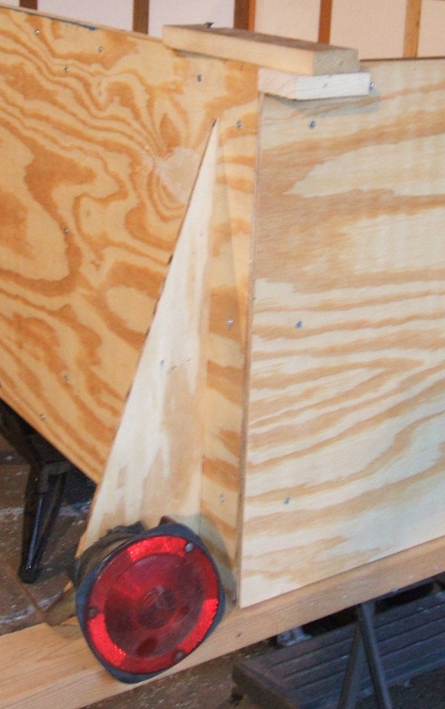

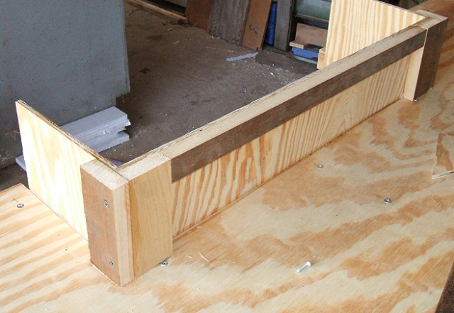

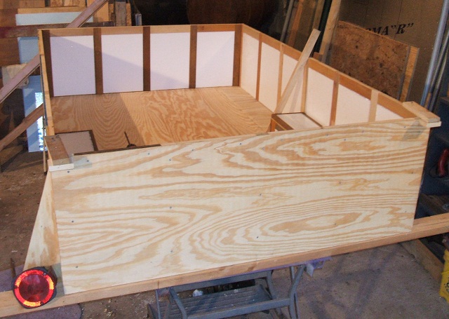

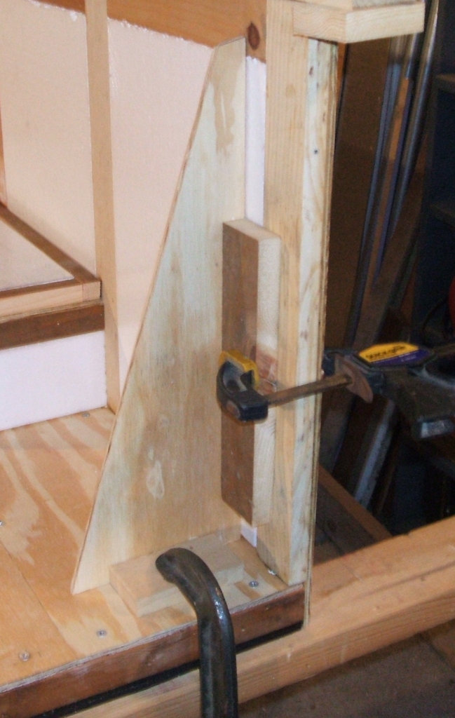

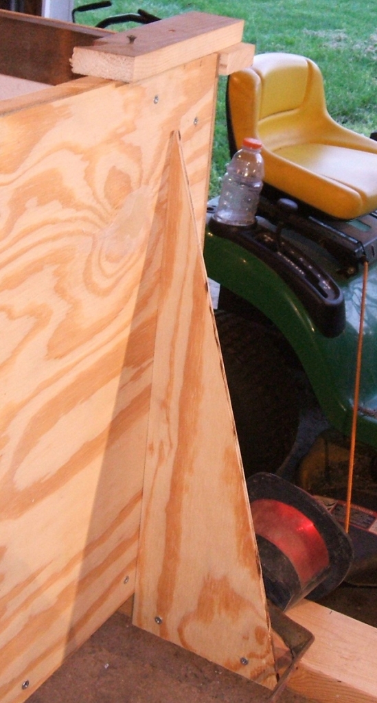

More progress. I got the other wall side installed. And test fit the tailgate. It's finally starting to look like something.
The side walls won't stay square. They are splayed out at the top. I experimented with a couple of options.
One was put a brace on the outside, then I could mount the tail lights to them.
The problems I see with this option are that thing will catch some air flow and also catch mud from the tires.
The other option is put it on the inside. I'll have to make them narrow enough so I can still load 4 foot wide sheet goods in the trailer when I want to use it to carry plywood home (To build campers with of course).
Any other ideas out there?
I still have to come up with how to latch the tailgate in place. Then I'll move on to constructing the roof.
