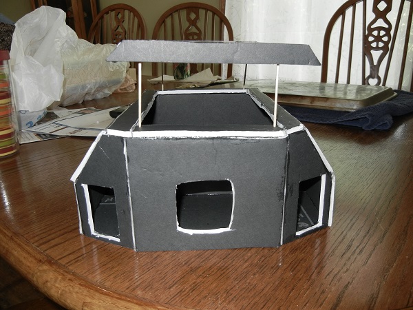

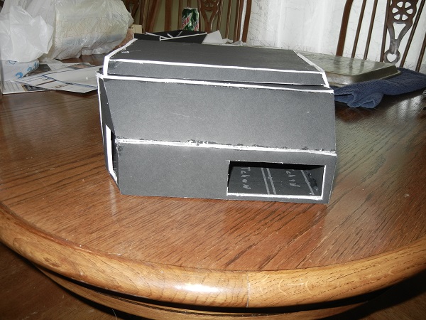

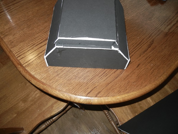

Here is the next version of this thing.
I like this version better. That dormer didn't look right. Thanks for helping me see the light. :lol:

Are you going to add hard walls to the popup part or you are thinking of tent walls? The shape looks nice, btw.

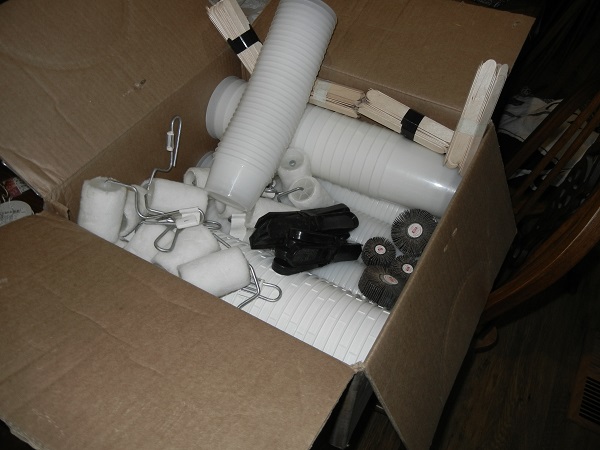

My sister and BIL were up a couple of weeks ago to visit. He worked in the fiberglass industry for 42 years. We had a few good long talks about doing glass work. Before they left he told me he would send a few items I could use. I hit the jack pot.
