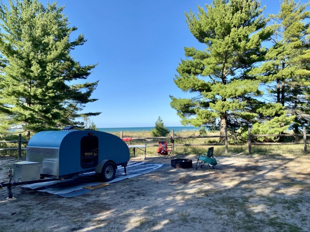

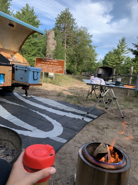

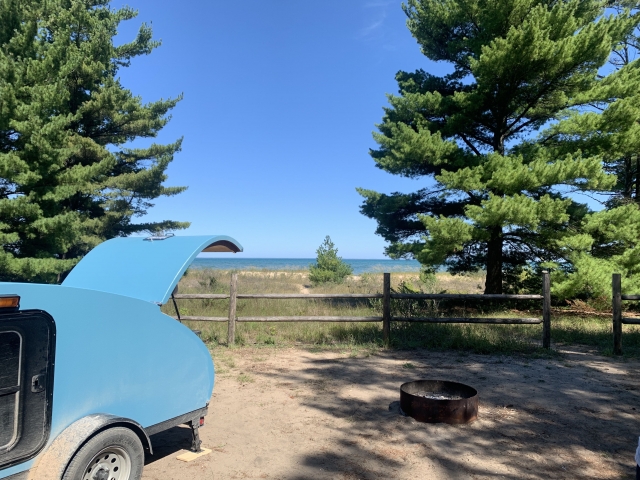

My wife and I successfully completed our first multi-nighter, long distance trip. We spent several nights in Ossineke State Forest Campground, which is the only first come, first serve state forest campground with Great Lake frontage in Michigan's lower peninsula. Located on Lake Huron, we had some incredible sunrise views and spent lots of time on the beach. There are three "signature" sites that the campground is known for that are closest to the Lake, approximately 50 yards from shore. Given that we showed up early on a Thursday morning, we had the blessing of getting to have our pick of the three. Within an hour of unhooking the trailer, the other two were taken.
One of the many teardrop trailer perks is that you can maneuver your trailer in ways that larger RV's can't and you can park and level it in areas that would leave tent goers rolling downhill in their sleep. We were able to park the trailer so that the galley overlooked the lake while still being able to see the sunrise when looking through one of the windows each morning.
The beach and lake bed along this stretch of shoreline was very nice and sandy, which can be tough to find on Lake Huron.
Both nights that we were out offered clear skies and the best views of the stars that we had seen all summer.
Despite each site having a fairly nice fire ring, we opted to use our solo stove fire pit instead. This thing just might be our favorite camping gadget. We have the smallest model, which is just right for being able to travel with it. The fires really are nearly smokeless like they advertise and burn extremely efficiently. Definitely not a paid advertisement, but we would recommend it to just about anybody that is considering getting one.

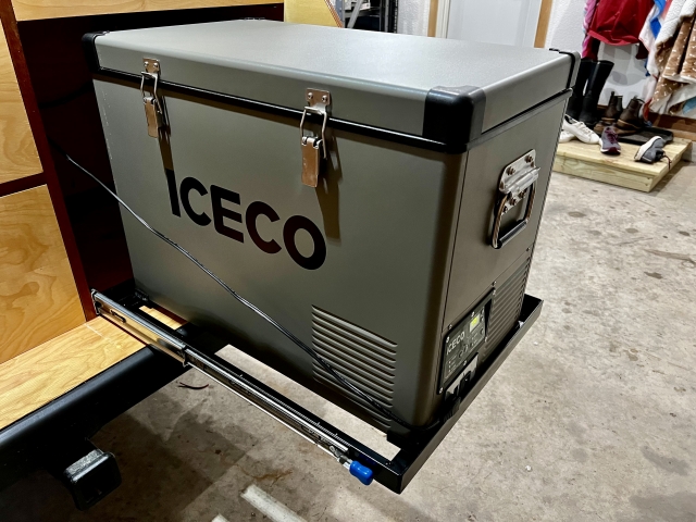

After our first couple of 2022 nights in the teardrop, my wife and I decided it was worth trading the Orca cooler for a portable fridge. We were able to sell the Orca for $50 less than we paid for it last year, so I was pretty happy. We replaced it with an Iceco VL45.
Unfortunately, this forced me to rebuild the cooler tray since the Iceco was slightly taller and longer than the Orca. In order to maximize space efficiency and provide as much clearance as possible, I welded up a new tray using 1.5” steel angle and attached it to the locking drawer slides using machine screws and lock nuts. This allows for maximum ventilation on all six sides of the fridge when it is tucked away in the galley.

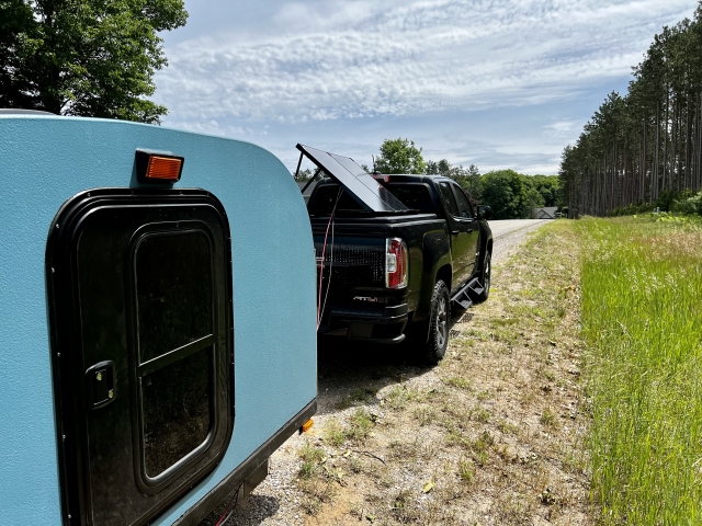

Since we were now eating up additional electricity with the fridge (and my wife got a 12V heated mattress pad for Christmas) we also decided to take the plunge into the world of solar. Based on my calcs, we could only get away with being away from a charger for about two days if both the fridge and the mattress pad were drawing from our 100AH battery, so I opted to get the Renogy 200 watt suitcase solar kit. 200 watts seemed like it might be overkill but I would rather lug around the extra weight in panels than run out of juice.

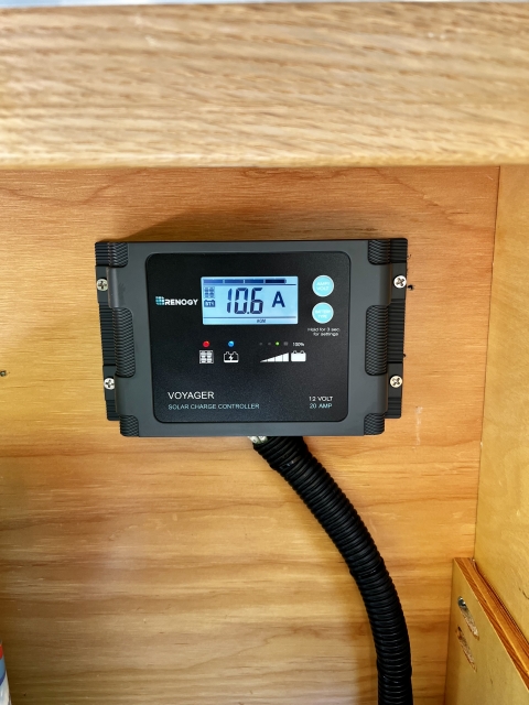

Rather than leaving the charge controller attached to the panels, I mounted it in the galley to get it closer to the battery and installed a zamp wall connector per the recommendations of others on this forum. It killed me to take a hole saw to a perfectly good section of our wall, but oh well. I made sure the exposed wood within the hole was coated in epoxy and then installed the zamp connector with butyl tape, stainless screws, and proflex sealant.
For wiring, I used 10AWG throughout, both inside the camper from the connector, to the controller, to the battery, as well as outside the camper for the extension. The extension cable outside the camper is around 12’ long, which allows us to have the panels sitting on the tonneau cover of the truck while it is attached to the trailer when we are parked places.
We spent the weekend testing out both of our new gadgets at Leelanau State Park and couldn’t have been happier with our investment. It was great not dealing with ice and having the ability to take twice the amount of refrigerated goods with roughly the same amount of internal volume as the regular cooler. It was a lot more energy efficient than I anticipated as well. It averaged around 0.6 amps per hour over the course of the weekend. On the second morning, despite the heavily wooded site, we managed to completely recharge the battery within 3 hours of hooking up the panels and even managed to reach their maximum rated output.
If anyone has any recommendations for a good wire loom/sleeve to house our extension cables in, I’d greatly appreciate the input. I’m considering giving the PET expandable braided sleeving a try so that it won’t trap moisture if the wires get rained on.

Garth: Looks good! What size Iceco did you go with? Only consuming an avg of 0.6 a/h is amazing,..must have been able to actually cycle. I’m guessing it wasn’t too hot there?
Mike
orourkmw
Posts: 108
Images: 69
Joined: Tue Jan 25, 2022 12:55 pm
Location: Port Allen, Louisiana
Re: G&M's 'Drop
Postby GarthB » Tue Jun 21, 2022 2:20 pm
orourkmw wrote:Garth: Looks good! What size Iceco did you go with? Only consuming an avg of 0.6 a/h is amazing,..must have been able to actually cycle. I’m guessing it wasn’t too hot there?
Mike
I went with the VL45, which they advertise as having 47.6 quarts of capacity. Outside temperature and direct sunlight were pretty mild all weekend. Low 60s during the day and mid 40s at night. Fridge was set to 38F.
Another person online did a review of it, linked here: http://rvbprecision.com/rv-projects/iceco-vl45-portable-refrigerator-freezer-review.html
I ran the numbers on his "August 2020 Update" and, as long as my math is right, it looks like he averaged around 0.53 amps per hour over a 72 hour period.
