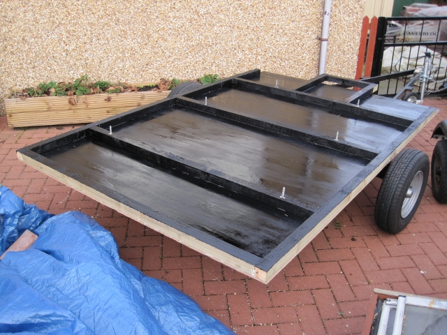

BigAl wrote:There has been a break in the weather and I have built my base and painted the underside with bitumen paint (Aquaseal).
In the picture you can see the progress so far. Please note that the base is sitting upside down on top of the trailer frame and is not in its correct position.
The frame is made from 1/2 inch Marine Ply on top of 2 x 2 pressure treated timber glued together with polyeurthane glue and some biscuit joints.
This is my first time using a biscuit jointer and I was really impressed on how easy it made building the framework.
Hopefully I will have good weather next weekend and perhaps make a start on the walls.
