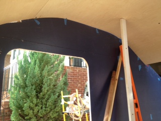

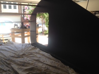

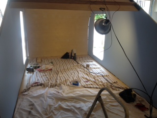

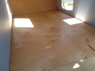

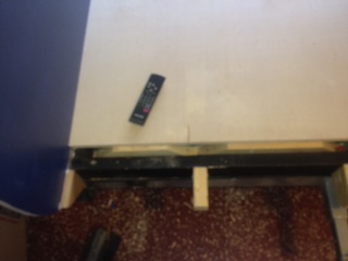

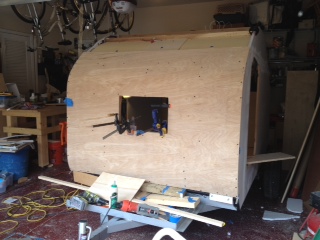

I have made a little progress so i'm posting a few pictures. i primed both side walls inside and out and put a first coat on inside walls before i start putting the galley walls/etc in. I'm using paint i already have so the blue was the best option. I also got my wiring under the floor in that will feed the AC unit I will place in the front only when at campsite. I have the 3/4 ply floor top cut and laid in but not secured. I still have the 6.5" extention to the floor left to cover.

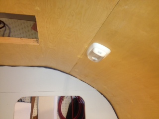

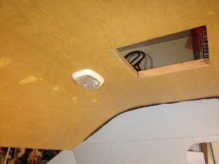

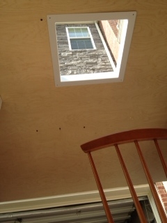

A Couple of pictures from my work over the last 9 days.
Seem like little progress based on pictures but I accomplished a few things:
1. Floor in
2. second door cut
3. headliner in. A few screws remain as seen in the photo, but they will come out
The headliner is made of 1/8 bendable birch. It is really pretty and I think will look good once the finish is on.
I replanned the galley configeration which can take lots of time and measurements. I also bought many electrical parts from Camping World, Walmart, Bass Pro Fishing Store.
Next I will apply CPES to floor and headliner, prewire spars, insulate, then start finding my bendable plywood.
Does anyone know a good place to find 1/4 ply (bendable) I can find luann but not sure which is better? Seems like I recall some sad results of applying CPES to the luann

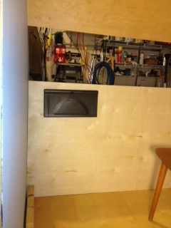

Postby CHUNKYMONKEY » Mon Aug 20, 2012 7:47 am
More pictures from weekend of Aug 18

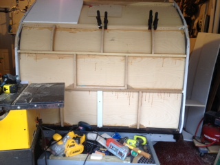

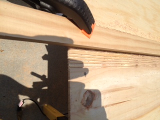

I found some .50 mm ply at the Lowest Box store. They come in 4x8 sheets and with some relief cuts curved relatively easily on the front curves. I screwed to hold until glue dries, then most of the screws will come out and i'll fill the holes. I only bought one sheet to see how well it would work. They cost $10 and some change which i thought was great! I went back and bought two more sheets to finish the top. I even got them to cut for me which makes it easier to slide in my vehicle and less cutting at home. I realized I could not permanently attach the top until i have a battery to test my wiring, so I had to break down and order my Optima ($$ouch) $> I will be leaving for vacation in two days so I won't get back to working on the tear until Labor day weekend. I hope to have a lot accomplished by the end of that weekend. I've got to get a test run in before my big trip Oct 18th.

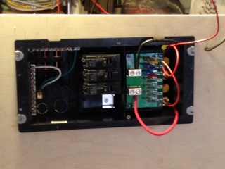

Seems I never accomplish as much as I hope to and the same was true over the Labor Day holiday. I did get my 12V wiring run and tested but I had some good learning experiences while doing that. As I learned from my mistake, I hope someone else can learn too. I have done home wiring myself before but never 12V. I bought the RV Electrical book someone on this forum recommended and read as much as i could of that but found it pretty technical and not enough pictures. It is probably very valuable to someone more electirically inclined than me. If anyone is interested in buying it PM me.
I am using a WFCO-8714 Panel.
Can you find the wiring problem in the picture?
The problem is I have the black ground wire from the battery connected to another positive hub. The panel is designed to take two batteries, but I didn't realize that right away. After several incidents of sparks flying, I called on my resource for electrical help. He helped by saying I have something crossed, but i finally figured it out when I closely reviewed for the 52nd time the diagram provided by WFCO. I removed the black wire from the second positive hub and connected it to the ground block on the rear of the panel. PROBLEM SOLVED. So everything is working fine now. :DOH2:
I have read as much of the electrical information on this forum as i could find over the past few months. What helps me most is pictures so I hope you find this helpful too. Thanks all who have posted!
