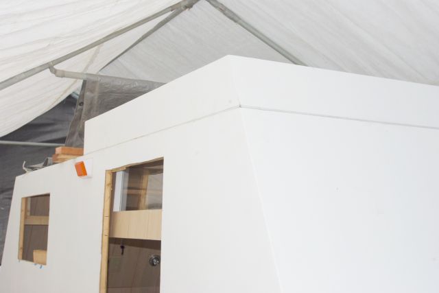

Yesterday, I installed the first "raised panel" that will support the pop top. Today I expect to get the other three installed and the top on by the end of the weekend.
