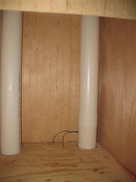

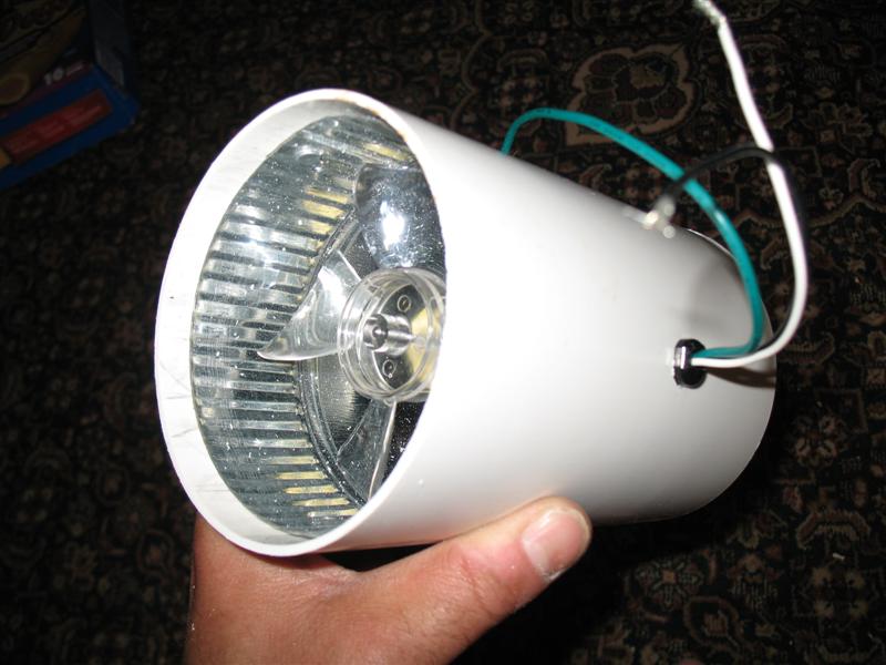

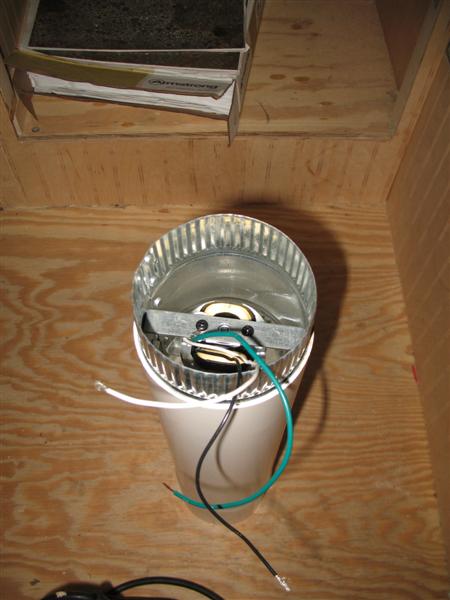

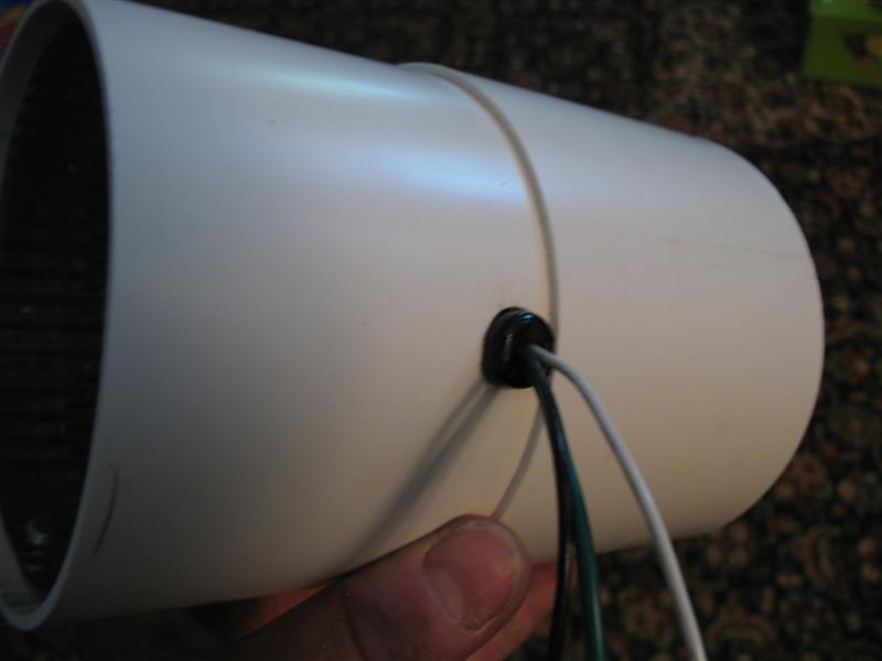

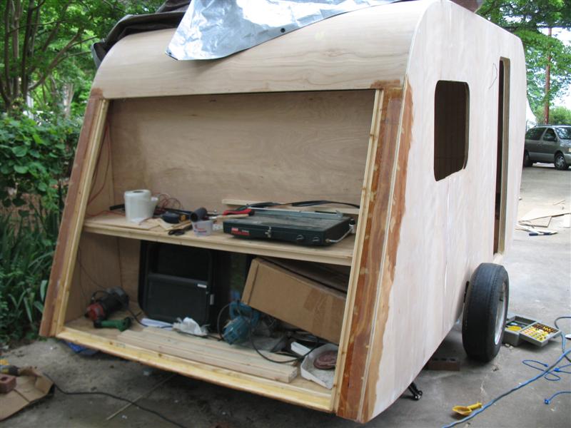

Postby john » Sat May 16, 2009 2:46 pm
Well that was quick. While the glue was drying on a skinning repair that I will report on tonight I installed my inline fan.
I was able to use the left over bit of pipe with the flared end to do the install. I cut the flared end off to use as a slip coupling. Then I slipped the fan into a 6" length of pipe and ran the wires through an existing hole in the fan body and a hole I drilled in the side of the PVC. I was then able to snap the wire protector on the fan body through the hole in the PVC. This wire protector also locks the fan body into place so as not to slide inside the PVC.
Edit----I got the fan for $25 at HDepot.
Pics..........
Fan in PVC tube
Slip coupling on
Fan installed

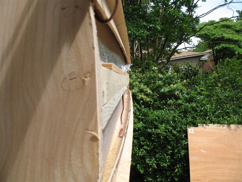

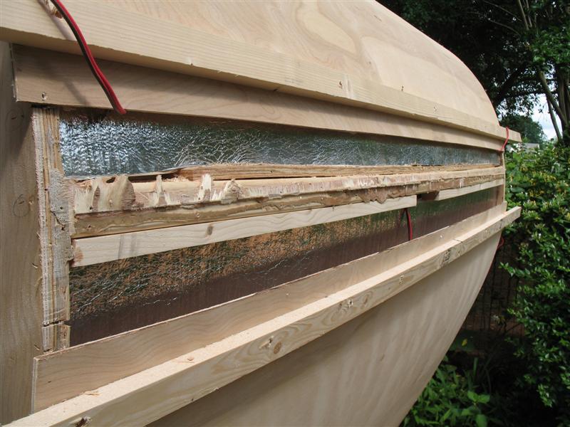

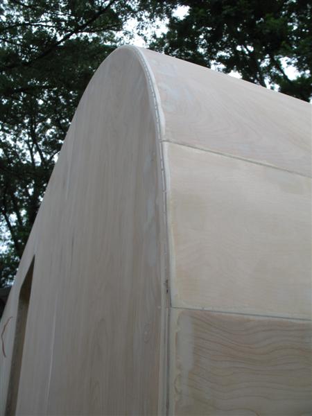

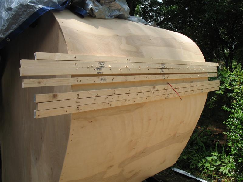

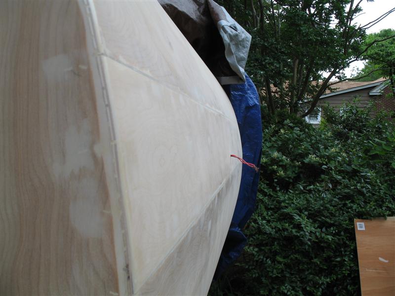

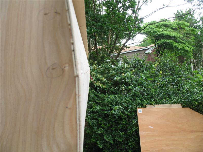

Postby john » Sat May 16, 2009 9:57 pm

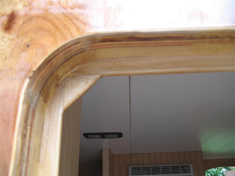

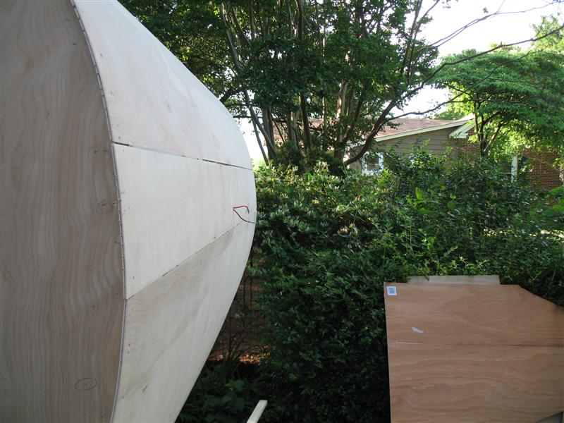

Yesterday morning I began to remove the sticks I used as clamps to hold the skin to the spars as the glue dried.
I got to one on the front and when I got it off I was able to see the seam that was under it. I didn't like what I saw. :roll: :roll:
The spar under the seam was bowed outward by 1/2". If I had not used that spar for the seam I would have been better off. OH well....
I fiddled with other stuff while I let the issue swim around my mind. Then this morning I decided to do surgery.
After I got inside I planed the offending spar flat.
I then reskined the wound and clamped it tight. I hoped to get a continuous curve.
The clamps were removed late this afternoon and, although it is better, the results were not quite what I was hoping for. I now have two much smaller and tolerable "ridges" at the two seams. Although the skin follows edges of the curved wall there is a flat spot in between the seams at the center of the trailer. I can mount my hitch lamp on it. :thumbsup:
I have come to the conclusion that seams along a curve are to be avoided. I think I will stick with this repair but I may make another go at it.

Postby Miriam C. » Sat May 16, 2009 10:06 pm
:o Unfortunately if this is bugging you now it will drive you up a tree later. Some things are better fixed from the start. My boo boos drive me nuts but it is too late.............
I really like the fan idea. :thumbsup: Great solution. :applause:
Postby Micro469 » Sat May 16, 2009 11:10 pm
How are you going to finish the roof? I would definatly glass those seams . Or put another layer on the roof and have the seam on top... and glass that one as well. Unless you are going to cover it with ally. But natural or paint.... I would recommend fiberglass.

Postby john » Sun May 24, 2009 5:45 pm
Sometimes boo boos lad me to something unexpectedly pleasing. In this case I could not have gotten what I now have if I had tried for it. Perhaps I am rationalizing this but I think I like where the boo boo lead me. The paint will tell the story.
Those seams are horrible :shock: fortunately they do not represent the others. I will be fiberglassing all the seams in particular the worst. In fact I put the first of my fiberglass on today.

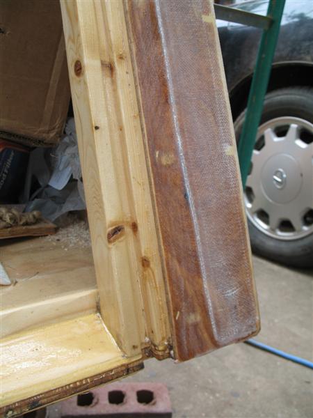

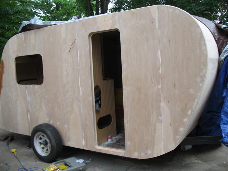

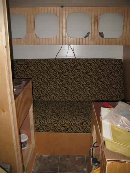

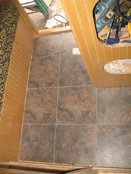

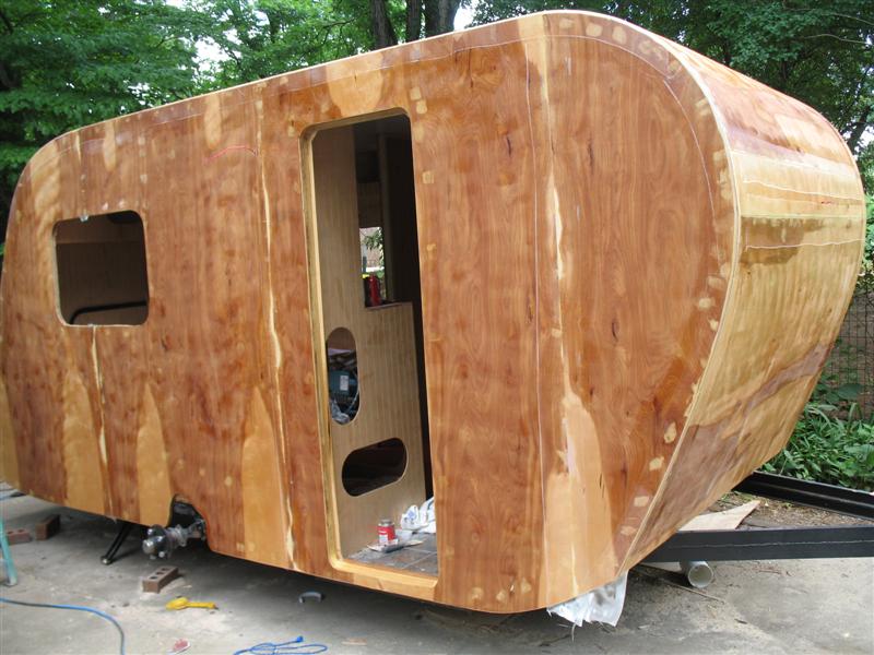

Postby john » Wed May 27, 2009 3:05 pm
I have gotten lazy with the updates. This is a catch up post.
We have had forecasts of rain for days. I find I have to push myself even more to get anything done when the forecast is bad. I unconsciously say to myself "I'll just get rained out". If I can set the excuses to be lazy aside I often get a lot done between the rains....if it rains. In fact, one day I pushed ahead with glassing/fiber glassing the whole trailer while NOAA was calling for a 70% chance of rain and thunder storms. I regularly took breaks to see where the rain was falling. There was no rain that day. I was lucky.

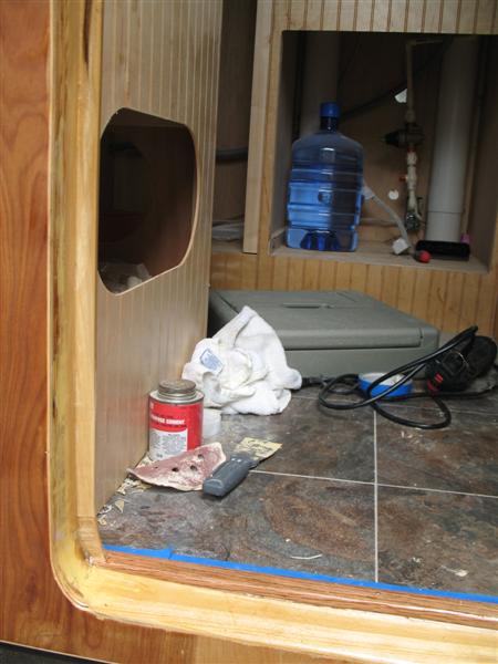

On other more rainy days I moved inside. My wife pained the interior bead board. She sanded the walls the next day while I was out of town and then together we put on a second coat when I got home.
On another day when dusk was settling in we installed the slate floor. OK fake slate....... OK vinyl squares. The caulk like grout between them goes a long way toward getting the real look of slate.
The filling and sanding needed before the glass work has been atrocious. The sanding after the the glass has been awful as well. I suspect the sanded that will be needed after the second coat of glass will be cake and donuts. Horrible cake and donuts. :D
On to the pics..............
The boo boo filled and sanded.
I rounded the edges with the router and filled/sanded voids.
Whole trailer sanded
experimenting with fiberglass on the rear corners. The rest of the trailer was glassed the next day.
First coat of fiber glass
Door detail
Door detail
Hatch detail

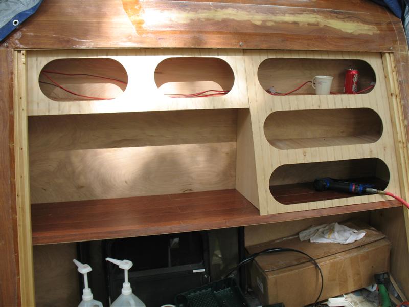

I used more prefinished flooring for the counter and then began the cabinets. I realized later I left no room for my hatch prop on the right. :thinking:
Couch/bed material. Comfy
The slate floor....

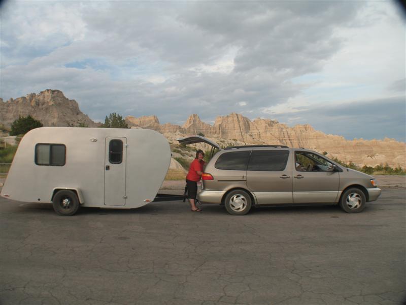

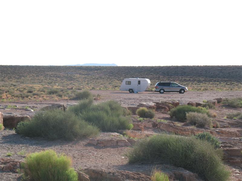

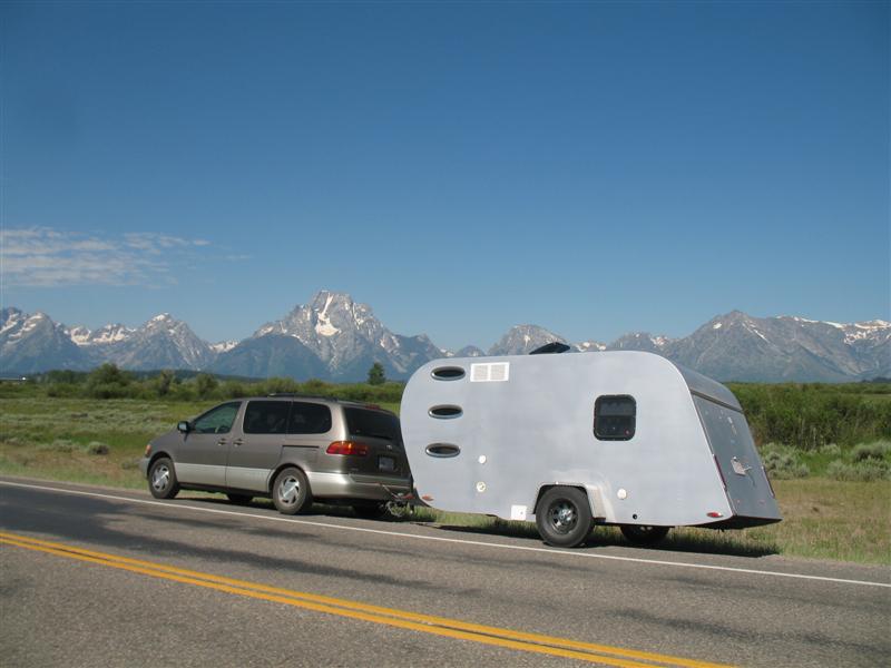

Postby john » Sat Aug 01, 2009 5:40 pm
I thought I would post a couple of completed pics. I didn't have time to do so before leaving on our camper's maiden voyage. There was a lot to do before we left. We will have been gone for nearly two months.
From NC to Texas and southern Utah. We spent a lot of time in Utah hitting all their southern parks. Nice. Four Corners and Saguaro national Park. A week in Yosemite. Nice. Then to San Fran and Bodega Bay north to Oregon. Nice. Around Eugene we started for home by way of Glacier then Yellowstone and the Tetons. To Little Big Horn then Mt Rushmore and east to the Badlands. Nice.
Approx 12000 miles.
We're a fortunate nation and "nice" is a poor adjective but no adjective covers our riches.
Badlands
Brantley State Park near Carlsbad New Mexico
Tetons
Sonoran Desert
Redwoods
Goose Necks near Monument Valley
25 miles of Badlands gravel. A lot for me.
