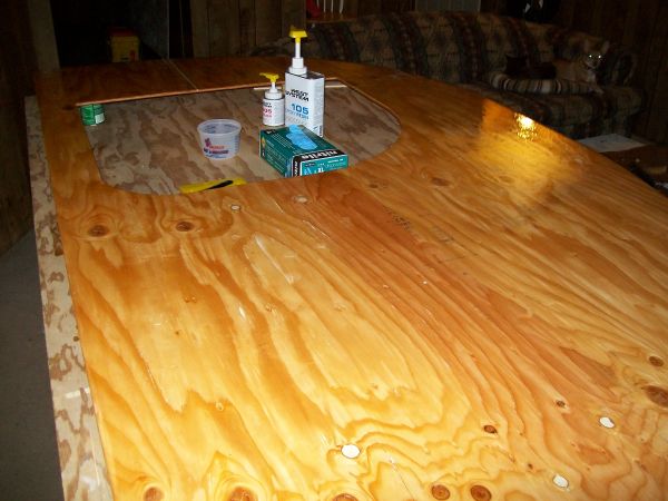

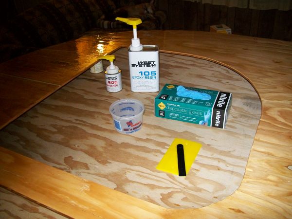

Postby down under tech » Tue Mar 09, 2010 10:34 pm
Hello group: On Friday last week I got the epoxy to coat the side walls of the TD. It was the first time I used the West Systems epoxy. I didn't get the pumps because I thought they were to big for the small cans I bought. Thanks to Super Doug, He advised me to go back & get the pumps (had shorter tubes to use with the cans I got) to make an accurate mix of part 1 & part 2. I am glad he made me spend the extra $ so it would turn out the way it was suppose to. I laid out one coat on one side of each of the sides last evening. Today I went to Lowes and I picked up a DeWalt random orbit sander. I also got a pack of fifty pieces of 220 grit sandpaper for it. After the epoxy set up for 24 hours, I sanded them to smooth them today and to get some tooth for the second coat. I have added more pics to my album tonight. Tomorrow I will do first coat on the flip side of the sides. I will be relieved to get the sides attached to the floor. I still need to paint the HF frame silver. That is when it gets warm enough to paint outside. I have a automotive paint gun for this.
Let me know if I left out anything in this update !!! LOL :SH

Postby High Desert » Wed Mar 10, 2010 12:32 am
here ya go Johnny...
West systems epoxy
Second coat after 2 hours
you're making progress! :thumbsup:

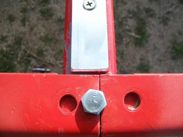

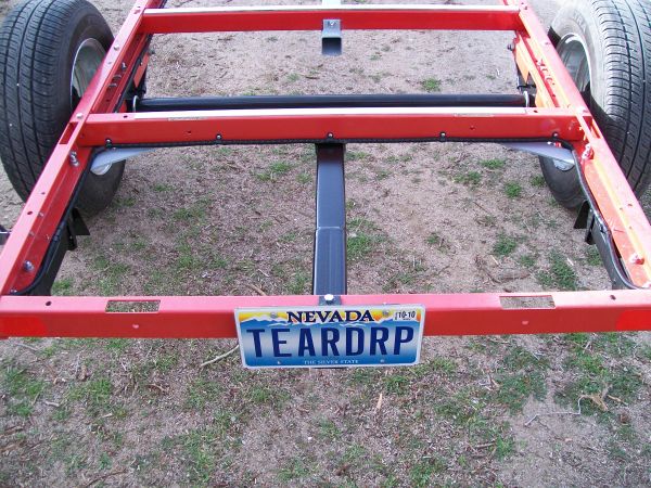

Hey Ya All: Sounds like I'm from Las Vegas, you know "down south". Well any-who, I have been getting some things done in the last week or so. I got the sides covered with two coats of West Systems Epoxy, inside and out. P.S. Ignore the faded paint on the hood of the car the side is leaning up against. (It is an optical illusion, yeh, that's it.)

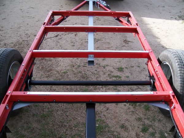

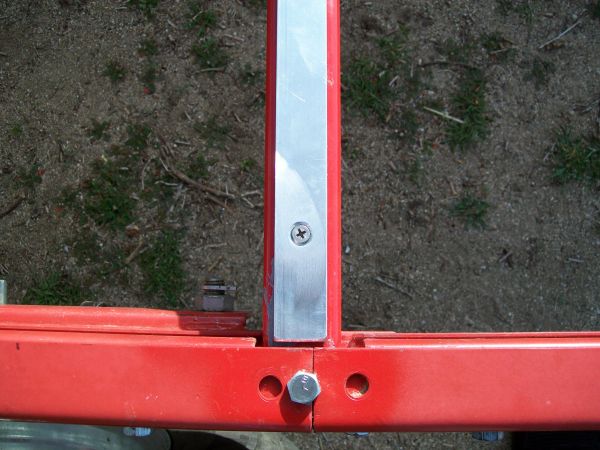

I made some more mods to the HF frame before I install the wooden floor. The cross members sat a little lower than the side rails, so I went to Lowes and got some pieces of aluminum that were the correct thickness and mounted them to the tops of the cross members. I bolted them down with SS bolts and lock washers along with blue lock tite. I will not be able to access them after I put the floor on so I don't want them coming loose.
I counter sunk the screws so they would not rub into the aluminum sheet I have on the bottom of the floor. I was thinking of adding PL adhesive to the tops to hold the floor down tightly to the frame. Do you have any ideas on this or should I just let it ride there, dry?

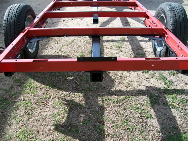

I fabricated a trailer hitch for the back of the trailer and installed it yesterday after work. I added some gussets to the next to the last cross member (gray paint), & frame side rails. I did this to stiffen up that cross member for the added stresses the items on the trailer hitch if I do carry anything on it. I have not decided if I will or not at this time. The main reason I did it was for added future resale value. You can see the aluminum strips I added to the cross members & the gussets better in this next pic.
Here is the finished trailer hitch installed on the HF frame. The black bracket above is a temporary license plate holder. I made it so I can move the trailer around as I work on it, to keep "Johnny Law" off me. Hey, I wonder if we are related? I will remove it before I install the floor. The license plate will go on the hatch of the TD later.
My next and I hope the final mod to the frame is to paint it silver. I have set aside today and tomorrow to replace the engine in my mother's car that my "Black Sheep" half-brother decided to blow up for us. Thanks, Bro !!! He doesn't have a job and has been "Remodeling" a house for a lady friend of my mom for five years now and I can't see any improvements to that house yet !!! He is living there in exchange for the work he is "not" doing. I could not live like that. I need to always be doing something. I need to see progress. Even if it is just a little bit of it.
Hopefully I can get the frame painted and the floor mounted soon. I will keep you updated as I can.

Postby synaps3 » Sat Mar 20, 2010 7:47 pm
I'm jealous of your tablesaw! I need to get me one of those :thumbsup:
Your chassis is looking awesome. I wouldn't worry about the PL adhesive on the crossmembers -- a few bolts will keep the frame on there very tight.
