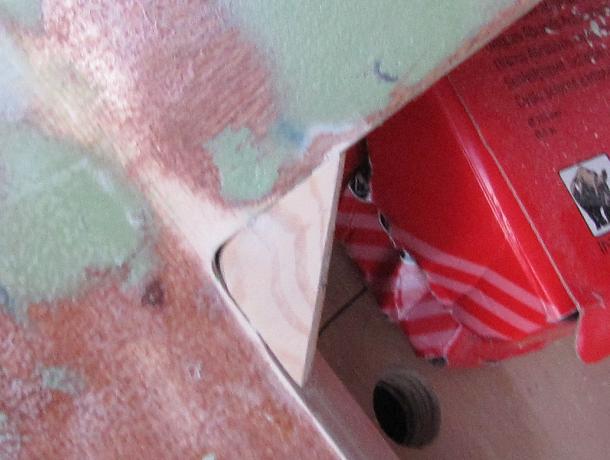

I forgot to allow for the curve of my back hatch, and when I put it in place, there was a gap at all four corners. I put these corners in, added some bondo, and all better now.

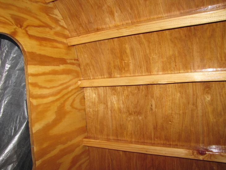

Well visible progress has slowed, but I am getting things done. I got about half the second coat of spar urethane on tonight before my shoulder started aching and it got too dark.
The inner surface of the luan got very dark with the first coat, but it still is fairly light.

Lookin good Paul! I used Helmsman's Spar Urethane from Lowes, and it definitely darkened all the wood and gave the grain greater definition. I had purchased some stain, but after testing the spar urethane on a scrap piece of wood I decided that it would be enough.
After the first coat of the spar urethane had dried completely, I sanded everything lightly using 220 grit, going with the grain. After using tack cloth to remove the sanding dust I put down 2 more coats, without sanding any more. I used satin urethane, and wasnt going for a high gloss appearance, but it still turned out extremely nicely, and I really wouldn't do it any different if I had to do it again.

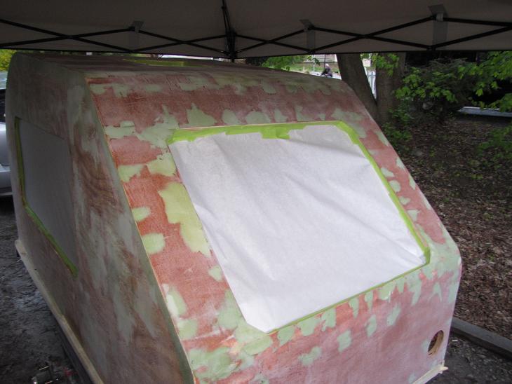

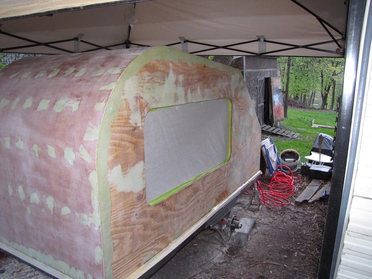

Things certainly have slowed down.. today I got the fourth coat of resin sanded. I sanded a little deeper than the first three coats, trying to get more smoothness. I've decided it will never be completely smooth unless I'm willing to do several more coats of resin and several more overall sandings. That would delay my completion by 3 or 4 weeks and I'm not that fussy about perfection.
I taped off the windows, roof vent, and the rear hatch, so it's almost completely ready for epoxy primer. I need to tape off the frame and I'll actually tape off the door and put that in place to fill the last hole. I couldn't figure out a way to do the door completely from the outside.

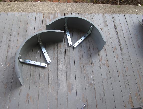

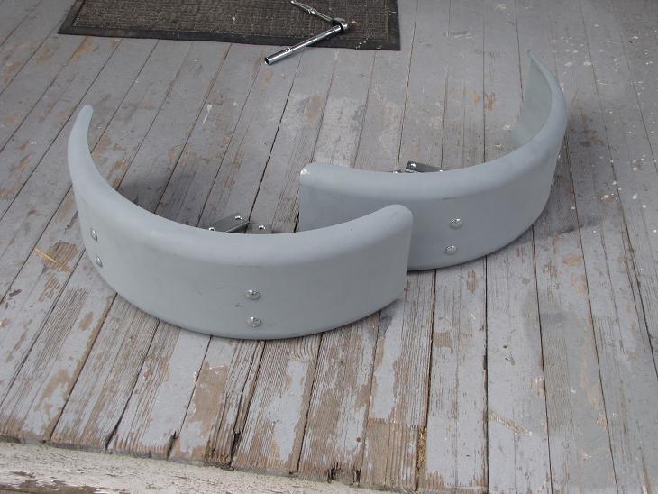

Well, I cut the brackets for my fenders and got them mounted.
And I realized that the bolts I purchased to mount them to the trailer are too short.

I finished the taping of the trailer so it's all ready for primer... except for the weather. It never made it past 55 today, and epoxy primer would take forever to dry. The can says not recommended for temperatures below 60.
I'm going to ask for Tuesday or Wednesday off, as both days will be close to 70 degrees, and that is ideal. Much warmer and all the buggies will be in the air, although I do know that a couple bugs are required in any home paint job.
:lol:
One other dumb thing I realized that I did.. I taped off my galley area with my palm sander inside, so if I decide to sand the primer coat, I'll have that to re-tape. I'm really hoping that I can just let the epoxy cure for a couple hours and put the color coat down the same day.
