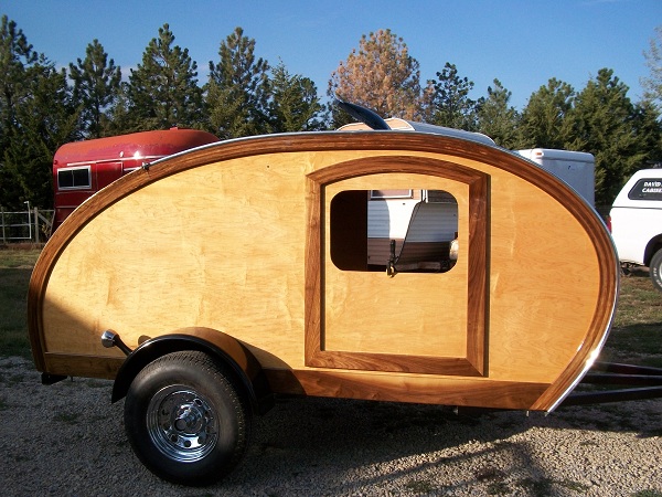

Postby kentucky bryan » Wed Aug 03, 2011 4:31 pm
Great Looking Teardrop. :thumbsup: :thumbsup:
All that polishing would drive me crazy.
Is your side cut from a single 4x8? Some how it has the look of being longer.

Postby David S » Wed Aug 03, 2011 5:27 pm
Thanks Bryan, it's a 5x10 the joint in the ply sides is at the front edges of the entry doors.the top pc of walnut covers most of the top.there will be a bottom pc of walnut and the door trim will cover the rest.I biscut jointed it and kregg screwed where they wouldn't be seen.

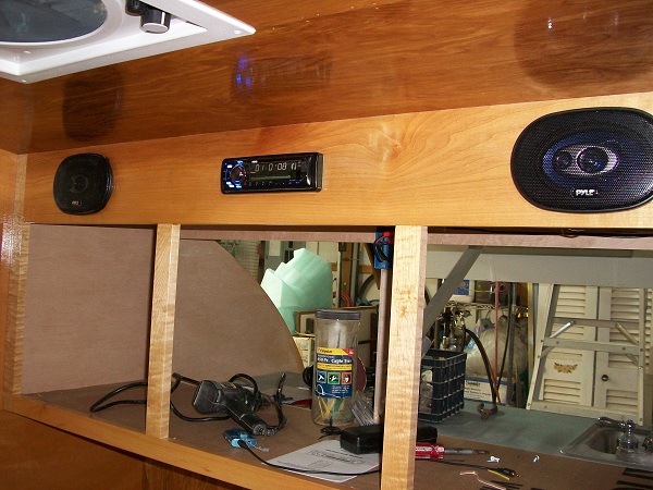

Installed the Am Fm mp3 cd stereo and speakers

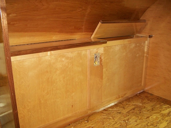

Head board cabinet installed
Stereo installed
Fantasic Fan installed

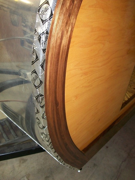

I'm not sure if anybody else dose this,but I used some aluminum tape with a sticky butyl backing on all my corners and joint ie. rock gaurd etc.I get it when I buy windows from Pella but Lowes has it with out the logo and in smaller rolls

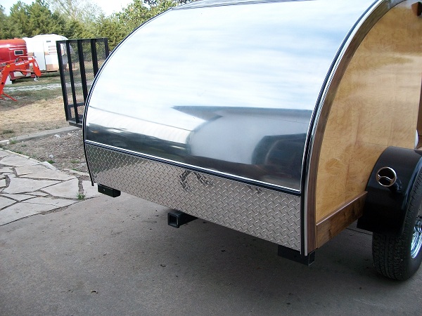

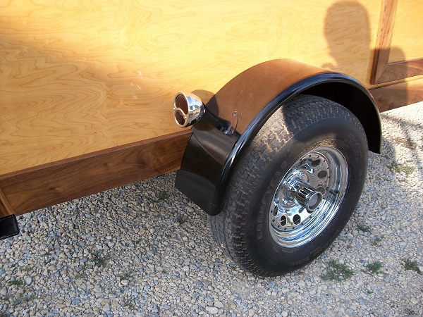

Fenders and tail lights installed
Rear rock gaurd and moldings installed

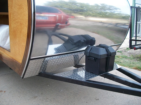

Front rock gaurd,battery deck and battery installed

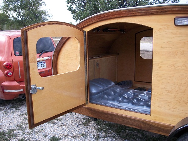

Postby David S » Mon Sep 26, 2011 9:27 am

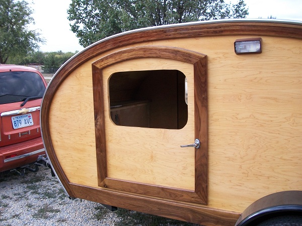

Got a little more done yesterday.Installed the doors and the door handle/locks
No that air matress is not my bed,the queen size memory foam is in there but I'm not going to cut the bag open till I get the windows in which is the next thing on the to do list.
