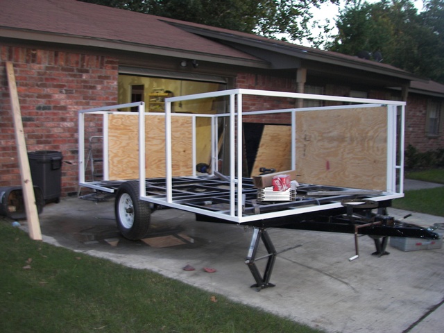

Well I wanted a small toy hauler to carry a couple of 4 wheelers in that can also be used as a camper. I thought about a cargo trailer but didn't want to do anything over 12 foot. The only way to get them both in a 12 foot trailer is to pull one in sideways and the cargo trailers weren't friendly for that.
So I decided to build my own popup toy hauler. It is like a cross between a cargo and a popup. I got a lot of inspiration from all of the posts here, especially the build by Fromeo.
I started by buying an old rotten Starcraft for parts. I tore it apart as soon as I got it.
Then I started building a new trailer.
Once I got the base frame done, I started working on integrating the popup components. I first mounted the assembly for the winch and wiffle tree.
I then started laying out the floor framework. I doubled up the square tubing where the tires would go as to keep from having any problems with the floor sagging when it is loaded.
It ended up looking like this once I got the flooring framework done. The jacks are welded on, bearings are all packed and the brakes are all adjusted.

OK We got some work done this week. Mainly getting the sides all welded up and painted.
Going to get the floors in tomorrow and then start on the walls. I have the skins so it shouldn't be too bad.

Postby Dmanrick » Sun Sep 26, 2010 3:30 pm
Thanks.
Here's this weekends progress.
I got the floor in on saturday. I think it took as long to build the wheel wells than lay the actual flooring. :)
Sunday I got most of the framework completed for the aluminum siding. I am going to go back out in a bit and try to finish all of the framework. The only thing I really have left is the gates.
I did get one small piece of siding up to see how it would look. My wife is out of town and I'm going to need help on the bigger pieces so they will have to wait.
