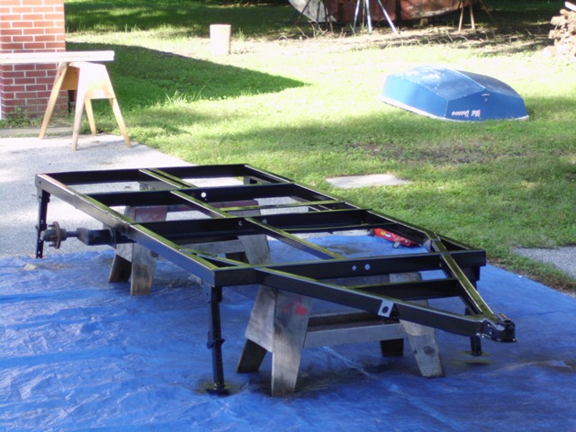

Three days of beautiful weather, and don't know how long it's going to last, so I figured I'd take a vacation day on Friday and see what I could get accomplished.
Friday morning I finished up the painting on the frame. It turned out great and is just perfect for what we want. I will be replacing the axle and maybe the tongue jack but other than that, she's good to go.

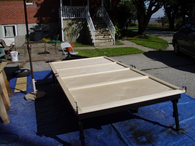

Saturday and today I worked on the floor, amid a million other distractions. If only I had a woodshop (and nothing else to do except work on the teardrop). But I don't, so the tools get dragged out of the garage as I need them and then dragged back in again. I'm hoping to find a solution to that before the bad weather gets here so I can work through the winter.
But the floor is mostly put together. After this picture was taken we dragged it into the garage and I glued it up and put the screws in. I used 1/2" Birch ply with 1x3 Poplar framing. I will insulate with the 3/4" pink stuff. I am closing up the bottom with 1/8" birch ply, covered with a layer of fiberglass cloth and epoxy resin and then the black goo. That should close it all up tight, protect the insulation from the road junk and make it nice and waterproof.

Postby aggie79 » Tue Oct 11, 2011 8:38 am
Becky,
You are already moving at a much faster pace than I am. Plus, it looks like you know what you are doing!
Great beginnings on your new teardrop. Keep the sawdust coming!
