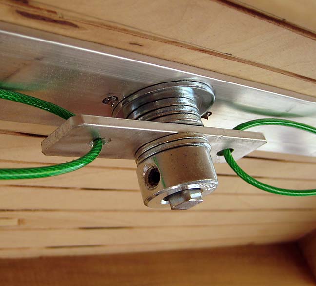

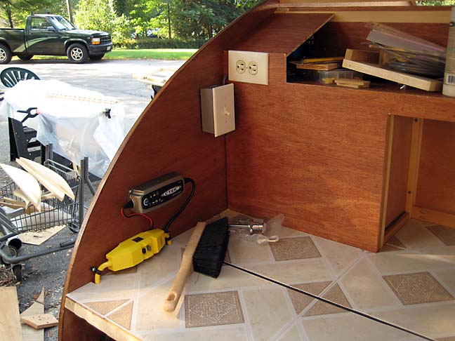

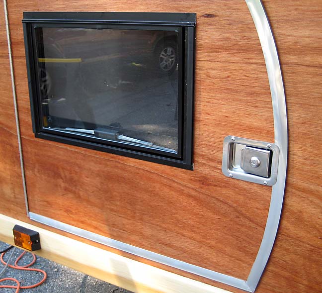

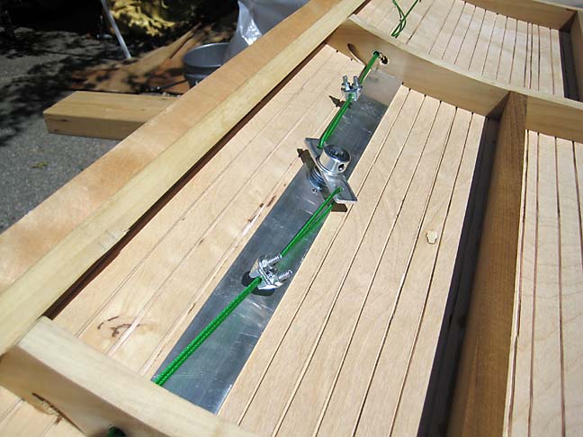

Drilled holes for hatch side latches and install with coated wire to not-yet-installed handle.

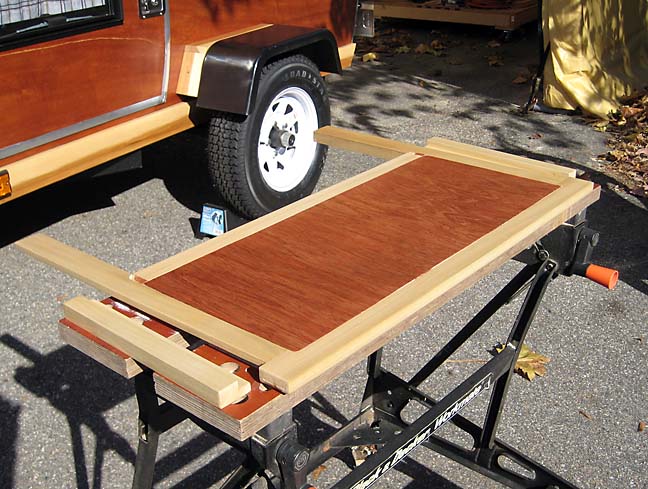

Cut kerfs in birch inside ply of 1/4in luan for hatch and dry fitted again to draw where inside ribs can be screwed into when glued.
Attached living hinges to countertop hatch doors via #4 wood screws and put floor tiles on countertop – had to diddle with ring pull cutouts in linoleum tile so they were flush.
Re-dry fitted the hatch frame with the linoleum in place and determined it did not affect the fit.

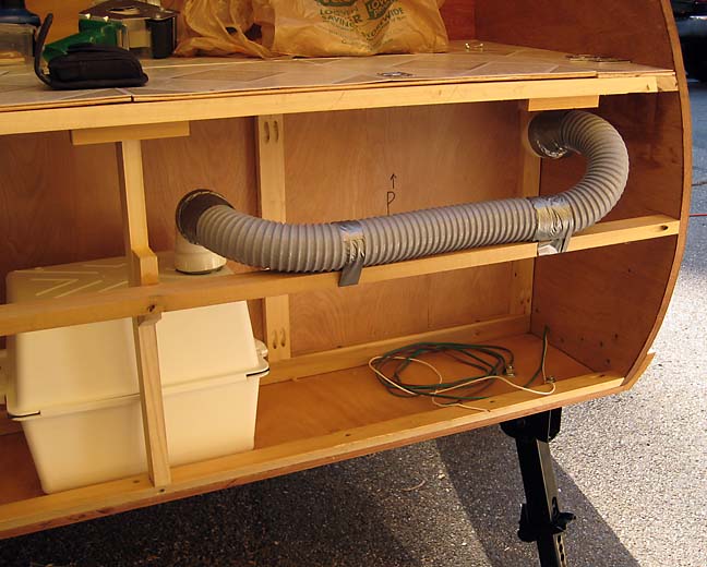

Cool fall weather has arrived. Used duct tape to attach two 90 degree PVC pipe elbows and flexible tubing to the battery box and exhaust port, so the tubing is out of the way, which I later replaced with cable ties.

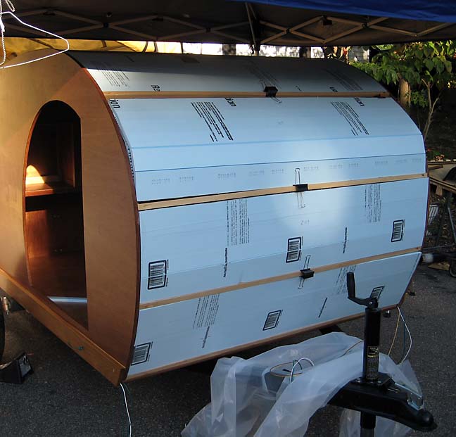

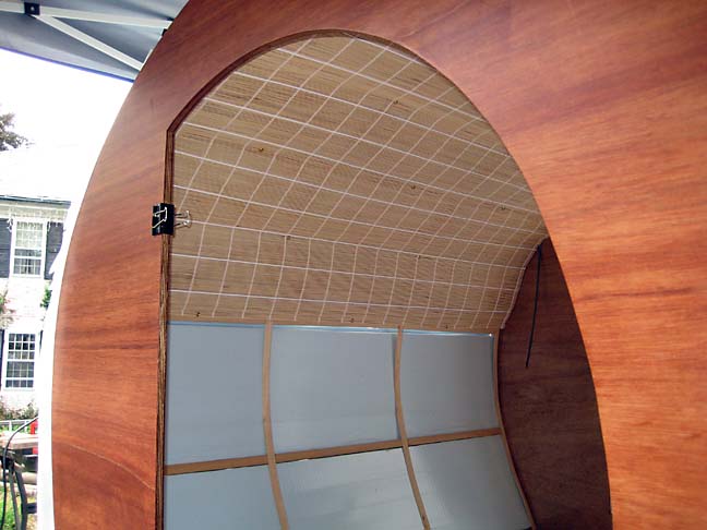

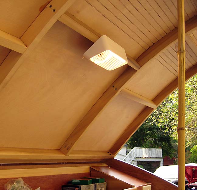

Cut out and fitted roof foam insulation. Binder clips on joists are to keep insulation in place until roof is put on.

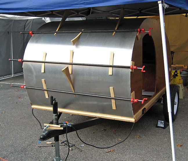

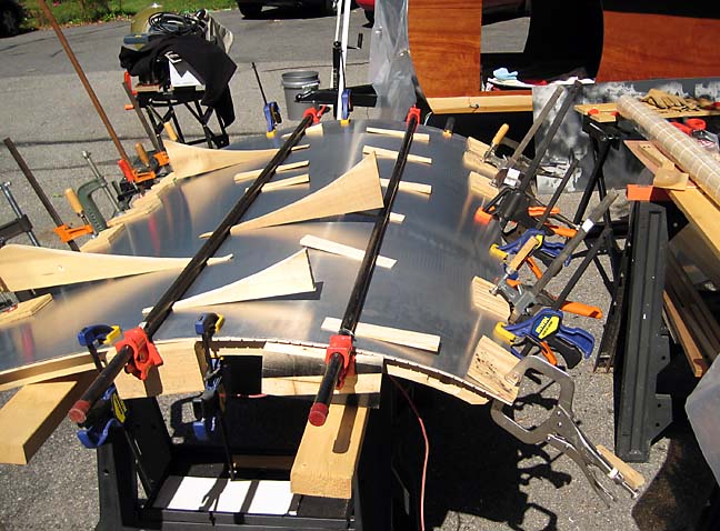

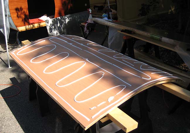

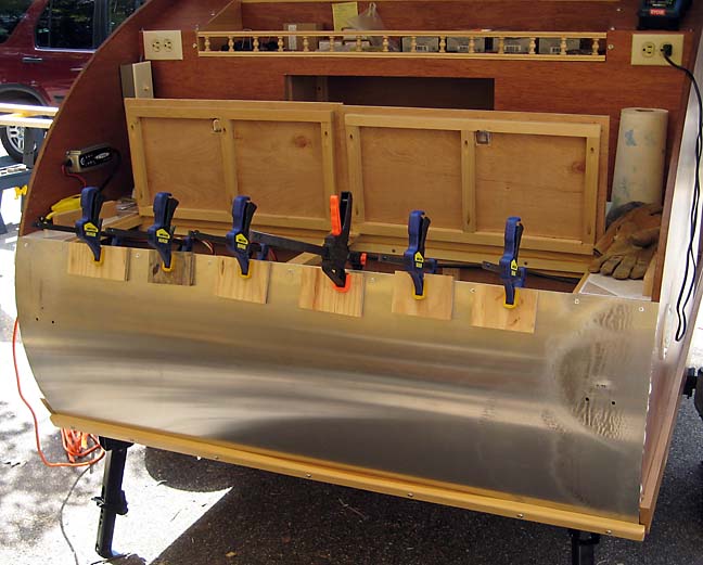

Ran kitchen light wiring inside of hatch. Glued and clamped aluminum skin to kitchen hatch.

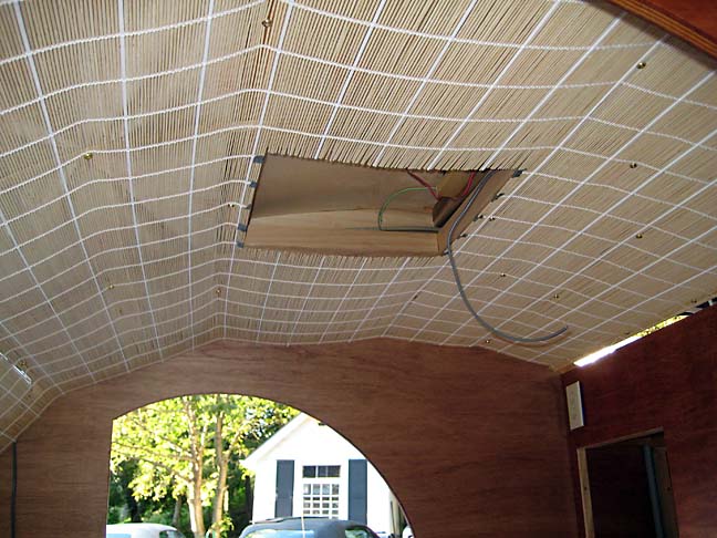

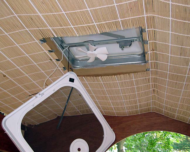

Cut and attached bamboo rollup blinds to interior ceiling

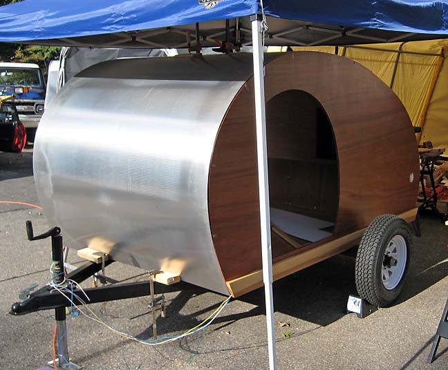

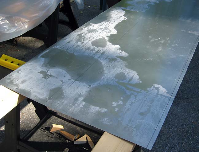

Unpacked aluminum on pallet and discovered it had white stains or corrosion marks on it from sitting inside of wet cardboard :thumbdown:
A call to the company I bought the aluminum from and some web research revealed I had stored it improperly. Luckily the back side of each piece was salvageable, only have marks from the wet cardboard on them.
Removed clamps from hatch aluminum skin, drilled holes in aluminum skin for latch and mounted T handle latch mechanism.

Used Dremel tool to cut out bamboo ceiling for vent opening, and used pieces of duct tape to keep it the thread/binding from unravelling (they'll be covered by the vent facia)
Cut and attached piece of plastic corrugated panel below bamboo ceiling at “headâ€

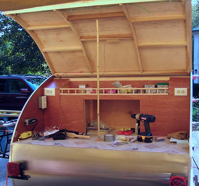

Days 42 & 43
Postby jonw » Thu Nov 10, 2011 7:52 pm

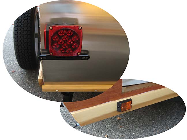

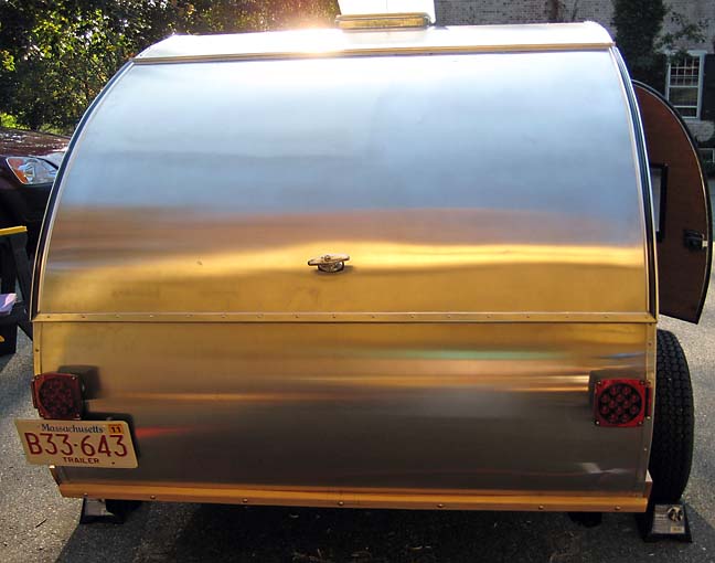

Cut holes in rear section aluminum for tail lights and for wood trim at bottom (and row of countersunk flush screws at top), then glued and screwed rear section aluminum on. You can see how stained the aluminum is on the right side...
Dry fitted roof aluminum and cut out hole for vent. Also trimmed end and side to fit. Stapled several front foam panels to roof ribs to keep them from constantly falling down. Clamped roof aluminum until able to glue it so bend would be pre-formed. You can see horizontal lines in the aluminum from the cardboard corrugation
Attached LED tail and side running lights, wired them up and tested them

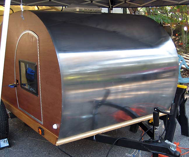

Worked on hatch aluminum stains with auto and then metal polishes and Porter Cable dual action orbital polisher. Very messy but some improvement on the rear panel, as you can see in the above picture. Decided I needed something more industrial, so I ordered some Nuvite and bought a rotary polisher next trip to Harbor Freight.

Glued and (temporary) screwed aluminum roof/front piece using GE Silicone II caulk instead of construction adhesive.
Attached roof vent and wired the it’s 12V fan. Also attached molding along hatch wall and rear sections.

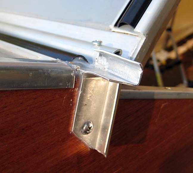

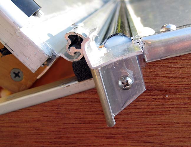

Attached the hatch to the body via the hurricane hinge. Attached striker plates to inside of kitchen area for hatch latch to lock into
Discovered the hurricane hinge puts ¼in space at top of hatch, which changes the way the bottom of the hatch frame rested on the counter top. It wouldn’t close. Had to plane and sand off approx. 1/4in off the hatch frame footer piece to get it to close. Doh!

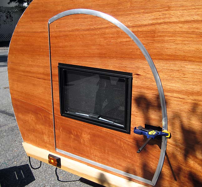

Attached door hinge and put trim around door openingss and cut T molding for one door
Attached T molding to door and put door on hinge. Dry fit closed and everything looks good
With Bobs help attached passenger door hinge to body, T molding to door, and attached door to body via hinge.

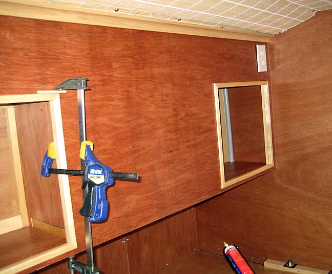

Attached finish molding to bedroom cabinet openings, and kitchen wall cabinet joints

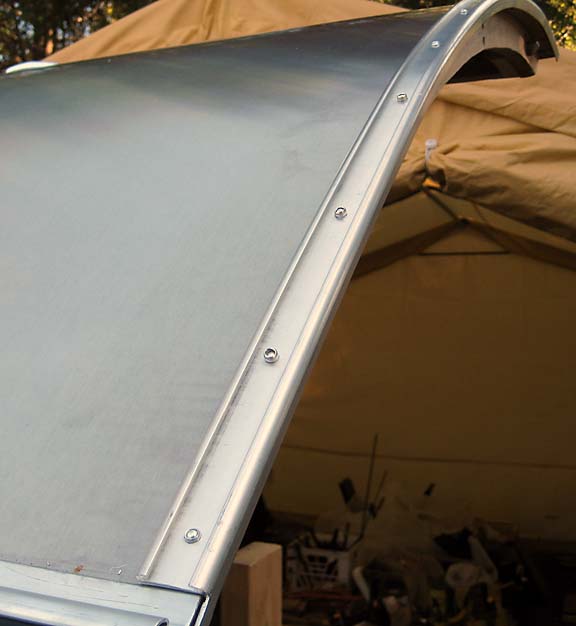

Postby jonw » Thu Nov 10, 2011 8:07 pm
Polished aluminum front/roof (forward of vent) using Nuvite system. Very messy and took a while to get the hang of it, but it did work. Did NOT use polish to make it shiny like an airstream (at least yet)

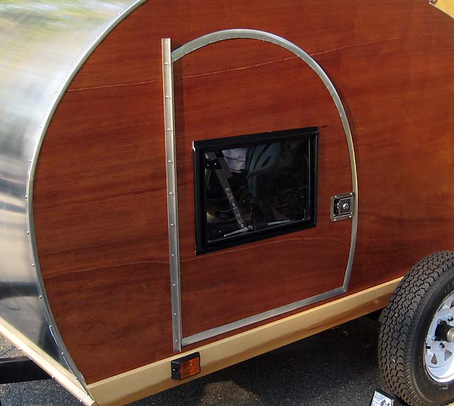

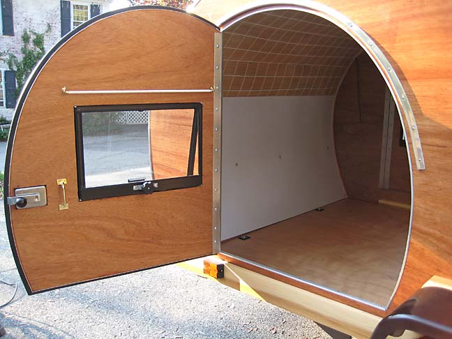

Made custom gaskets from rubberized shelf liner for each door latch. Installed door latches and weatherstripping on both doors. Both latches are keyed the same – yeah!
Attached vertical drip moulding in front of hinges for both doors

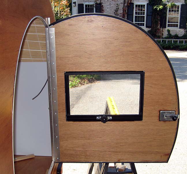

Drilled holes and dry fit roof/wall moulding for both walls. Picture above shows it being dry fit - screwed in all the way around sans any caulking

Spent the weekend in it at the music festival and realized I needed to do a few more things, like adding door pull handles to make closing the door easier, and curtain rods for some privacy. Here you can also see the screen molding along the bamboo-wall edge that helps the flexible bamboo follow the profile and keep from sagging

I hadn't followed Grants instructions on letting the body portion of the hatch hinge stick out over the side because I didn't understand it. Now I do, so I used some leftover drip molding to fabricate some hinge water diverters
Notice also the piece of weatherstripping i put in the gap in the hatch hinge (remember that 1/4in?)

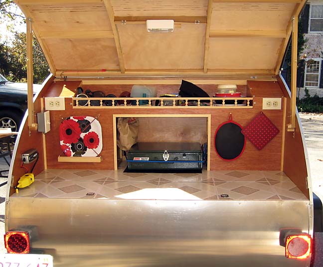

I needed something to hold the hatch open and I was not enthralled with using gas struts, nor had I seen anything on the forum that I liked. I had been using a dowel with chair leg bumpers on both ends but the wind blew the hatch and the dowel collapsed and nearly went through the bedroom wall. So I designed this simple system that works great:
Here's a picture of the finished kitchen area as we used it on a mid-October weekend campout nearby

Postby sagebrush » Thu Nov 10, 2011 9:51 pm
:thumbsup: Great trailer!!!!!!!! :applause: Like your hatch latches.

Since each build has its own interesting details, I especially like your hatch
handle/lock and the hatch supports with the stow clips. But I was curious if
they are" secured" when in the opened position, so the hatch can't get
blown further upwards by a wind gust, since that is what prompted you to
change to the new 'secured for travel' supports. I really couldn't tell by
the pic.
