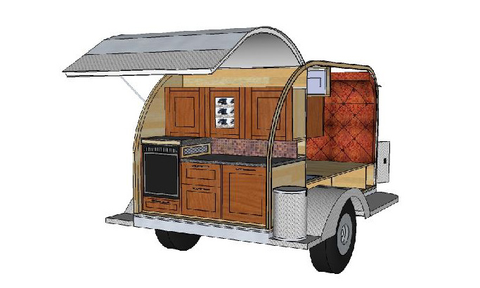

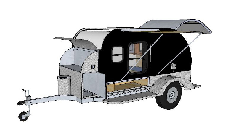

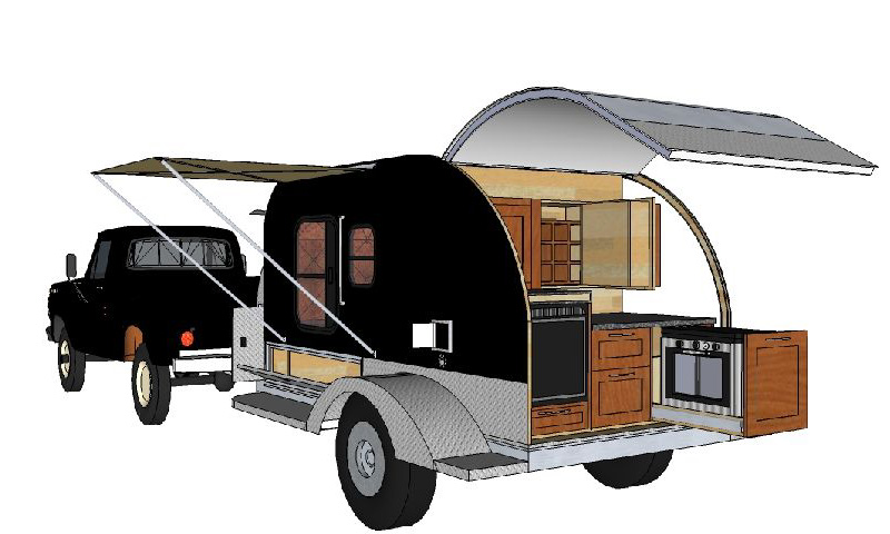

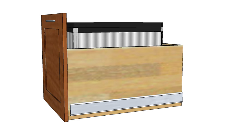

Here is the latest Google sketch-up pics:
We have already made some progress. The chassis, front box ,and hatches have been ordered from a specialty metal shop. We hope they will be ready soon. We have a room full of bits and pieces ordered online. There is a stack of 1/8 inch 5x5 Baltic plywood in the garage, and we already have started cutting the 5x10 plywood to form the sides.

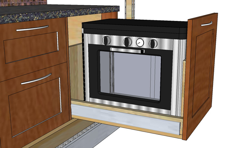

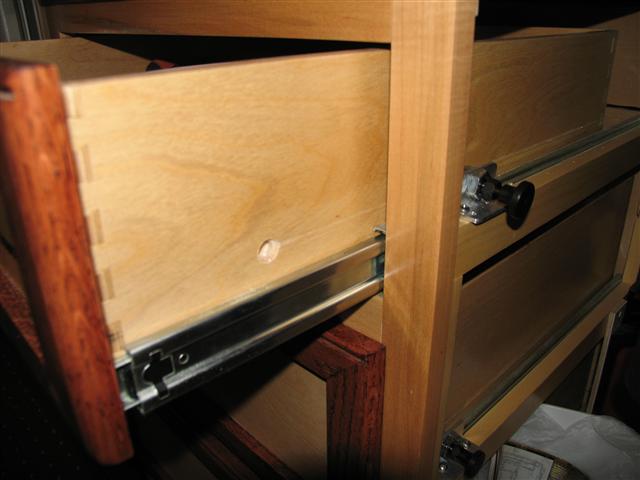

I was thinking of a similar drawer arrangement for a camp chef, are you putting a latch or other mechanism to secure the drawer in the open position?
Kharn
Posts: 655
Reply to Kharn's question.
Postby Elizabeth C. » Sun Dec 18, 2011 10:05 am
Good question. I wish I had an answer. I know some drawer slides have automatic stays that will stay open until pushed closed, however the slides I have purchase don't have that feature . I am open to any suggestions. Here is a more detailed picture of my drawer plan.

A simple barrel bolt should suffice for locking your stove shelf in the out position.

Elizabeth C. wrote:Good question. I wish I had an answer. I know some drawer slides have automatic stays that will stay open until pushed closed, however the slides I have purchase don't have that feature . I am open to any suggestions. Here is a more detailed picture of my drawer plan.
I would want something more secure than just push-to-close slides, the biggest concern is if the impact (somebody trips or whatever) pushes the drawer closed with lit top burners. Maybe mount a dovetail on the wood back panel, with the mating piece being large enough to go past the drawer opening?
Kharn
Posts: 655
Postby bdosborn » Mon Dec 19, 2011 5:49 pm
I used a retractable spring plunger to hold my drawers closed but it could be used to keep them open too:
Or a barrel bolt as Gus suggested would work just as well.
Hidden Drawer Latch

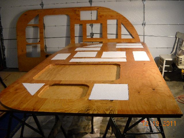

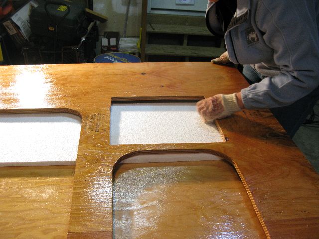

Well, we had one of those days. Yesterday we used West system epoxy to seal the walls sections and the floor. Today we had planned to insulate, start glueing on the baltic birch and cut the bulkhead and upper floor.

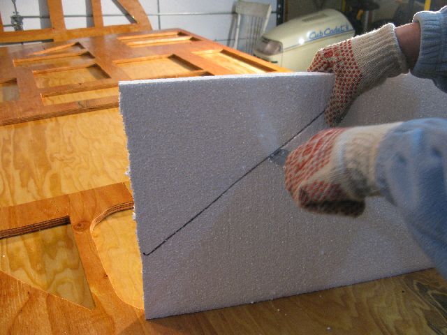

In good spirits we started out cutting the styrofoam.
Marking the foam.
Cuttin' the foam.
Foam is doam, I mean done. :)

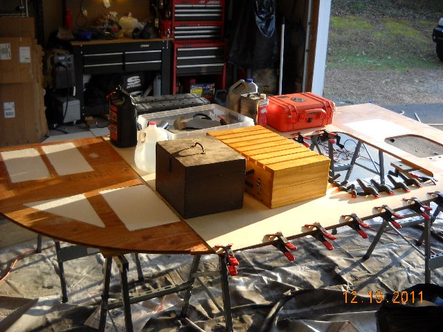

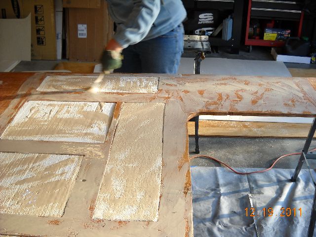

Next step of trailer build; skinning inner side of walls.I trimmed a panel of 1/8" baltic birch roughly to size, then we spread a goodly amount of Titebond III on the wall and placed the first panel. Then the clamps!!! (And anything heavy we could find in the garage.)
When it dries I will use a flush trimmer to cut it perfectly to size. I trimmed the panel for the front , and then the back. Then we realized the back panel was bad side out. Argggg. :x . At least we can still use it on the other side.
