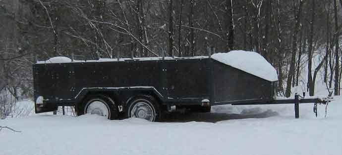

Well bought this thing a few years ago
When I got laid off this fall I got bored...bet you all heard that one before
And I came up with this idea

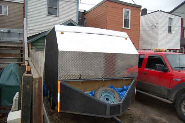

and then the fun began. Working outside in the snow and blow and balmy January we're have. So far I framed up off the 24 inch sides and skinned with 3/8 ply. I then cut crowned rafters from 2x4's at 16" OC and skinned the roof in 3/8 ply.
Roof was the covered with White TPO rv roofing material and trimmed out around with Aluminum insert trim.

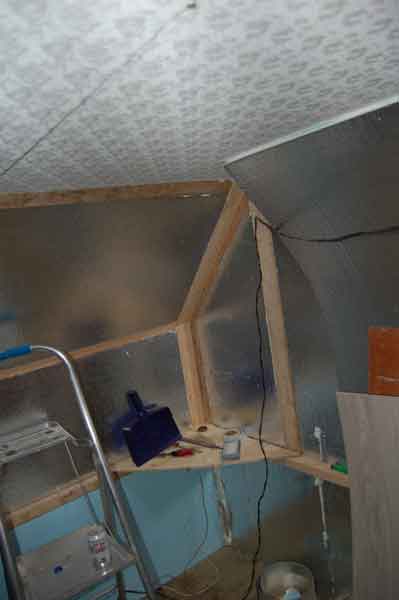

Insulation is 2" SM in the roof and 1 1/2 foil coated foamboard in the walls.
Floor will be insulated from beneath with 2" SM

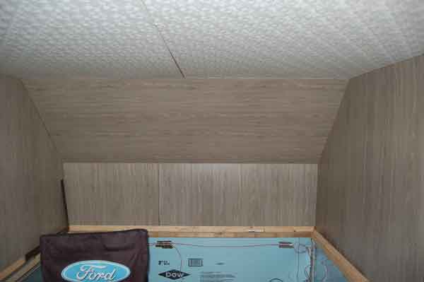

Paneling started going up today
More pics tomorrow
The build I'm after is a dual purpose trailer

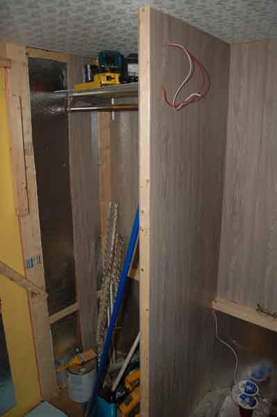

Closet built last night. had this cool aluminum coat rack/shelf from a greyhound, been in storage for 20 years, found a use
Insuation is all foil tapes and spray foan in any and all gaps

Postby Martiangod » Wed Jan 11, 2012 6:26 am
Got the flooring in and picked up a few things, clearance lights, licence light and such, wired in and installed interior light.
A warranty out thermo glass window, heavier, but warmer and no condensation
May regret it but went with a fiberlass backed lino. Supposed to resist rot and mildew, we'll see how easy it tears...lol
Got some more paneling up then got called for a few days work...oh well, trailer on hold for a few
This is prooving to be more spendy then anticipated....lol

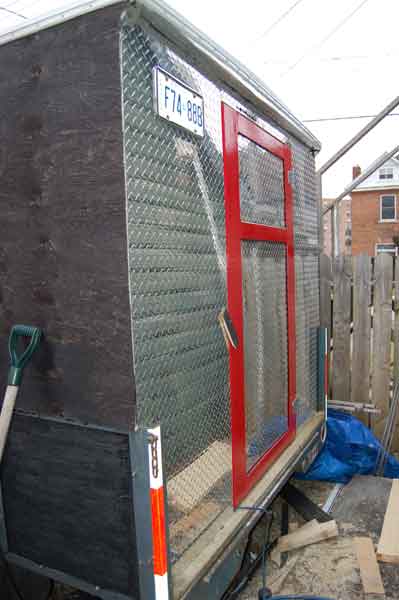

Pics to follow, got the rear clearance lights and licence light installed on the weekend, finished my upper walls, ran some more wire and installed a threshold and weather strip on door, window installed, but moved it back from my photochop picture, bin in the minus 20's so its nice to be inside the warm trailer. Going to rewire the low mount licence light as a entry step light, no point waisting already installed features...lol

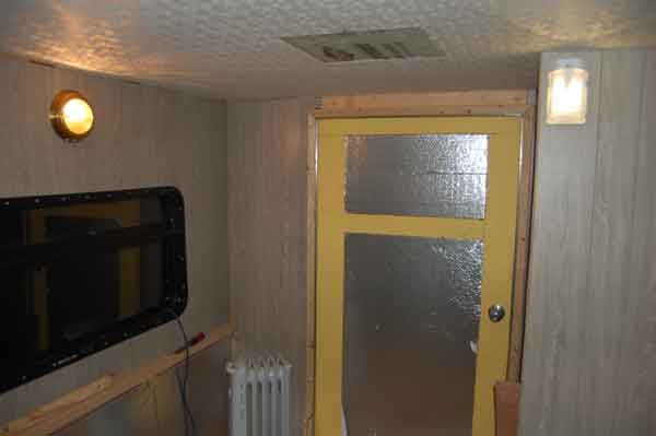

Postby Martiangod » Wed Jan 18, 2012 5:42 pm
Stopped at habitat for humanity store on way home tonight, got a 60ft roll of schluter Kerdi mebrane for $20, going to do a test piece tonight,glue to plywood and then paint, if works out going to try a painted fabric technique, if dont work well, will have nice waterproof mebrane under my aluminum :)
Schluter-KERDI is a bonded waterproof membrane with limited crack-bridging capabilities. It is made of soft polyethylene, which is covered on both sides with a special fleece webbing to anchor the membrane

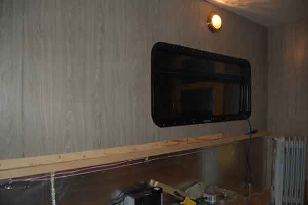

Got the dual pane awning style window installed, installed low for sitting hight, its 48" x 18"
And got the paneling installed above the waisteband,
Also have the two interior lights I'm going to have installed and wired

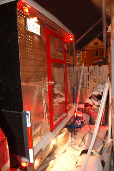

Front clearance lights
Rear clearance and licence light
just need to rewire the old licence light and put it on a switch, it will become the step/entry light.

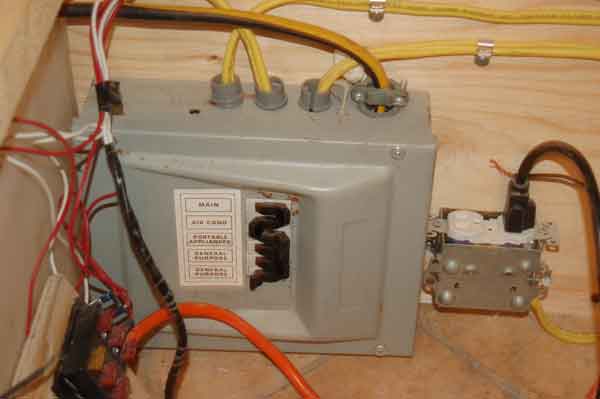

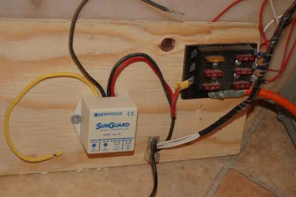

Got my AC breaker panel installed and wireing run, 12 volt spade fuse strip, mounted my solar controller, mounted 40 gallon water tank and started building gaucho/ 54" size bed.

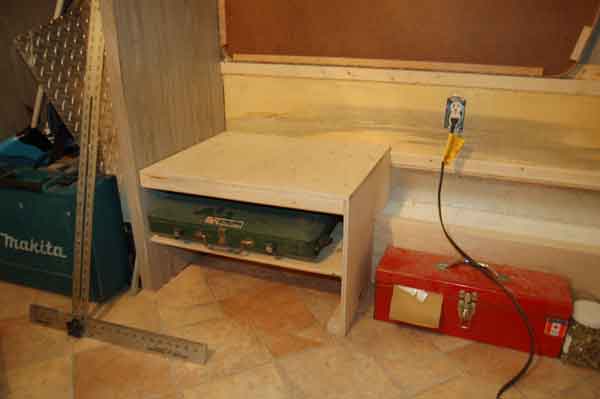

Postby Martiangod » Mon Jan 23, 2012 8:11 pm

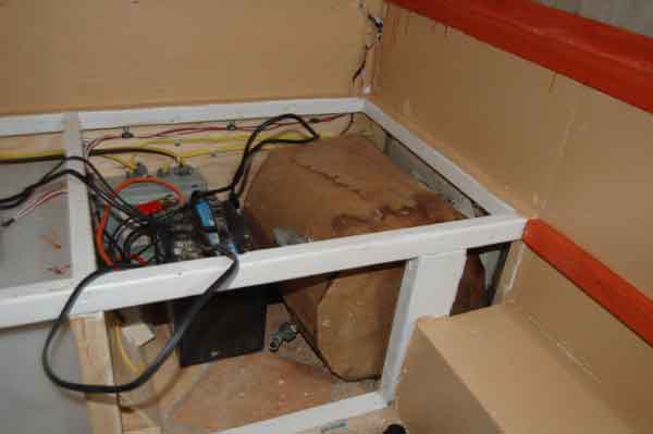

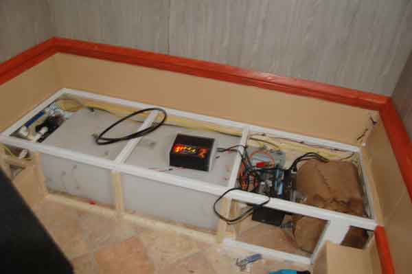

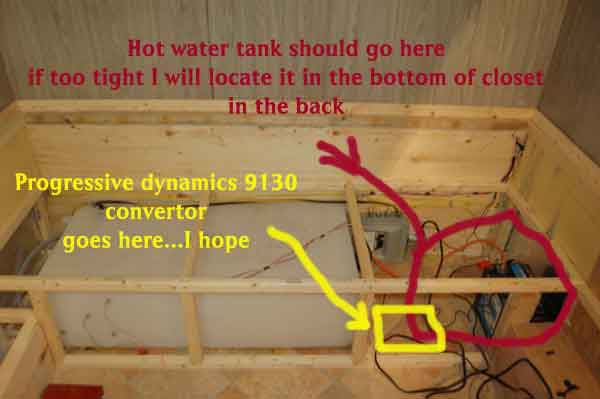

Well gettin there slowly

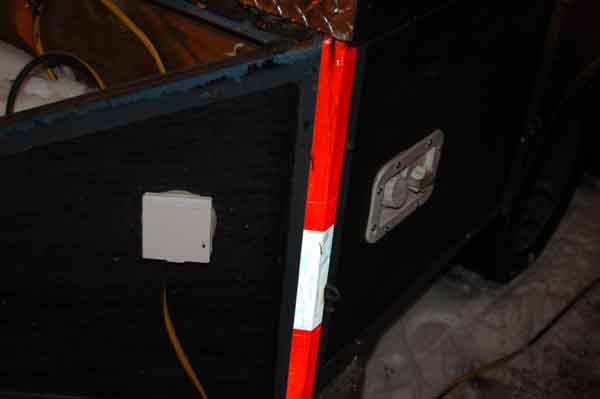

Electrical sort of done, still have to locate batteries to tounge box
AC Panel and plug for converter when I find one
DC strip and Solar controller fused will also wire charge line from truck to fuse strip

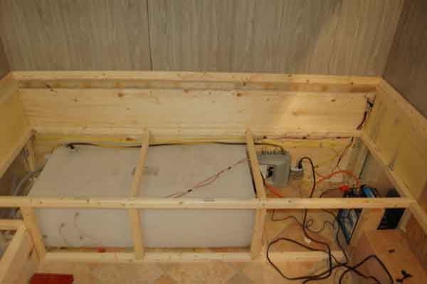

Water tank in, still need to strap it down and find my spare ShurFlow

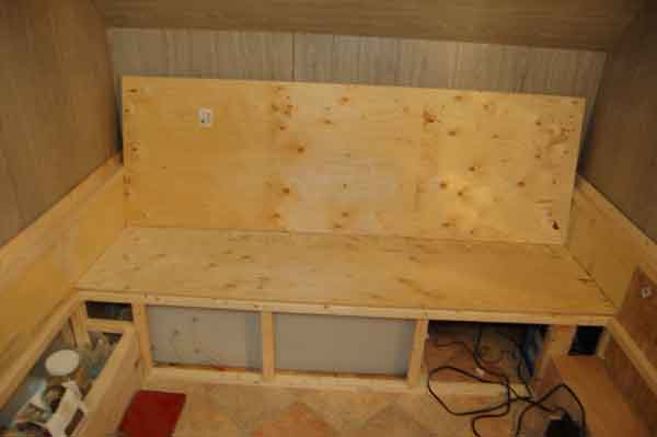

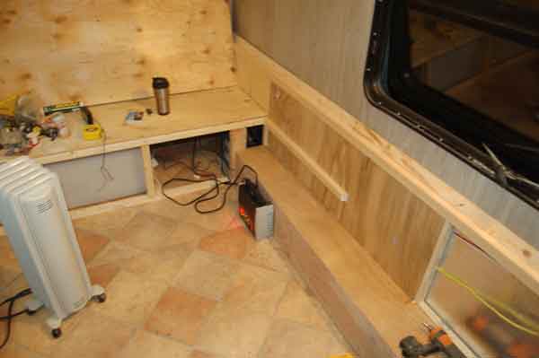

Gaucho framed
In Bed Mode, will be 54 x 74 double
Fenders framed and skinned

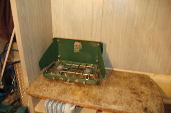

Kiitchen...lol base, will house coleman for when we are dry camping and single burner Fridgidair induction cooktop for when we have trees to plug into and some sort of container storage for utensils
this is same hight as bed so with 1 extra ply i can level out the trailer for utility trailer mode
ImageFold down counter for stuff, or cooking in inclemet weather
will do some sort of backsplash i guess

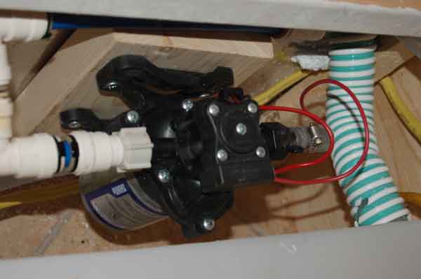

Postby Martiangod » Wed Jan 25, 2012 6:52 pm
Went up to my park trailer storage shed to see what parts i had stashed, picked up my spare water heater and I had 2 sure flows :twisted:
IT FIT...yay, mechanicals going in
Hot water tank fit :)
Its an older Atwood 6 gal i rebuilt, new gas control and preasure valve
Few stains on cardboard but its all good, will build styro cube around it so no biggy
City water, tank fill and cable hatch installed
And pump in and plumbed to tank and city water, just need some more PEX to get over to the Hot Water Tank
Mechanical rooms gettin a little crowded...lol
Still have to run gas line to front compartment and wire pump switch and all that other stuff
And with the second shurflo, I'm thinkin computerfan and shurflo thermostat controled pumping hot water through a heater core for a car for my heating system, that way I don't need to source a furnace or loose more room to a furnace

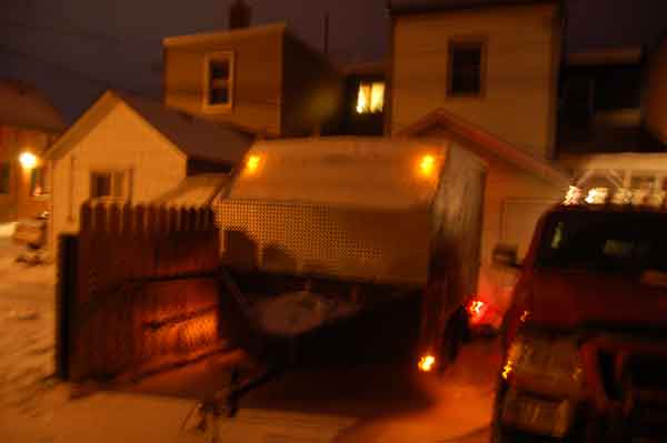

Postby Martiangod » Thu Jan 26, 2012 11:43 am
Weather is my biggest enemy right now, gettin lots done inside but can't do much outside, although for working in the snow, its been a great winter so far.

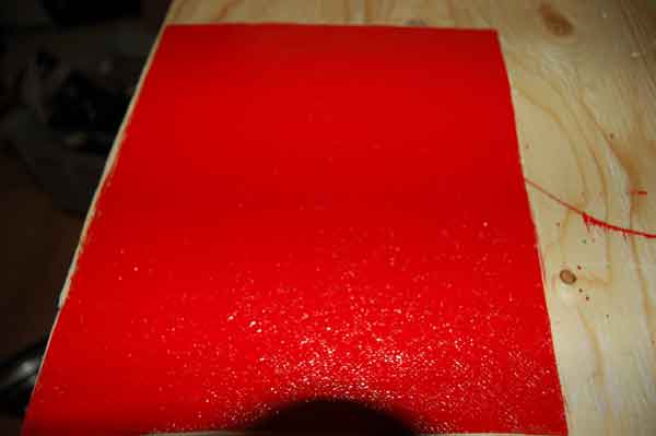

My test pieces with the Kerdi were sort of a fail no fail.
Love the texture when its painted, test piece with water based flooring adhesive bubbled.
Test piece with spray on 3M contact ahesive bubbled initially but with rolling out for an hour or so it stuck excellent
Painted with oil base rustolium paint, finish is just what I want. Bonus would be the Kerdi is 100% waterproof.
SO I'm still out on what to side it with
But its funny how these things can morph into somthing else.
I started out with a cross between a cargo trailer that could be used as a wooden tent on weekends,,,:)
But the colors and interior inside its morphing into more of a CAMPER/ utility trailer.
If I can come up with the right texture on the exterior, lightly pebbled, paint a pueblo sandy color with a little red to appease my
everything must match mentality,,,IE: red truck...I'm thinking the exterior may end up more like this.
Now all I need is $$$ some tru spoke wheels and air bags for slammin it when I pull into the park...lol
