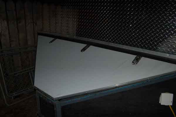

Postby Martiangod » Fri Feb 03, 2012 7:41 pm
Well the weathergods have been with me on this one.
Got a bit done today and yesterday.

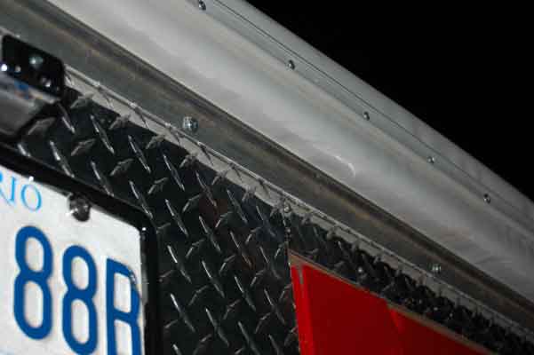

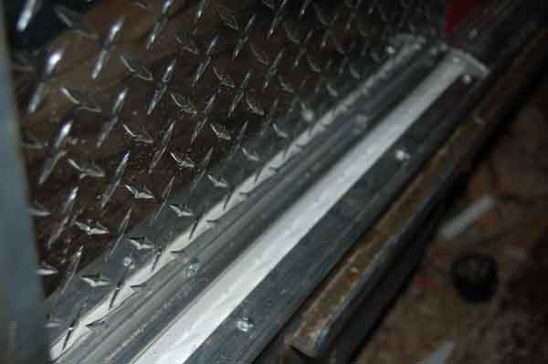

Got the rear overhang dressed with some leftover roof and aluminum trim and it was above freezing so I got it caulked also
The floor extends past the back wall and has caused me some grief with snow sitting on it and melting....hence a bit of soak through. So dressed it also with some left over TPO roof and some more trim, all caulked so that issue should be dealt with
Can't afford another sheet of diamond plate right now ( no paying worky sucks ) for the front compartment, so....You guessed it, some more left over Roof some aluminum panel cap for the edge and viola...
The weather seal on the seam is Slide out seals for a power slide on a trailer and the aluminum is awning rail

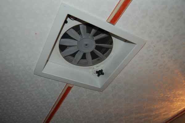

Fantastic fan in, caulked with Dicor and wired
And my groovy switch panel and Battery level box above the door
Don't think thats gonn stay though, thinking a panel the width of the door with the switchs, battery level meter, Barometer and Humidity gauge and a thermometer, " MAYBE " a clock

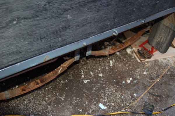

Postby Martiangod » Sun Feb 05, 2012 4:45 pm
Its flying....

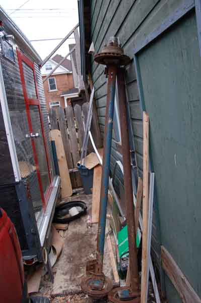

Trailer doesn't have brakes so that was on the list.
Don't know who built it but they made the axels and used bolt on hubs, probably from a car or pickup. SO...No brake flange.
SO pulled the axels today and going down to Cerka Trailers in Milton ON sometime this week and ordering a set of Dexter Axels, 1/w brake, 1 idler. Still undecided between 2200s or 3500's. Might as well put new springs on while I'm at it, It is going to be crossing the country Loaded after all.
Good thing I pulled things though, had a bad bearing on one anyhow
The old axels have a 3 inch drop, but I think i'm going with straight axels, Will probably be doing some rough country camping once I make the move to Alberta and that should also give me room for a holding tank below floor, I have a 32 gallon tank on hand so that should work for both Grey and Black.
Got it Jacked up to close to what should be ride hight and the 45 ' break on the nose of the trailer is about level with the top on my cap on the truck, so its all good
Whoever built this thing didn't plan on it falling apart, all the nuts where welded to the threads :cry:

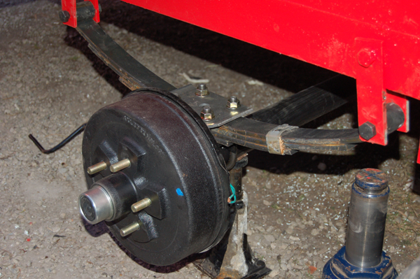

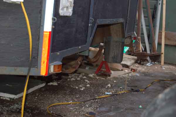

Postby Martiangod » Thu Feb 09, 2012 11:04 pm
The trailer has landed
Back on her feet again
New Dexter 3500lb Axels with ezee lube hubs, Idler on the rear axel, 10" brakes on front and new springs.
Tires look really funny now, hopeing I have room for 15"'s but thats gonna have to waite for a while.
Ordered on Tuesday, They had to be built to my frame specs
Picked them up today at 1;30 today, 2.5 hour drive home, Installed and wheels back on it by 6;30 and sitting at the dinner table, mmmmm Pasta!
Have to wire the brakes tomorrow.
Sized it up for a below floor and insulation install of the black holding tank, should be no trouble at all. And thinking of a full width pass through storage box ahead of the wheels. Its high but it opens up some new possibilities and still be able to make it off roadable
Feel better now with some stopping power for the long haul loaded out west in the fall

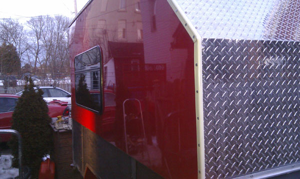

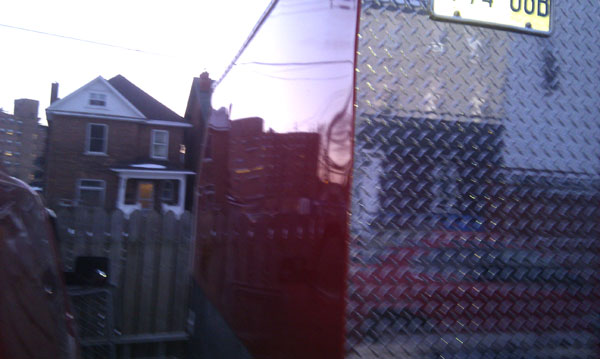

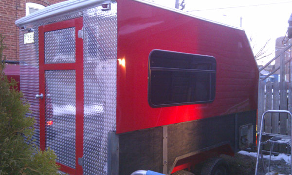

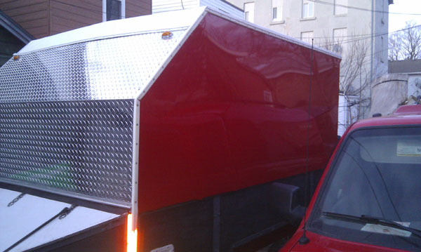

Postby Martiangod » Fri Feb 17, 2012 7:00 pm

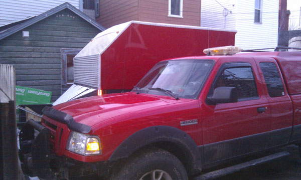

Well picked up the Aluminum yesterday at 4;30 after setting up the London RV Show display, 1 1/2 days of polishing new trailers, what a joy.
3 hour drive home...glad thats over
So it wasn't a bad day today got up to 36 degrees, whoo hoo, outside work
Had to move the trailer so I could get to both sides, was up against the fence. Settles a little into some depressions, pulled it out by hand, spun it and shoved her sideways in the drive, must have been all that Wax on, Wax off that got me in fine Karate Kid physical condition
them 4 x 10's were fun, little windy and by myself, but I persevered,
rigged up some bottom supports and had some 2x2' and 2 1/2 screws for quick preasure supports to the sides to keep the wind from blowin me and the aluminum away
Color is pretty close to the truck, which makes me happy
Front corner trimmed, think i'm going to change out the white rv trim for1 x 1 aluminum angle when I get back to work
Have to get some corners for the back yet
Love the red to checkerplate contrast
And got the window cut, installed and caulked
Need to find a small window for the roadside also
