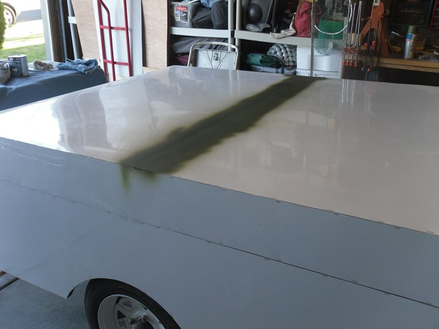

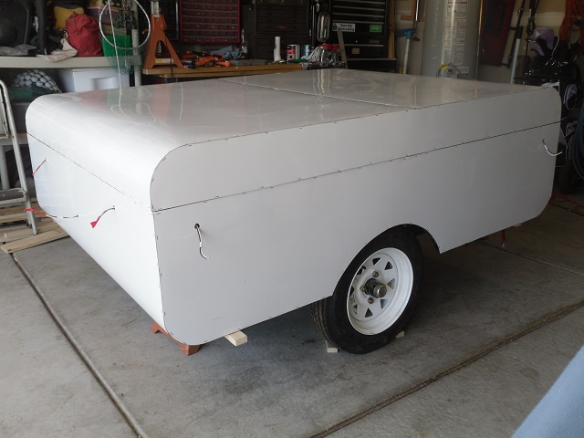

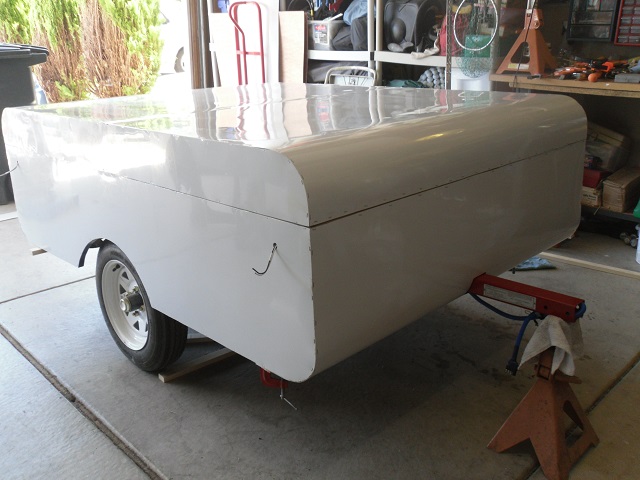

Thanks for the kudos, Karen. it's coming along nicely. I finnish the aluminum soon then paint. I'm excited to see it painted. I think it will be great behind our little subaru sedan also. We'd take along a shade tent for storage, eating, whatever, but sleep in the Kustom Klamshell. Towing with the bike we'll just have to limit the "stuff" to neccessities. Ultra light weight chairs, stoves, kitchen supplies, etc. I may have to explore trailer brakes if it really pushes the bike.
