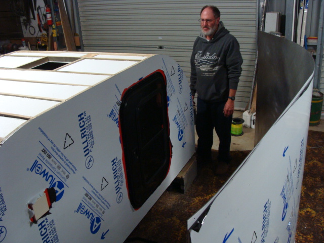

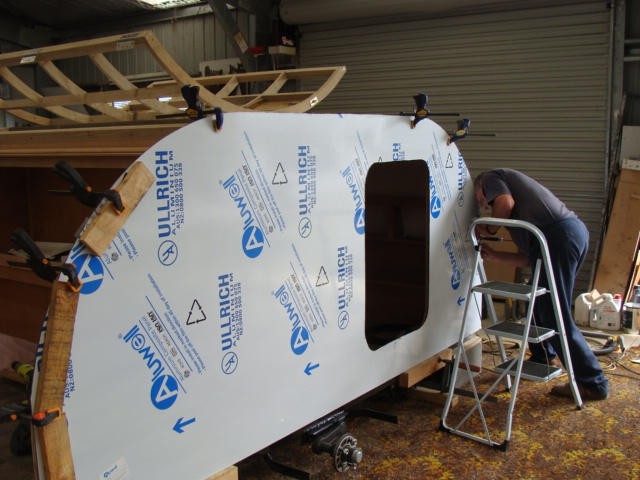

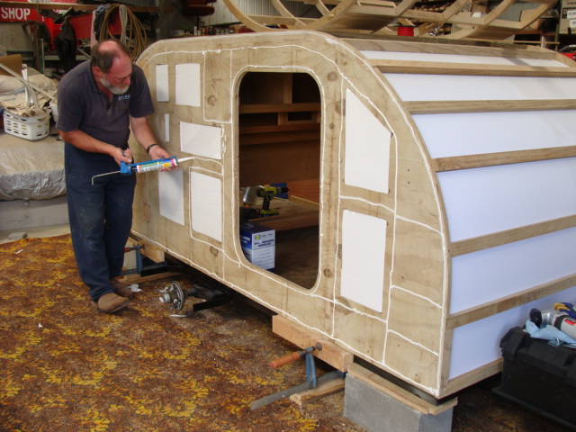

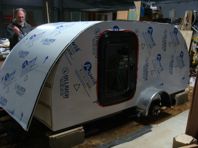

Day 60: 16 Sept. 2012.

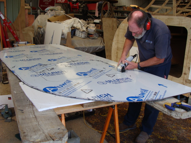

Today we are cladding the sides.
The ply has been sanded and the poly is flush with the ply.
Cladding has been cut to shape and now I am cutting out the hole for the door. Then we will remove the protective vinyl coating from the inside, and alcohol wipe, :wine: before gluing to the ply.
Applying the glue. It is a combination glue and sealer.
Sides on and the clamps are going around the outside edge. The door will be screwed in to place, it is an ideal way to clamp that area. Then make sure I have enough clamps around the outer edge and check there is plenty of glue oozing out around the edges. I want this well sealed with no chance of water getting in anywhere. The screws around the door are the only mechanical attachment on the side panels at this stage. Even when we are finished the only other screws in the sides will be for lights and vents etc.

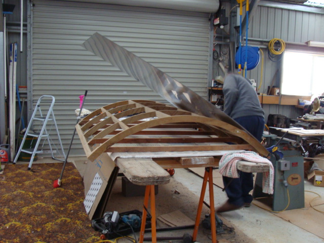

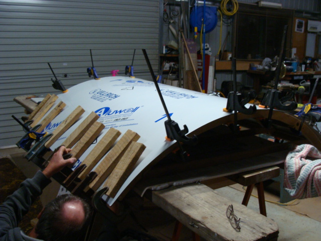

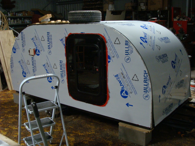

The roof goes on.
The insulation is in, and the necessary wiring done. The roof panel has been on for a trial fit and screwed down then taken off again for gluing. The panel we have used for the roof is the same as the walls. It is an aluminium composite sign board, white on top mill on the bottom. We were able to get a 1.5m (5ft) x 4.8m (15' 9"), which was long enough to go all the way over the roof and hatch with only a small offcut. That length was b#%&h to transport and handle, but once we had cut off the part for the hatch, it was still a b#%&h. We applied the glue to the top of the walls and across the spars and carefully lifted it into place, and with the curve now in it wasn't any easer.
Image The worried look :NC
Starting in the centre I worked back, then forward screwing it down. That stuff is really good to work with and fits around the curves with ease. I would definitely use it again, and when you pull the protective coating off, it is all painted and ready to go.
Lots of extra clamps across the back, to hold it down between the screws until the glue sets.
The wheel is on the roof for a bit of extra clamping.

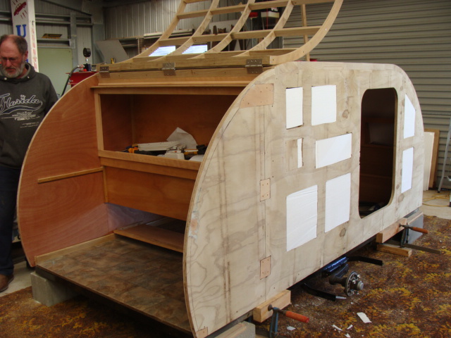

Day 66: 22 Sept. 2012.
Skinning the hatch.
Need lots and lots of clamps!
