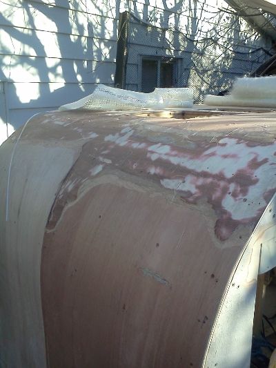

Like this bit...I ground away the damaged areas of the cracked skins today. The coring in these 3X7 plies was made up of veneer strips rather than sheets. That's not really a surprise since they're intended to be used on the flat (not too many curved doors around) but doesn't bode well for trying to bend it over an 18" radius. Sure enough, it was along these inner seams that each failure occurred. I would have been fine to run the second layer of skin horizontally as well, staggering the joints so they don't line up.
I sparked up the fiberglasser's favorite weapon: an angle grinder spinning a 24G sanding disc. It made short work of the bad spots and I kept going until I got back to a solid bond. This is what I ended up with and what I'll need to repair:
Rather than try to torture more of this cheap ply into that curve, I'll glass in a layer of mat, a layer of roving (coarse 90 deg cloth) and then the final layer of mat over everything. That will fill the space and that radius will be the strongest part of the trailer !

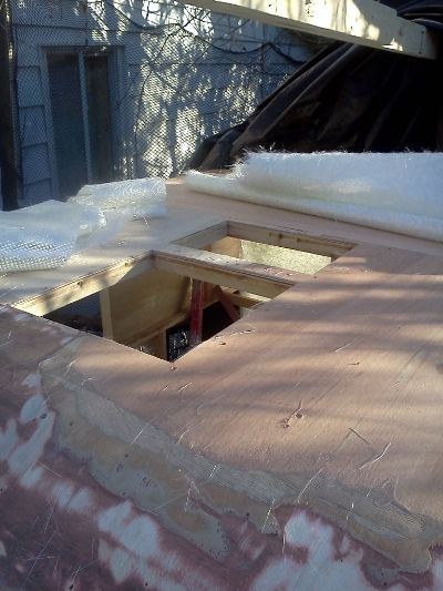

I also got the front window filler ready for its new sheathing of glass. I sanded it back to bare wood and feathered the edge back so I can lay in a strip of mat while I'm doing everything else. When I go around with a pallette of filler putty before the glass, that seam will get filled.
I also rounded the roof-to-wall corners for the glass to wrap over them and used the trim router to cut out the roof openings. The forward one is for a hatch and the rear one is for a fixed plastic skylight that will be raised up on a curb (just like a residential skylight). I plan to take a piece of 1/2" ply and cut out those openings to leave a ring frame that will be attached to the top of the roof. I'll round the outside corners and wrap the glass up and over it so any standing water has to be min 1/2" deep before the hatch or skylight seals are sitting in water. The front edge won't stick out past the front edge of the hatch's mounting flange but it will still need to be shimmed a little because it's right where the radius to the front wall begins.
These are the cutouts (hatch in front, skylight behind):
As you can see, I'm already started to cut the glass out - getting excited to start that part of it !!
