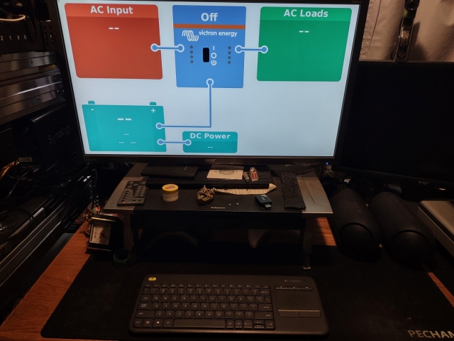

You guilt tripped me into getting the Cerbo GX out and doing the initial setup. Just for kicks I hooked it up to my PC monitor and a USB keyboard and it all works.
The Victron monitor is crazy expensive, its nice to know that I can use any hdmi monitor. BTW, I did the same thing with the Pi but you'll need to edit the Pi SD card. Here's how to do it:
https://github.com/victronenergy/venus/wiki/raspberrypi-install-venus-image
Here's the instruction on how to get to the SD card partition size:
https://www.victronenergy.com/live/ccgx:root_access

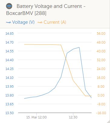

You can set up some nifty graphs in the advanced section of VRM. That's how I track the voltage versus current on my battery load tests:
Posts: 5495
