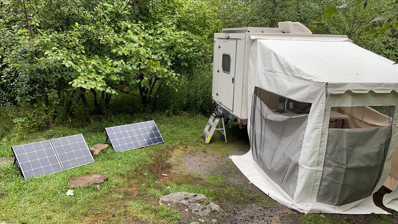

Sitting in the Jeep on the way to camp! Of course it’s raining! :rainy:
I wondered how the new solar panel was doing charging in the rain, and so I remembered the BMS and battery monitor both have bluetooth! The BMS had the strongest signal since it’s in the front of the trailer.
Not bad for a cloudy rainy day. The battery should be charged up to 100% by the time we reach our campsite. :D

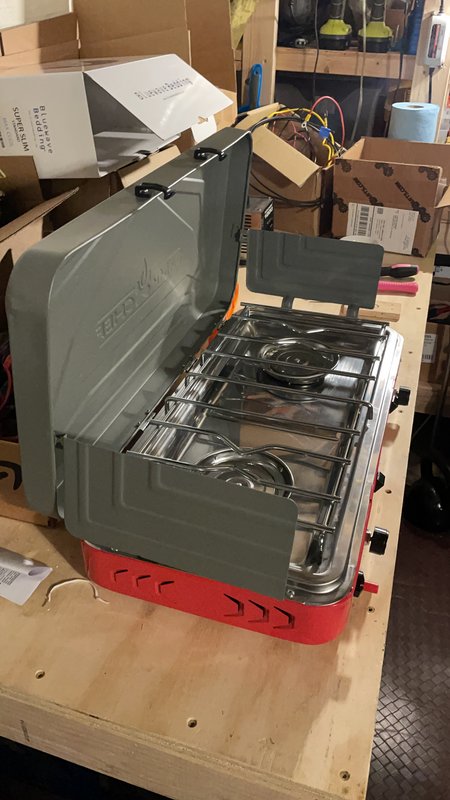

Our kitchen is on the passengers side of the trailer, under our Shademaker awning. In inclement weather, we can put sides on our awning room and run a Little Buddy heater to keep things warm in there. This fall, we decided to upgrade our stove. We had been running a Coleman 2 burner stove which we got almost 20 years ago as a wedding present. The stove served us well over the years, but it wasn't the fastest thing in the world. Now that we have a propane tank on the trailer itself, we have the potential to run a better stove. I was able to find this 20,000 BTU Camp Chef Everest stove online for cheap. It was new and never used, but dented. I did a little body work on it, and it is as good as new.
I bought a Buddy heater propane hose to connect it to the trailer's LPG tank. The Buddy brand propane hose does not have problems with oily residue developing inside, and so does not require an in-line filter. It keeps the stove burners running efficiently and clean.

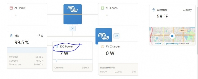

Make sure and turn on "has DC loads". it's under settings>system setup. The default is off and its the value I want to see the most in the main interface page:
