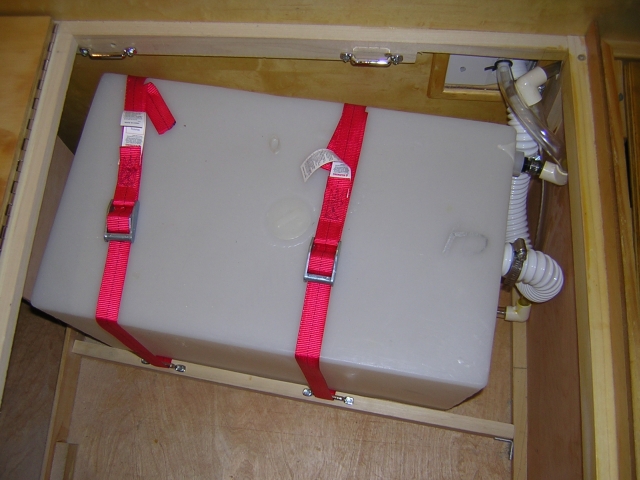

Postby S. Heisley » Sat Apr 30, 2011 12:06 pm
I would. The instructions that came with mine said to. It will definitely make the water flow easier, for filling, draining, and sink usage. Here's a picture of how I did mine. (Because I am using such a small space and the hose tended to crimp, I used CPVC elbow connections at the bends, glued with CPVC pipe glue. I used screw connectors on all but the air vent. It has the round black squeeze ring on it. The drain tube is mounted on the back end of the tank but you can't see it in this picture. There is a picture of that in my album.)
