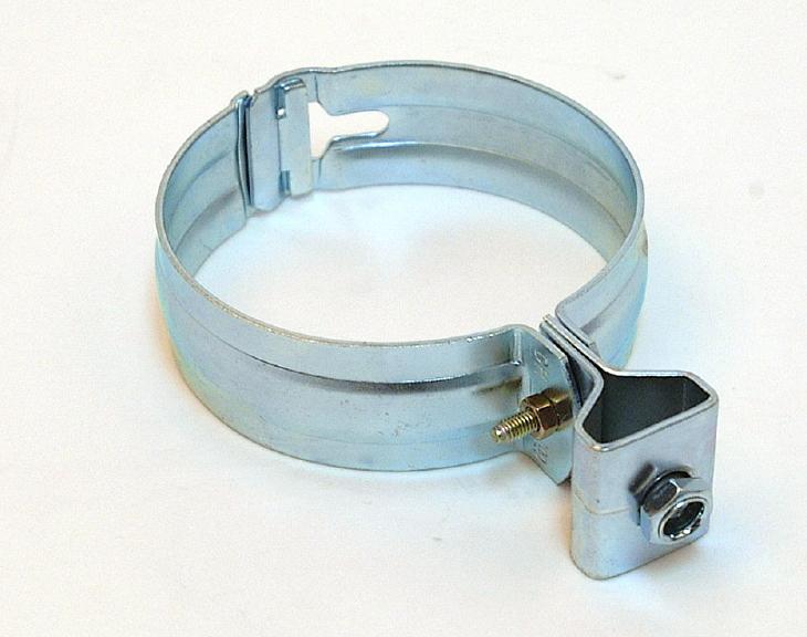

This is going to be my choice for pvc belly tanks. Drill a single hole and it's installed. I plan on being double nutted to keep the mounting nut from backing off. I also planned on some thin rubber wrap for the pvc to help with possible abrasion. These clamps are made in several diameters.
Just google "pipe hangers " images for several types of designs.

Thanks for the replies. I like those hangers Bob, but they are a little pricy and can't get the tank as close to the belly as the strapping. MJ, I had a no $#@% moment when you mentioned 1.5'' straping. I was thinking the skinny stuff thats rolled up when I saw the pic. I got a 5' piece of the heavy stuff today.

a big truck parts place(traction) will carry stainless steel muffler clamps that are designed to hold the heavy exhaust of a big truck in place while bouncing down the road. they look much like the clamps pictured earlier. patrick
