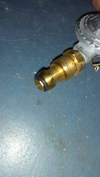

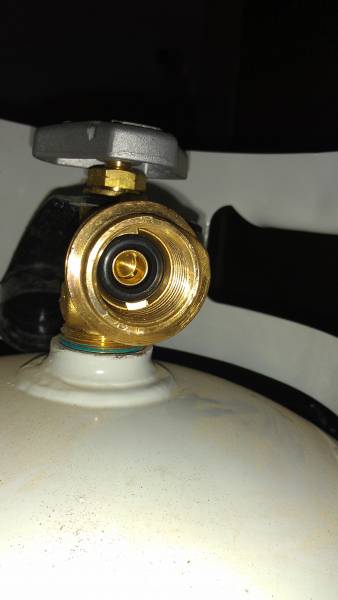

I wish I knew more about it, I'm not sure if it's single stage. I'm guessing it is because it looks pretty simple and it was only $15. We bought this stuff a while ago so I don't have the packaging anymore. Below are a couple close up pictures of the tank opening and the regulator fitting.

I missed this one the first time around. No, they didn't do that. I think I have the wrong fitting on the regulator. I think I need one of the green plastic ones, like this -
If that doesn't work I'll see if they need to purge the air out, because he just filled it right up.

The replacement connector you are referring to is probably not the solution (though I can not see it because image is blocked) .. You have the Industry standard POL connector (CGA 510) on your regulator now and it is the correct one....Its called the "soft nose" connector for POL... Only other version is a hard nose with out the "O" ring.... They come in two versions, one with with "excess flow" safety device and one with out... All small propane tanks either equipped with OPD valve or not use this connector... Even my 250 Gallon residential tank uses this connector (hard nose)...
About half way down page...
http://www.tejassmokers.com/products/brassfittings.htm
Hard nose version....
Soft nose version...
The outlet side of connector (male or female thread) is different according to style of device or hose you are connecting to...
IF you have anything other than setup like below, you probably have it wrong (only difference in this pic is regulator is connected to welding hose where you want connection to copper tubing)...
And why is "hex nut" portion of your connect so chewed on looking... You should use either open end wrench or adjustable (Cresent) end wrench... Yours looks like you used channel locks on it...

Last night I bought an acme nut and screwed it into the tank valve (OPD), turned the tank on, and propane came out. I think I now have the right fitting. But I haven't been successful getting the old POL fitting out of the regulator. It's really stuck in there.
Dale
Noted - and Thanks. :thumbsup:
