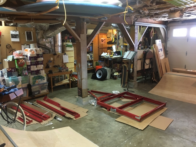

So, the garage is as tidy as it is ever likely to be, and I've begun assembling the HF trailer. I'm trying to decide whether to leave the factory fenders off or not.
I'm leaning toward leaving them off since even with them on, I'll still have to go to the trouble of boxing the wheels into the cabin structure since its width will be more than the wheel width of the trailer.
If you can think of any good reason to put the fenders on, please let me know. I'm going to finish the trailer tomorrow.
Nice to have the project take some tangible form!
