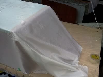

I picked up another 25 yds of glass cloth last week, so the Glacier is advancing again.
The last panel I did was just two straight, flat pieces of cloth. Now that I'm working on the corner, I figured I'd post up the sequence of shaping the cloth for anyone who's not sure how to do it. It's easy and is by no means the only way to skin the cat, this is just the way that works for me.
Never fear, I won't go into this much detail for every panel since the layup is the same for all of them.

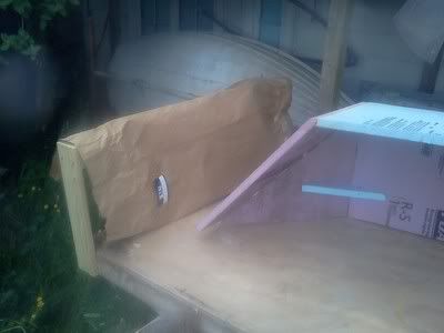

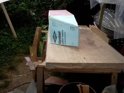

The first step is to cut out a 'bite' of the trailer to work on:
Now drag it downstairs to the table (as much as you can 'drag' something that weighs only 5 or 10 lbs):
And nope, the rowboat hasn't moved since the last post....and there are prawns to be had..... :D

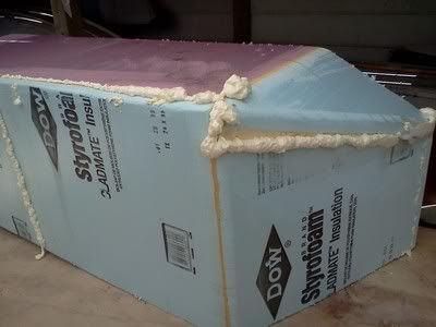

A bit of 'fairing-compound-in-a-can' to fill before final sanding:

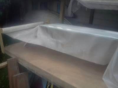

The next pics are milky this was where I wrapped my phone in Saran Wrap just in case there was a good time during the layup to take a pic (there never is). The table with the hanger up for the cloth:

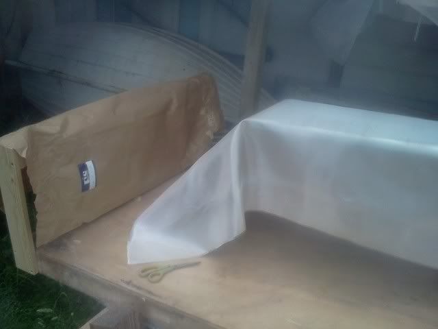

It's covered with paper because crap gets into the weave otherwise, especially if you're working outside.

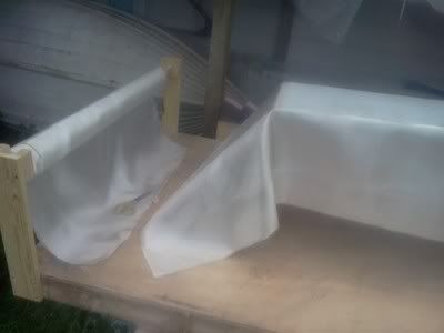

Cloth laid out for length:
Note the cheap disposable scissors - don't need pricy shears for 6 oz cloth. Razor knives (Olfa, etc) also work great when run along a straightedge....just not when you table is covered in plastic sheeting to ward off epoxy drips ! :
Get that cover back on the cloth !

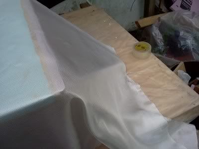

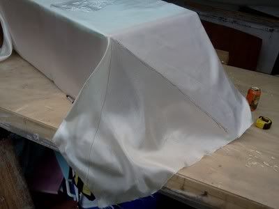

Gathering the excess cloth in the corner and checking that the bottom and far edges are squared to the foam. Oh, and giving up on the Saran Wrap, too.

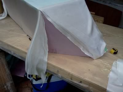

Laying out the dart to cut out of the corner. Grab the trusty Sharpie and run a line down the corner. Then fold the corner the other way to get the other line (on the bottom):
And wind up with the rough triangle you need to cut out.
I've left myself a bit of an overlap to ensure that the corner will have two thicknesses of cloth over it. The overlap decreases as you get to the end of the cut to keep the cloth from 'piling up' in the corner.
Taped into place. After smoothing the cloth towards the other end and making sure the weave is square, repeat the cut on the opposite corner.

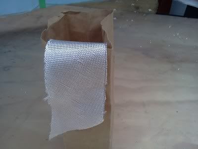

The leftovers will become tape. Cutting it into short strips will give me a way to use any leftover resin to add more glass to the corner.
And into a bag to keep it clean.
No mid-layup shots, but here's the result. Notice that the Sharpie marks show through.

On your cloth layout. I can appreciate the perfect cuts and folds and the tape... Is there anything you can put on the surface to prevent shifting as you are laying it out and cutting, like spraying water mist or an oil, that would bond with the epoxy once it gets added? I'd hate to have to let it dry even from a fine misting before I could actually epoxy. I was thinking though that a few straight pins here or there wouldn't hurt while laying it out and doing final tugging and shaping, even cutting... up until the actual spreading of the epoxy. Or until just after the epoxy is spread, pull the straight pins before it hardens.
LOL, and I had envisioned you out there with, like an "electric turkey knife" cutting up your build to epoxy it. Actually you can do the build with the idea that it will be dismantled in sections for the epoxy one phase, so that you aren't making cuts where there aren't already joints... or sections/modules, like that corner piece you just did.

Thx PcH. To answer your questions,
As far as the drain goes, that idea is what I'm doing as well. I've cut out the foam for the two sides of the bulkhead that close off the head. Under the toilet is a floor drain that ends in a 1-1/2" hose barb so I can run off the water away from camp. The trailer will be 'leveled' as slightly nose-down to drain. After a week of tramping mud in and out, I can also just hose 'er down and it'll run out the drain.
It's funny you mention the curtain track - I was thinking of the oval ones they sell for clawfoot bathtubs. Space bags are a good idea too.
For the floor, it will definitely smooth out the OSB. You've already got the sealer on so the epoxy won't soak in at all, but OSB ought to have more than enough texture for it to grab. When you mentioned 'leveling', it read like the floor had dips in it.
Straight pins work great for holding cloth as long as the cloth isn't hanging off them. I've been sanding the foam and sweeping off the dust right before I start cutting cloth. It gives the foam a clean, rough surface that seems to hold the cloth pretty well. I've heard hair spray works, but I wouldn't put anything on it and potentially compromise the layup. JMHO though.
And, nope: this time it was a hacksaw blade in a wooden handle :lol:

Postby PcHistorian » Sat Jun 16, 2012 10:48 pm
No, I don't mean the fiberglass cloth tape, I mean that green tape that is used to hold the cloth in place while you put the epoxy on.
You can't remove the green tape until at least some epoxy is on, and the cloth is held to the shell... you don't epoxy the green tape in...
