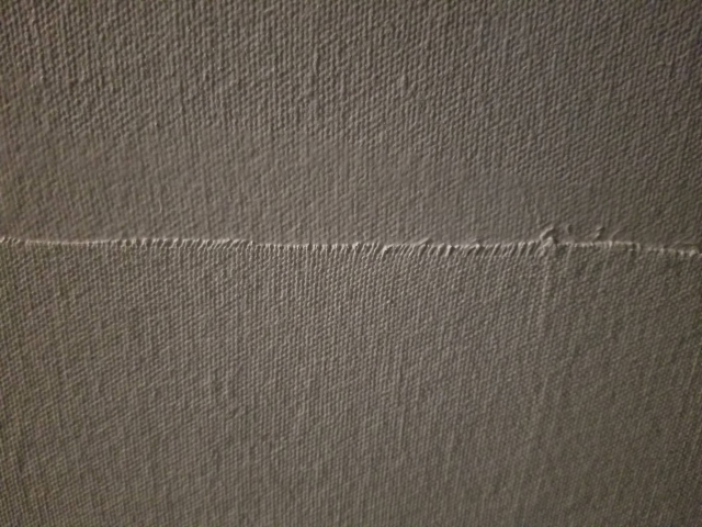

Here is a relatively close shot of an area:
If I went at this with a fingernail, I could clearly get an edge started. I'd rather that not really be an option. Any suggestions?

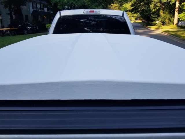

LOL. So Here is a better couple of shots on what I'm trying to do here.
Long view.
There are 3 pieces of canvas applied in this photo, one on each half of the lid, and a third 12 inch wide piece that is covering the joint in the middle. So this piece of canvas IS the cover for the seam.

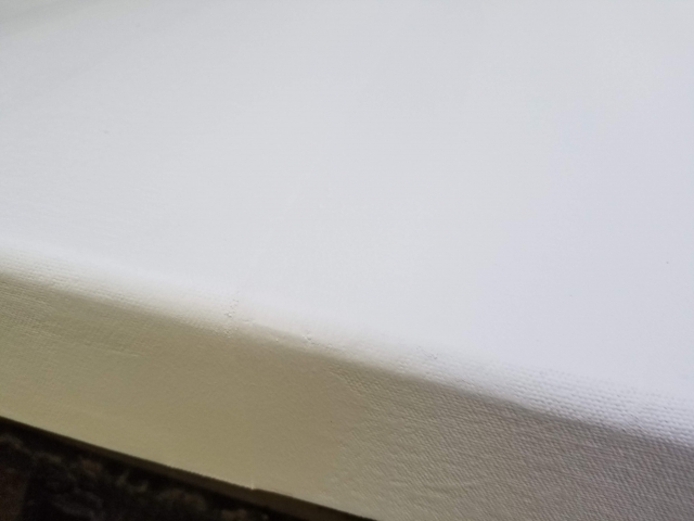

This is a closer view:
As for "Don't DO THAT!" If t'was just me, there would be no question. Alas, no matter how hard I try, I can not get my wife and children to understand that simply leaving a thing alone is possible.
I know how much work it was to get it on there, and how much it will take to fix it. THEY don't! I also would like to have as low a profile as possible for water intrusion.

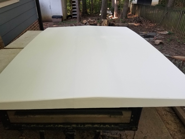

I sanded and then rolled a coat of GG over the center 20 inches or so - this is what it looks like now. My cell phone photography skills may be a bit lacking, in my defense it is hard to photograph an edge that is not supposed to be able to be seen.
Long view:

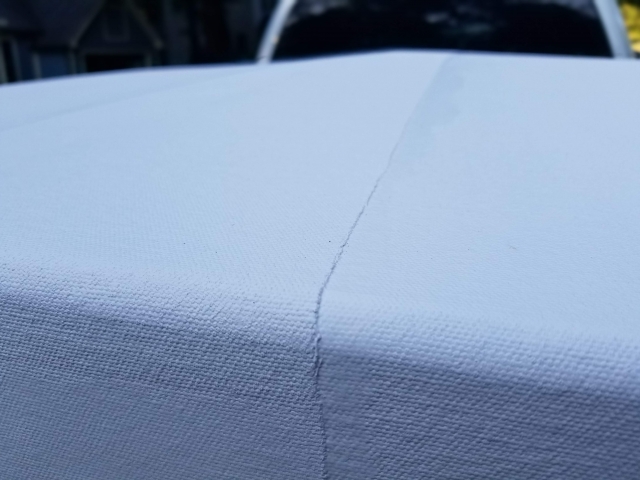

An attempt at a close up:
You can see where the seam is if you look at the bottom and follow the little "step" straight up.
