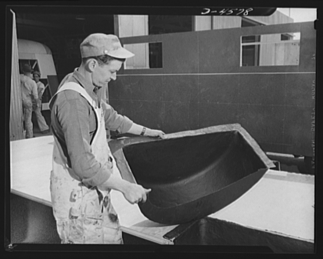

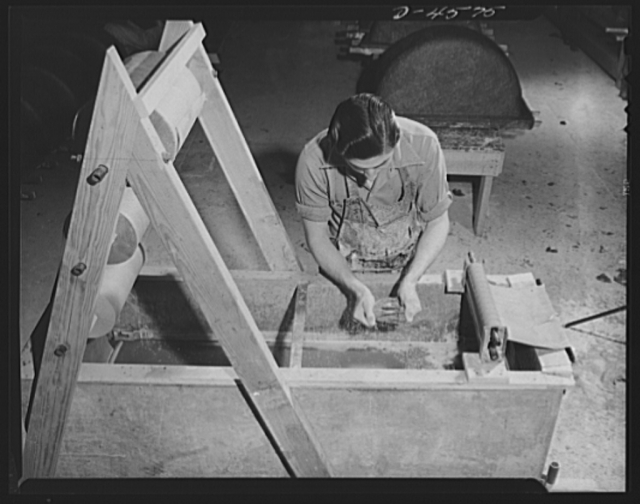

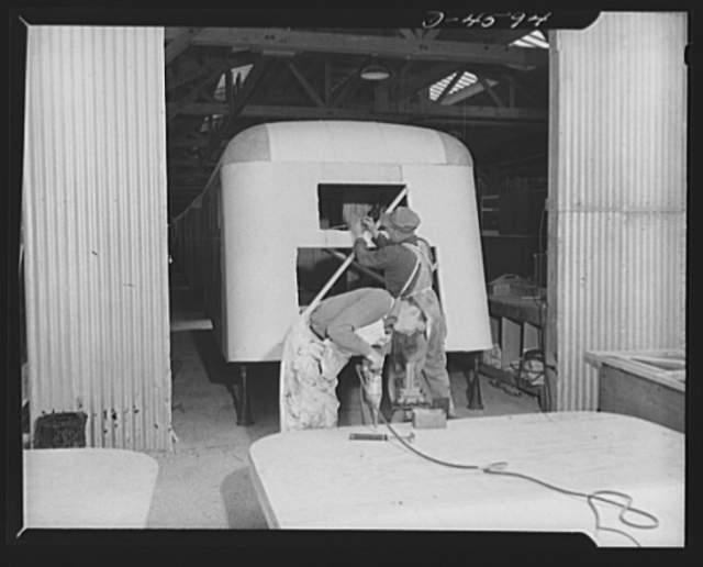

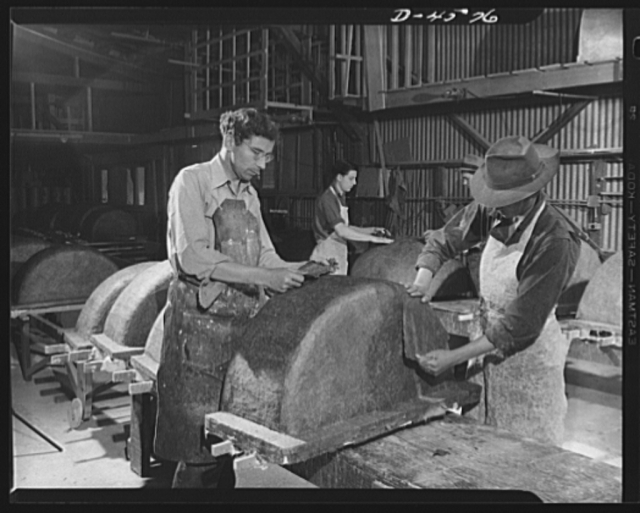

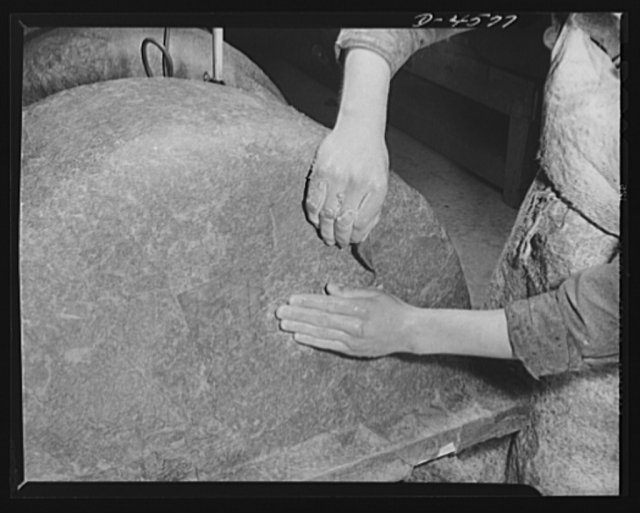

aggie79 wrote:This is from the Library of Congress. In WWII, Western Trailer Company made wartime trailer housing - essentially travel trailers - using molded paper components. From the LOC website:
tony.latham wrote:Alternative to canvass...
Somebody invented fiberglass last year. I have yet to see a peel test on it though.
Paper of forty pounds weight runs from rolls to a tent containing a glue-like solution.
The finished wells are covered with an asphaltic preservative paint."
