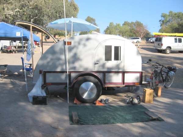

Build a teardrop "slid-in" unit that has a base that fits between your existing rails, and "wings" (like on a slide-in pickup camper) that extend out to the edge of either the trailer's side rails or the edge of the fender (they could also extend forward over the tongue a bit). I went looking for the example I saw at the first S.C.T.T. Sweetwater Gathering in 2000, but came up with this instead:
(picture courtesy of Gage!)
That way, you can slide it off whenever you need a utility-type trailer.
BTW, there have been a handful of teardrops that used bedliner material for the outer "skin", all with good results. I'm in the middle of a build right now that will have a combination ... Linex on the roof and just over the edges (as well as the leading edges of the fenders) with polished aluminum sides & deck lid. And yes, there is a weight penalty, but ...

Postby martha24 » Fri Oct 03, 2008 3:21 am
Here's a second tear of the sort Grant is talking about skinned in aluminum. It was taken at the SLO Gathering in CA a few weeks ago.
Good luck on your build whatever you choose to do. :thumbsup:
