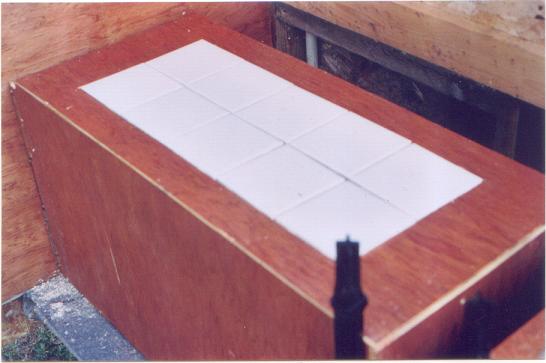

Postby bobhenry » Mon Mar 23, 2009 5:29 am
I inlayed ceramic tile. It's a great place to land a hot pan if needed.
I was concerned about using a cook top over just wood and ol what's her name made this suggestion. I put the tile down with heavy duty construction adheasive and used white rubberized silicone caulk for the joints. 2 years and no problems at all.
The Coleman stove is setting over the one above. In this pic you can see the 1/2 size one on the opposite counter also.

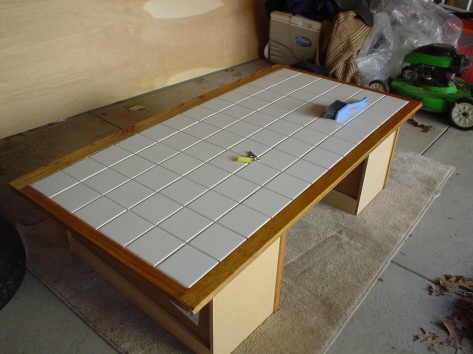

Postby Steve_Cox » Mon Mar 23, 2009 6:45 am
Teardrop was done in tile. Lots of positive comments by people that see it. Inexpensive, about $12 for the tile, compared to about $75 full sheet of laminate. Tile durability excellent, I put it down with construction adhesive and a flexible grout.

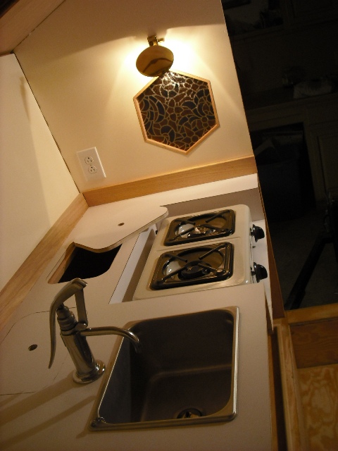

Gypsy trailer I used laminate. Wanted an excuse to play with the new router. Photo taken before cabinet face frames and doors installed.
