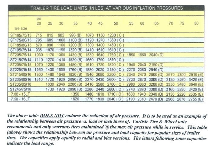

Postby angib » Tue Nov 08, 2005 7:17 am
Here is the load/pressure chart from Carlisle's web site:
It's a bit disappointing that, as they sell smaller trailer tires, they don't give any data for them.
It might be worth pointing out that the load above is load per tire - double it for load per pair.

Postby randy chesnutt » Tue Nov 08, 2005 8:24 pm
by having your trailer weight and go to the chart like andrew posted for your tires will tell you what the pressure should be. if you weight it make sure that it is loaded like it would be if you are going on a trip. you need to have each wheel weight . that way you will know if you are heavier on one side or the other. it's like my motorhome i had it weight. every wheel had it's on scale. when i got my weight on each wheel and i found out that i was about the same weight on both side which was good then i went to the tire chart and reset my tire pressure. you may think that it's just a small trailer but it doesn,t make a differrent. but it does. to much weight on one side can effect the pulling and puts alot of weight on that tire.
