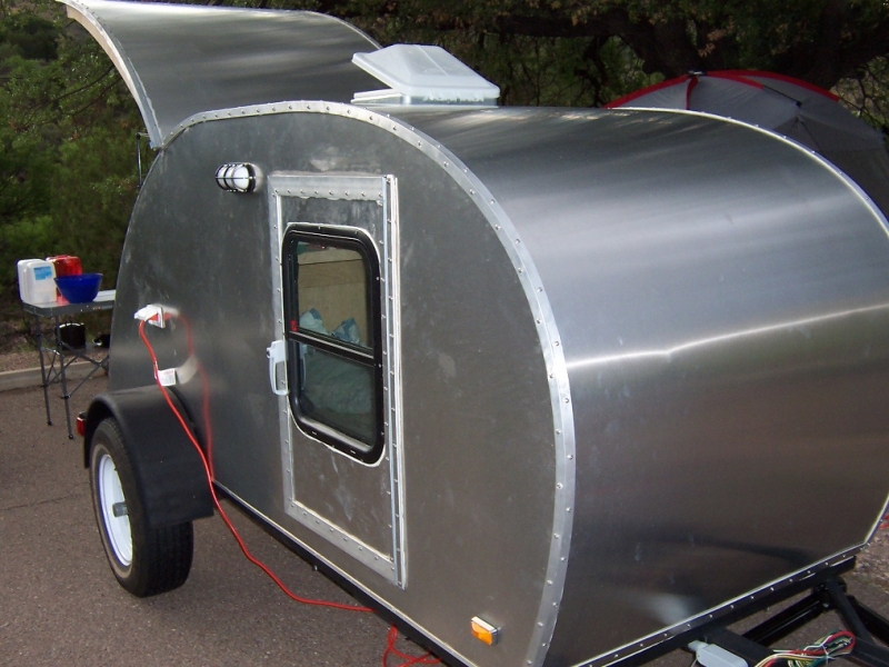

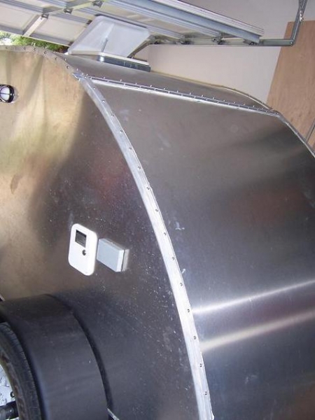

Mike - I too used Grant's moldings for my TD. Here are some pix if you find it helpful. The roof edge moulding was easy to bend and pound flat any tendencies to buckle around curves. The RV molding on the hat edge (affixed with pop rivets) was much heavier and stiffer but I could still bend and shape it carefully by hand.

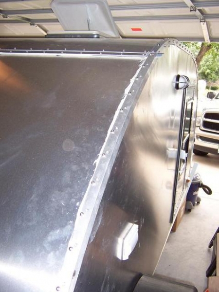

I skinned my TD with .032" 5052 Aluminum.
I used 6063 Aluminum Architectural Angle for all the trim.(Architectural extruded shapes have distinct, sharp corners; no radii.)
1/8 X 1 X 1 for the corner trim and 1/16 X 1/2 X 1/2 for everything else.
I like the way it looked but it was quite a pain.
Even though I annealed the aluminum it was very unruly to get it bent for my hatch.
I ended up with tennis elbow for a few months after having banged it into shape. :(
