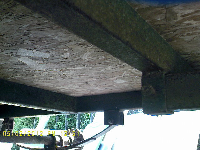

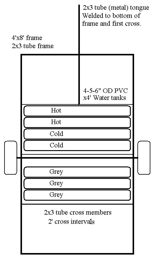

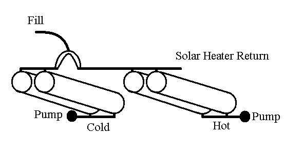

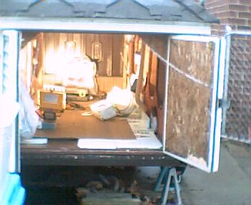

This is IT!!! I found you guys!!! Right topic. Ok, Trailer is built, came with particle (chip compressed) floor and nothing I could tell on the bottom. About 5/8" from the looks of it. I guess it was made in the 1980's. (I will get some under pictures up here today, if I can...) I have put on one layer of thompson's deck water seal, last year. (this was before I found you guys). Now this last winter it got cold and I threw some piece of 1/2 blue insulation on the floor and man that was a great help. But NOW I want to put that insulation, attached, underneath. So I want a good sealing of the wood, then stick up the insulation, probably short deck screws with disks to attach. I am going to do some other stuff under there like water tanks of PVC TUBES. But those I'll attach to the frame. What's a good way to seal and then stick the insul. up, just prior to the screws? At 5/8" I think it will be tight to screw for hold and not come through with the tip of the screw.... (that's be an owie) I do plan to lay carpet inside, after I'm done doing the work. while I'm doing the work to finish it, I'd hate to get stuck with screw tips. So maybe 1" screws and the disk will help for the final spacing? I had been considering just the spray can tar stuff to undercoat... (plus I need to go back through here and take notes... :-)
foam to transfer
current under
tanks to add
design
locations
I've gone through the thompsons water seal with paint brush underneath and some oil stain inside under the roof and I'm pretty much done with getting dripped on.

foam board adhesive should work fine, its 1 of the PL\s in a calking tube, it won't melt the foam then a tar emulsion to seal it up, especially where the foam joins the frame, you don't want to trap any water in there
