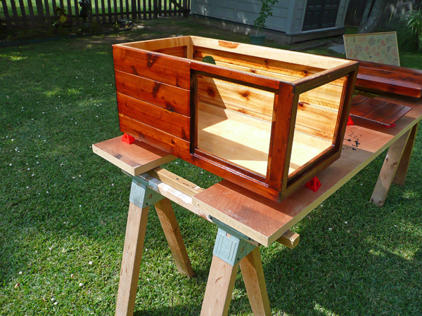

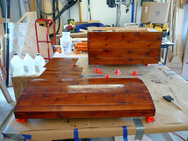

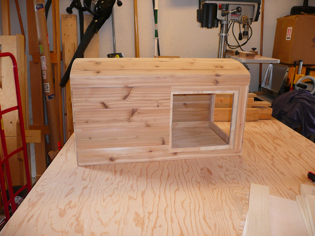

I used TransTint dyes on my tongue box. The wood is cedar.
I blended two colors of TransTint dyes to get the shade I wanted. I used a foam brush for applying the dyes and cotton rags to wipe off excess. It can be a little tricky maintaining consistent color, but one of the bonuses of using these is that you can "add" as well as "subtract" dye.
The cedar was weather-protected using 3 coats of epoxy.
After allowing for cure, I added 3 coats of Emtech EM9300 for UV protection.
Then I assembled the tongue box, installed the trim, and attached it to the teardrop.
My teardrop is stored indoors, but the color-fastness and weather-tightness have held up for 6-7 years.

Thanks. I used alcohol since it does not raise the grain of the wood.
